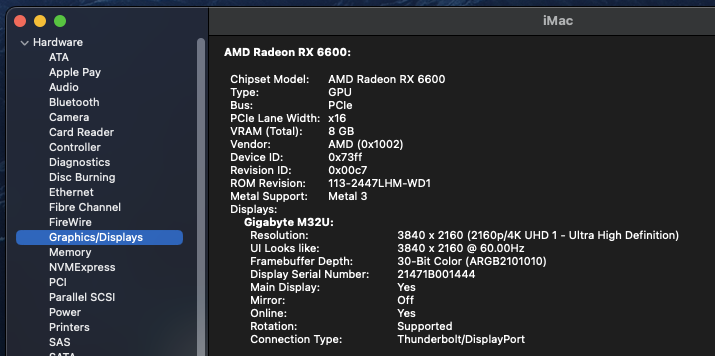

BALDY_MAN Posted September 7, 2022 Share Posted September 7, 2022 (edited) hi all I would be grateful if someone could help me get a Sapphire Pulse rx6600 gpu working in my Gigabyte Z97 hack. I'm using Venture 13.0 Beta (22A5331f) everything works with a rx580 pulse card but it was only a loan.. so I bought a Sapphire pulse rx6600 and I get no signal to the monitor from any of the ports I have tried adding the ATY,Henbury String to my config plist. and agdpmod=pikera to boot arg and updated WEG Kext and Lieu Kext with the latest open core 0.8.4 boot load so im a unsure what to do next Best regards Baldy Edited September 7, 2022 by BALDY_MAN Link to comment https://www.insanelymac.com/forum/topic/353316-could-someone-be-so-kind-and-look-at-my-efi-folder-amd-rx6600-no-display-solvedby-miliuco-with-a-p/ Share on other sites More sharing options...

BALDY_MAN Posted September 7, 2022 Author Share Posted September 7, 2022 @Mald0n. thanks for your help my friend. I have tried the EFI File I see the boot screen and vibes script scrolling then a black screen. and the monitor says no video signal. I have tried in all the ports. DP PORTS /HDMI and cleared v ram each time Link to comment https://www.insanelymac.com/forum/topic/353316-could-someone-be-so-kind-and-look-at-my-efi-folder-amd-rx6600-no-display-solvedby-miliuco-with-a-p/#findComment-2792587 Share on other sites More sharing options...
miliuco Posted September 7, 2022 Share Posted September 7, 2022 (edited) @BALDY_MAN You have agdmod=pikera instead of agdpmod=pikera in boot args. SMBIOS model? Edited September 7, 2022 by miliuco 2 1 Link to comment https://www.insanelymac.com/forum/topic/353316-could-someone-be-so-kind-and-look-at-my-efi-folder-amd-rx6600-no-display-solvedby-miliuco-with-a-p/#findComment-2792590 Share on other sites More sharing options...
BALDY_MAN Posted September 7, 2022 Author Share Posted September 7, 2022 29 minutes ago, miliuco said: @BALDY_MAN You have agdmod=pikera instead of agdpmod=pikera in boot args. SMBIOS model? @miliuco Thanks my friend I will change it and try.(I'm tired) and try it in a hour thanks again Link to comment https://www.insanelymac.com/forum/topic/353316-could-someone-be-so-kind-and-look-at-my-efi-folder-amd-rx6600-no-display-solvedby-miliuco-with-a-p/#findComment-2792598 Share on other sites More sharing options...
BALDY_MAN Posted September 7, 2022 Author Share Posted September 7, 2022 (edited) @miliuco Thank you very much you fixed it for me thank you. IT was the P that fixed it (I will all way make sure I have a P now Edited September 7, 2022 by BALDY_MAN 1 Link to comment https://www.insanelymac.com/forum/topic/353316-could-someone-be-so-kind-and-look-at-my-efi-folder-amd-rx6600-no-display-solvedby-miliuco-with-a-p/#findComment-2792600 Share on other sites More sharing options...
