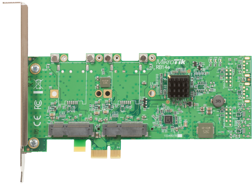

Spckyactnfrmadstnce Posted August 19, 2022 Share Posted August 19, 2022 Hi! I have recently installed big sur on my HP EliteDesk 800 g1 SFF with everything working except for wifi. To try to get wifi to run on this machine, I have gathered a BCM94321 Airport Card (from an early 2008 iMac), and a Mikrotik RB14e Mini PCIe to PCIe Card. The Opencore installation is iMac14,4. The Card combo works with wifi (without bluetooth) in Windows 10. In MacOS Big Sur, I am unsure if it's possible to use either card. I was hoping someone could answer a couple of questions for me?: - Is there a procedure for installing Mini PCIe to PCIe adapters in Opencore? (any kexts/drivers/plist entries to add?) It seems that I could have purchased a card not suitable for the task in the RB14e. - Is the BCM94321 possible to get running in Big Sur with kexts/plist changes? I've tried a few different methods to install the outdated card as I've seen a few success stories online (though I haven't seen any for the BCM94321). Thanks for any help. I'll attach my config.plist Mikrotik RB14e https://mikrotik.com/product/RB14e config.plist Link to comment https://www.insanelymac.com/forum/topic/353018-big-sur-wifi-bcm94321-mikrotik-rb14e-opencore/ Share on other sites More sharing options...
Spckyactnfrmadstnce Posted August 20, 2022 Author Share Posted August 20, 2022 (edited) Thank you very, very much for the comprehensive reply Hervé. It’s very much appreciated. I live in an area of the world where the local shops don’t stock such things, and they are generally very expensive when they do. It’s a long wait for anything overseas - this is why I went for this old PCIe to PCIe adapter. It was on sale for $40 (half price) I was going to rip the antenna out of the old iMac and use that. But I think the PCIe board will just be too much trouble to configure. (It’s designed for 3G/4G/Mobile cards I think, and asks for configuration in MacOS11). Anyways… I think I’ll buy an ‘Apple Wireless Card’ and a good PCIe adapter from the states. It’ll take a few months to get here but I’ll jerry rig something else for internet on the machine till then. I was hoping you might simplify things a bit for me and tell me a make/model of PCIe adapter that will work well? This will eliminate the chance that I’ll make the same mistake again. thanks again. Edited August 20, 2022 by Spckyactnfrmadstnce Link to comment https://www.insanelymac.com/forum/topic/353018-big-sur-wifi-bcm94321-mikrotik-rb14e-opencore/#findComment-2791715 Share on other sites More sharing options...
