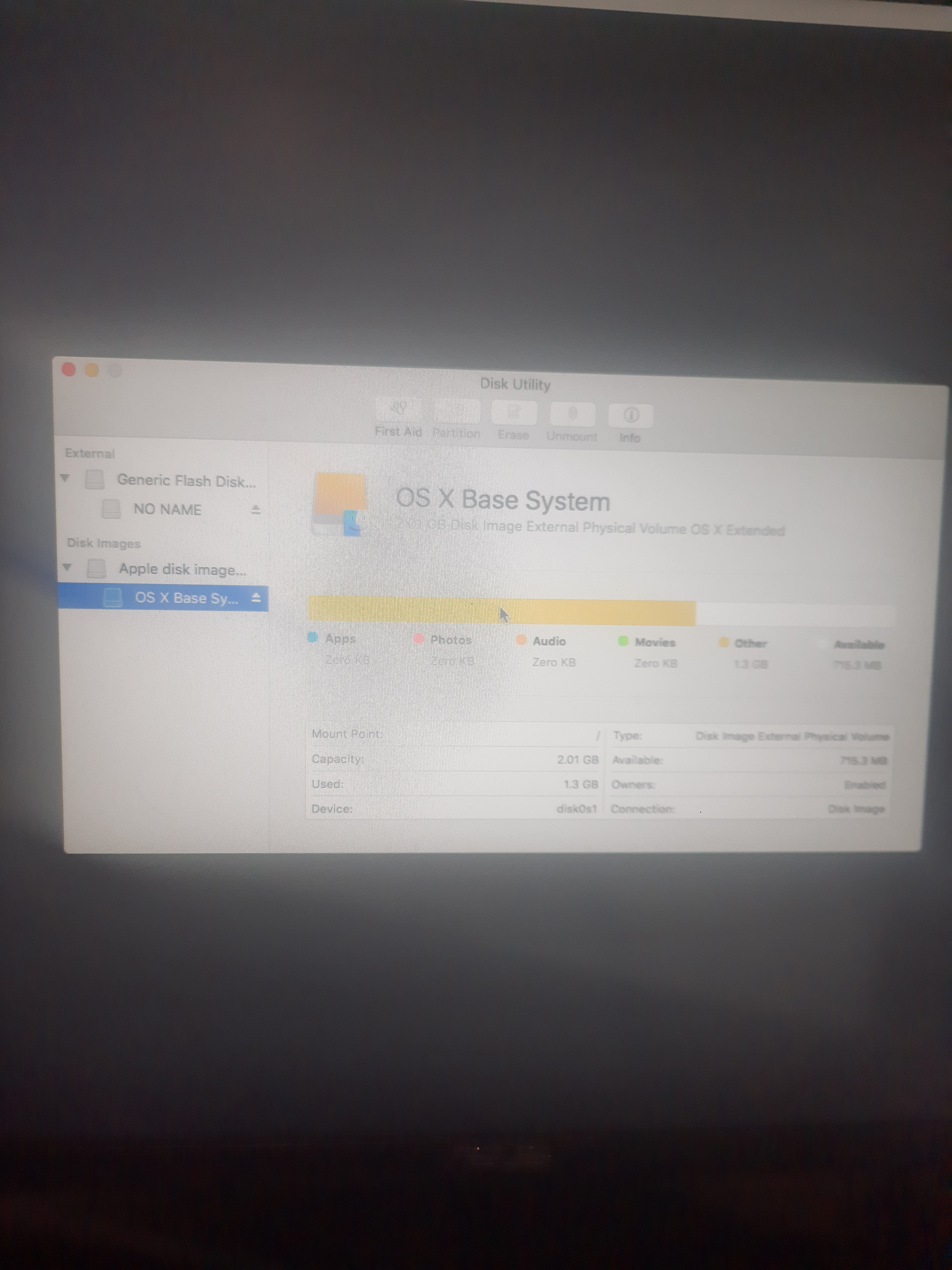

Slice Posted June 27, 2022 Share Posted June 27, 2022 Make a photo what do you see in DiskUtility in Recovery. Link to comment https://www.insanelymac.com/forum/topic/352409-macos-recovery-does-not-see-the-hard-drive/#findComment-2787374 Share on other sites More sharing options...
few Posted June 27, 2022 Author Share Posted June 27, 2022 1 hour ago, Slice said: Make a photo what do you see in DiskUtility in Recovery. Link to comment https://www.insanelymac.com/forum/topic/352409-macos-recovery-does-not-see-the-hard-drive/#findComment-2787377 Share on other sites More sharing options...
Slice Posted June 27, 2022 Share Posted June 27, 2022 What settings are in BIOS concerning SATA? Link to comment https://www.insanelymac.com/forum/topic/352409-macos-recovery-does-not-see-the-hard-drive/#findComment-2787379 Share on other sites More sharing options...
few Posted June 27, 2022 Author Share Posted June 27, 2022 Just now, Slice said: What settings are in BIOS concerning SATA? Only IDE Configuration and specific SATA cables. Link to comment https://www.insanelymac.com/forum/topic/352409-macos-recovery-does-not-see-the-hard-drive/#findComment-2787383 Share on other sites More sharing options...
