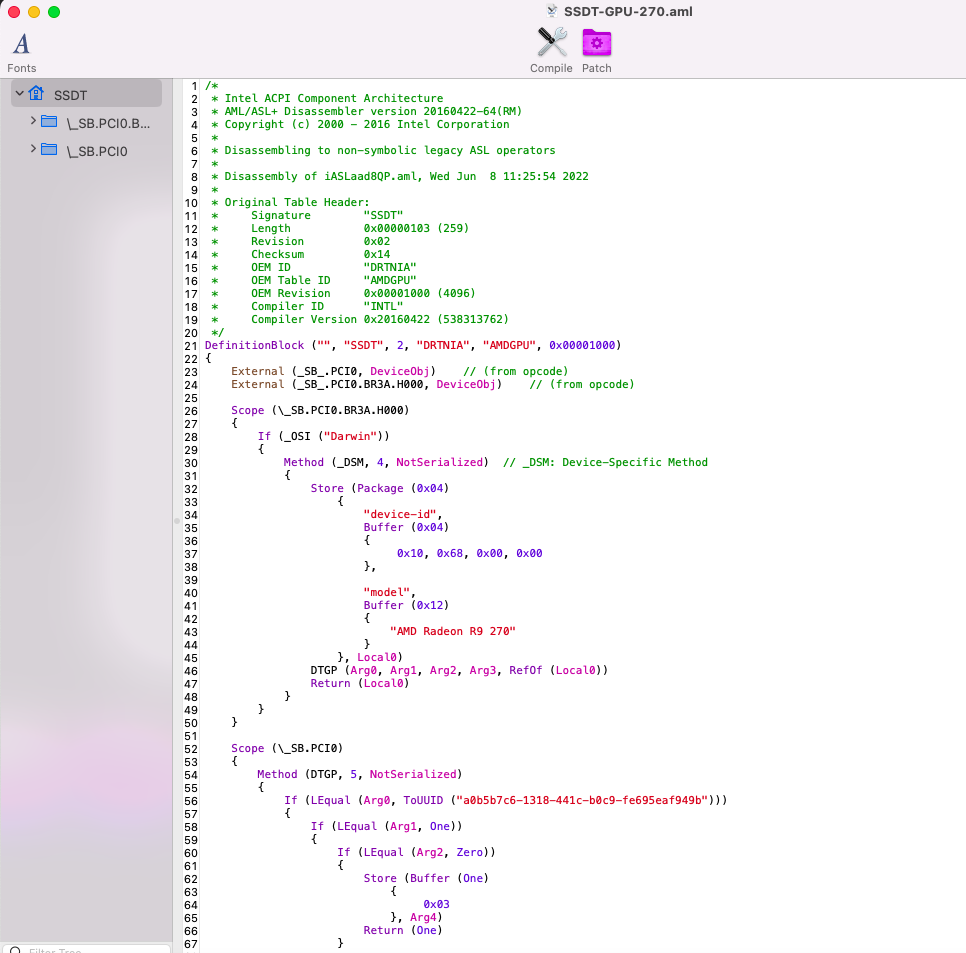

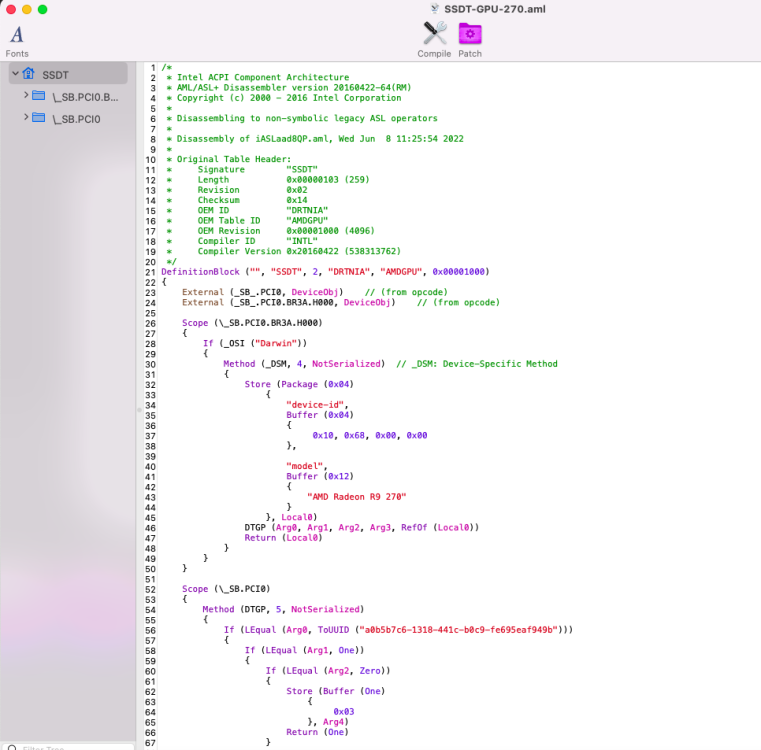

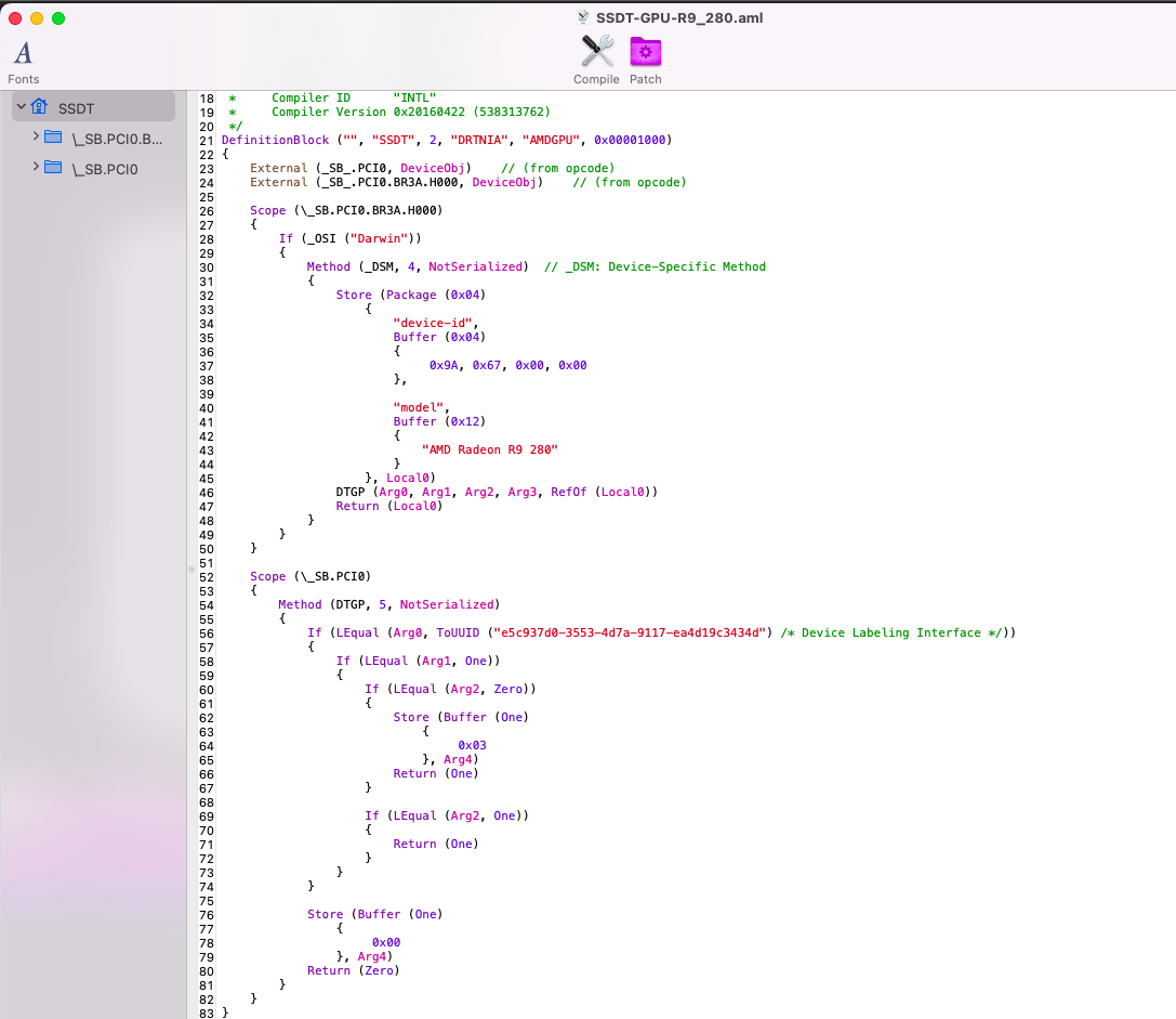

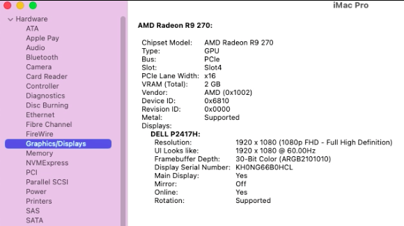

ltooz_audis Posted June 8, 2022 Share Posted June 8, 2022 (edited) The new Monterey doesn't support my GTX 760 on my Broadwell-E GA-X99 UD5 system. I had to use the Sapphire AMD R9 270 (10026811) and R9 280 (1002679A). The R9 280 spoofing was easy, but the R9 270 must be used with only WhateverGreen.kext version 1.5.1 for it to work. Regardless of how I got both of these to work, they still freeze at high resolution games and videos. Using it normally they're ok. The best is to use Heaven, it would freeze if use setting medium or high. If someone knows how to fix the freezing problem please let me know. I think the Sapphire is the culprit. Power supply is 750W Thermal Take. - R9 270 must use 10026810 for R9 270X and WhateverGreen.kext 1.5.1. - R9 280 use 1002679a and any kext would work. - Device properties must not have due to AppleKeyStore: error looping forever. Cheers, Louis r9_270_280.zip Edited June 8, 2022 by ltooz_audis 1 Link to comment https://www.insanelymac.com/forum/topic/352018-ssdt-gpu-spoof-r9-270-280-on-big-sur-and-monterey/ Share on other sites More sharing options...
