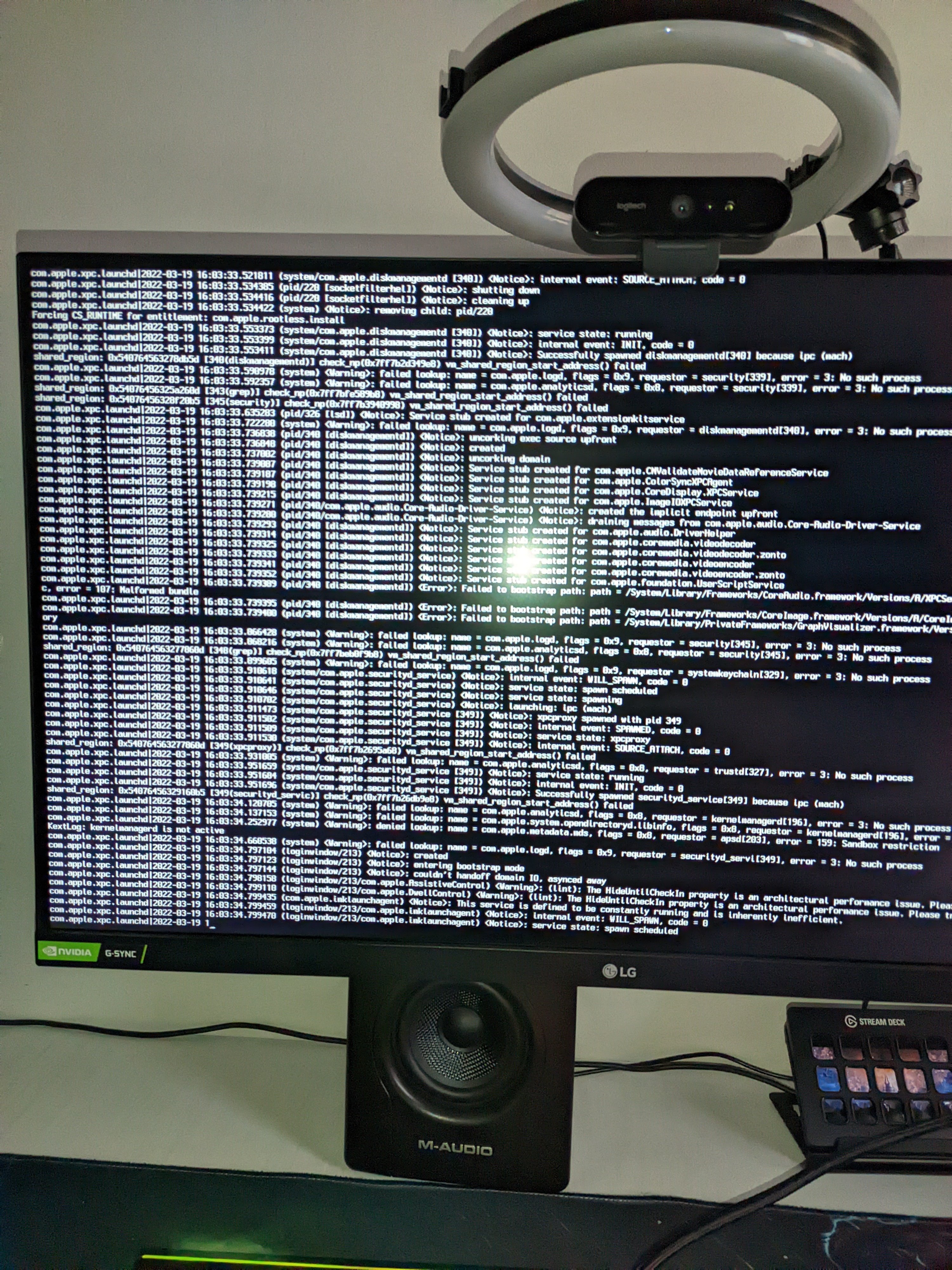

ciggar Posted March 12, 2022 Share Posted March 12, 2022 Y folow dortania guide Pc specs Asus wsc621e sage mobo 2 cpu 4210 silver 96 gb ram samsung ecc registred 2400 ddr4 1pcie ssd wdblack 1tb,1ssd nvme m2 1tb , 1ssd 250 sata And stuck on this look photo PXL_20220312_121448696.dng Link to comment https://www.insanelymac.com/forum/topic/351074-asus-ws-c621e-sage/ Share on other sites More sharing options...

Ellybz Posted March 12, 2022 Share Posted March 12, 2022 (edited) @ciggar Several things.. You have a difficult board to hackintosh ( with 2 CPUs ) but it should be feasible. In your config.plist you'll need the quirk EnableWriteUnprotector instead of RebuildAppleMemory or SyncRuntimePermissions. The "stuck" message posted on you boot log is not related to MSR/CFGlock. it can be related to your GPU ( which you have not stated in your specs! ) My wild guess :Try disabling the "Above4G" quirk in your bios. Most guides are telling your to enabled it, but depending on your GPU, you could get stuck exactly at this point. Here's a list you'll need to unlock MSR/CFG. Use UEFIPatch. The one i attached might be a bit old but still works. You will also probably need a SSDT for your CPU wrapping. Look for it in posts from @metacollin Best of luck. https://github.com/LongSoft/UEFITool/releases patches.txt UEFIPatch_0.28.0_mac.zip Edited March 12, 2022 by Ellybz Link to comment https://www.insanelymac.com/forum/topic/351074-asus-ws-c621e-sage/#findComment-2778145 Share on other sites More sharing options...
etorix Posted March 12, 2022 Share Posted March 12, 2022 Hello @Cigar! Please remove your serial number before posting EFI or config.plist. (Since your serial is now in the wild, make a new one and keep it private.) Being stuck after ACPI loading is a tell-tale sign you need CPU wrapping. With such boards I advise to first dump the ACPI tables, study them and make custom SSDTs rather than jumping on the standard SSDTs and trying to boot. This is best done using the debug version of OpenCore. (You're using 0.7.9, right?) Quirk AppleXcpmExtraMsrs is required. Do not patch the BIOS as the first intent: It may cause issues. But switching BIOS should be easy if you have the BMC version of the board. Boot-arg npci=0x2000 is almost certainly required with a Xeon Scalable. The port limit quirk is incompatible with USBInjectAll, and does not work with Big Sur 11.3 and later. I have made these changes, as well as EnableWriteUnprotector as suggested by @Ellybz and which I also tend to favour, and actually added RestrictEvents. Please try the attached EFI (OC debug 0.7.9) and post the SysReport folder and OpenCore log, as well as any relevant screenshot of the verbose boot—but please convert them to JPEG at reasonable size, we only need to read the text. A full description of your hardware and knowing which version of macOS you're trying to install would help us help you. I assume that the GPU is Navi or Big Navi (agdpmod=pikera). NvmeFix is actually incompatible with some SSDs. EFI.zip 1 Link to comment https://www.insanelymac.com/forum/topic/351074-asus-ws-c621e-sage/#findComment-2778154 Share on other sites More sharing options...

etorix Posted March 19, 2022 Share Posted March 19, 2022 Well, you already made good progress! And what a lovely sight in the log: Too many quirks! 121:243 00:054 OCABC: All slides are usable! You can disable ProvideCustomSlide! It looks pretty much like my Gigabyte C621-SU8, so I'd try the same settings: All booter quirks off but EnableWriteUnprotector! The only thing that annoys me is the brutal halt in the middle of a debug message: Exactly what npci=0x2000 is supposed to prevent. Maybe we need to raise one level to npci=0x3000… Please try this EFI (0.7.9 release). Adjusted quirks and a complete set of custom SSDTs. If it still doesn't work, you may try with different versions of macOS (I first succeeded with Big Sur while Mojave and Catalina still failed) and/or try booting from a drive on which macOS is already installed (the boot EFI may still be on a USB stick). EFI-rel.zip 1 Link to comment https://www.insanelymac.com/forum/topic/351074-asus-ws-c621e-sage/#findComment-2778600 Share on other sites More sharing options...

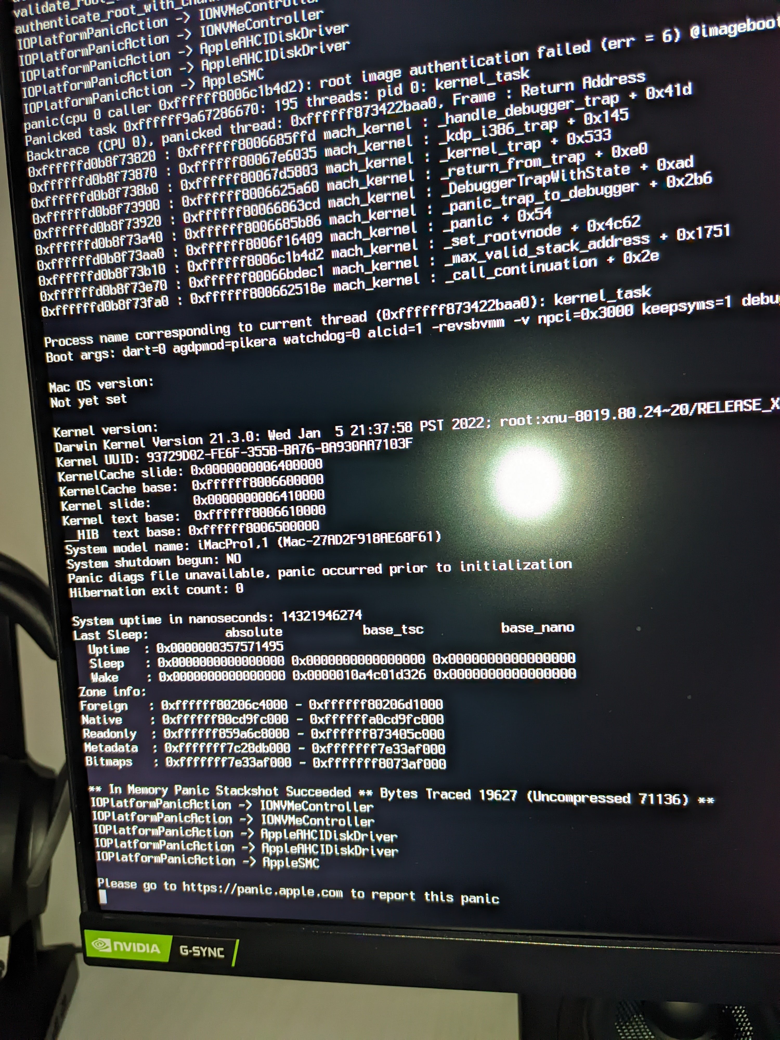

ciggar Posted March 20, 2022 Author Share Posted March 20, 2022 now y make a virtual machine on my pc instal macosbigsur y downloaded macos monterey y make a clean usb instalation y mount efi partion y put yor efi and now y get this look at picture!!!!???? y atach efi too!!!! EFI.7z Link to comment https://www.insanelymac.com/forum/topic/351074-asus-ws-c621e-sage/#findComment-2778650 Share on other sites More sharing options...
etorix Posted March 21, 2022 Share Posted March 21, 2022 IONVMeControler points to an issue with a SSD. Unsupported model? Or NVMeFix? I have no experience with virtualisation, but I suppose that this may require less kexts, and less or different SSDTs, because the actual hardware is handled by the hypervisor which then presents and abstraction to macOS. Link to comment https://www.insanelymac.com/forum/topic/351074-asus-ws-c621e-sage/#findComment-2778708 Share on other sites More sharing options...
ciggar Posted March 21, 2022 Author Share Posted March 21, 2022 Y have a pny 500gb m2 nvme. 1tb wdblack pciex8 rgb and ocz 240 sata ssd ....what kext to use or what ssdts???? Link to comment https://www.insanelymac.com/forum/topic/351074-asus-ws-c621e-sage/#findComment-2778714 Share on other sites More sharing options...
etorix Posted March 21, 2022 Share Posted March 21, 2022 SATA drives are always fine without any kext. In general most (consumer) NVMe SSDs should benefit from NVMeFix.kext, but it is not required. Some (data centre) SSDs are actually incompatible with NVMeFix. So it is always possible to omit NVMeFix, and then try to add it later. Link to comment https://www.insanelymac.com/forum/topic/351074-asus-ws-c621e-sage/#findComment-2778715 Share on other sites More sharing options...

ciggar Posted March 22, 2022 Author Share Posted March 22, 2022 Omg now work y put out al ssd and usb2 internal hub and work....why internal hub usb2 panic???? 2 Link to comment https://www.insanelymac.com/forum/topic/351074-asus-ws-c621e-sage/#findComment-2778784 Share on other sites More sharing options...
ciggar Posted March 22, 2022 Author Share Posted March 22, 2022 Man the problem is the ssd pcie wdblack nvme ssd raid aic and the usb2 hub internal ....the macos no suport nvme ssd raid aic??? Link to comment https://www.insanelymac.com/forum/topic/351074-asus-ws-c621e-sage/#findComment-2778787 Share on other sites More sharing options...
etorix Posted March 22, 2022 Share Posted March 22, 2022 USB can cause issues as long as there is no proper map. What is "nvme ssd raid aic"? Link to comment https://www.insanelymac.com/forum/topic/351074-asus-ws-c621e-sage/#findComment-2778790 Share on other sites More sharing options...

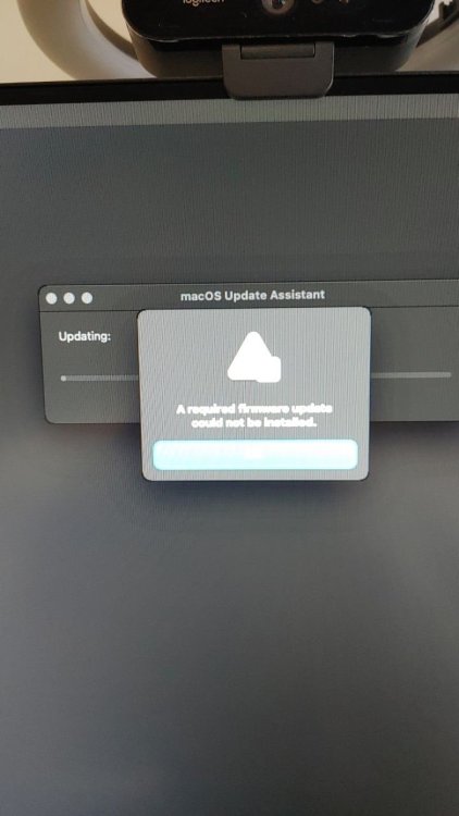

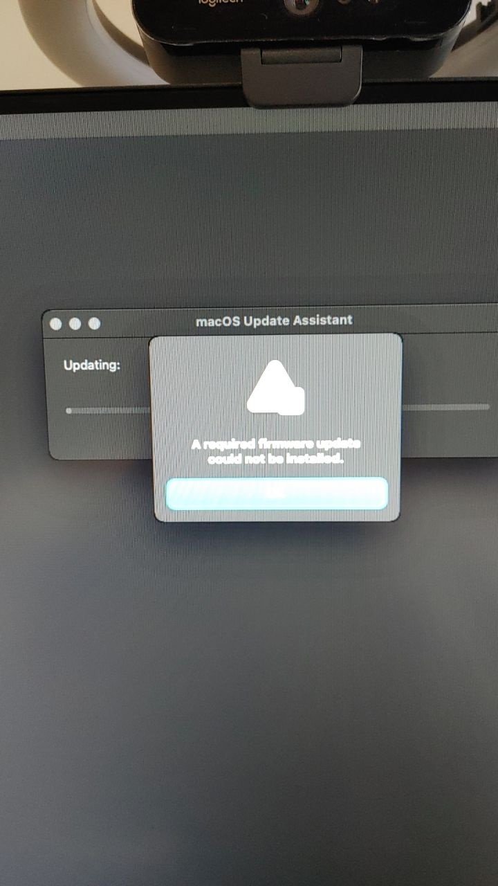

ciggar Posted March 22, 2022 Author Share Posted March 22, 2022 https://www.tomshardware.com/reviews/wd-black-an1500-nvme-aic-ssd-review this is the ssd nvme that cause panic!!!! but now y get this when pc continue to instalation Link to comment https://www.insanelymac.com/forum/topic/351074-asus-ws-c621e-sage/#findComment-2778792 Share on other sites More sharing options...
etorix Posted March 23, 2022 Share Posted March 23, 2022 I thought "WD Black" was a regular (and fine) SN750/SN850… Obviously the Marvell hardware RAID controller is not supported under macOS. Firmware updates are controlled by Misc>Security>BlacklistAppleUpdate:True NVRAM>7C436110-AB2A-4BBB-A880-FE41995C9F82>run-efi-updater:No If both are set correctly, I don't know what's happening. Can the message be dismissed? Link to comment https://www.insanelymac.com/forum/topic/351074-asus-ws-c621e-sage/#findComment-2778838 Share on other sites More sharing options...
Slice Posted March 23, 2022 Share Posted March 23, 2022 17 hours ago, ciggar said: https://www.tomshardware.com/reviews/wd-black-an1500-nvme-aic-ssd-review this is the ssd nvme that cause panic!!!! but now y get this when pc continue to instalation It usually means some SMBIOS data is not correct. 1 Link to comment https://www.insanelymac.com/forum/topic/351074-asus-ws-c621e-sage/#findComment-2778849 Share on other sites More sharing options...
ciggar Posted March 23, 2022 Author Share Posted March 23, 2022 cant dismis the mesage only restar or shut down y put macpro1.1 and macpro7.1 but not work y generate a new smbios and nothing on config y have Misc>Security>BlacklistAppleUpdate:True NVRAM>7C436110-AB2A-4BBB-A880-FE41995C9F82>run-efi-updater:No now what is the problem???? Link to comment https://www.insanelymac.com/forum/topic/351074-asus-ws-c621e-sage/#findComment-2778855 Share on other sites More sharing options...
Slice Posted March 24, 2022 Share Posted March 24, 2022 May be ExtendedFirmwareFeatures? Link to comment https://www.insanelymac.com/forum/topic/351074-asus-ws-c621e-sage/#findComment-2778884 Share on other sites More sharing options...
