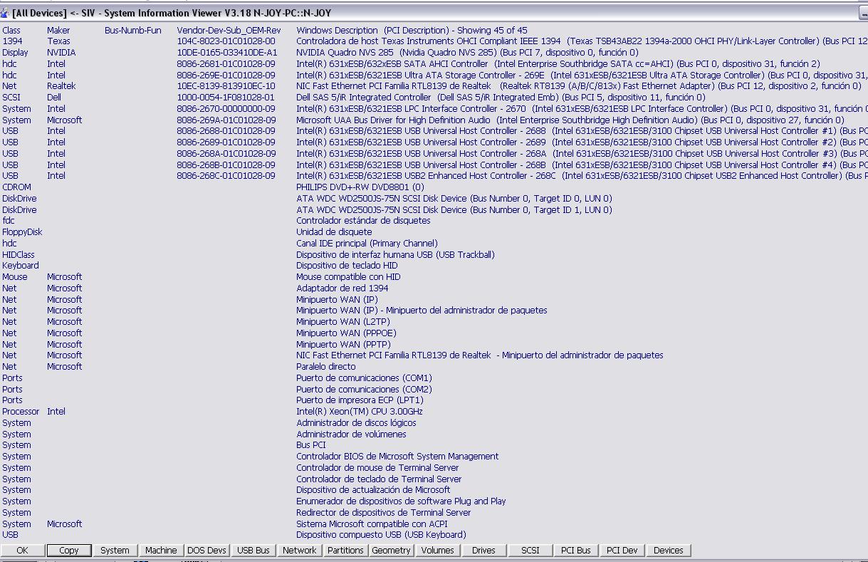

N-JOY Posted December 5, 2006 Share Posted December 5, 2006 Hi I¨ve being traying to install OSx14.4.4,OSx14.4.6 and OSx14.4.8 but my hard drives do not apear during the instalation and in the bios neither.They are ATA but goes into contoller. Any idea,Thanks a lot here is my devices sistem information: Link to comment https://www.insanelymac.com/forum/topic/35015-hd-problem/ Share on other sites More sharing options...

N-JOY Posted December 5, 2006 Author Share Posted December 5, 2006 The Hard drives are no on board,they´re conented to a contrller LSI 1068 SAS/SATA 3.0Gb/s and the OSX do not detect them.Normaly I´ve got no problems with Microsoft or Linux.Please,any ideas??? Thanks Link to comment https://www.insanelymac.com/forum/topic/35015-hd-problem/#findComment-248765 Share on other sites More sharing options...
Rammjet Posted December 5, 2006 Share Posted December 5, 2006 I'm pretty sure OSX doesn't support that controller. Do you have a different controller on the mainboard that can handle IDE/ATA/PATA drives instead of SATA drives? Link to comment https://www.insanelymac.com/forum/topic/35015-hd-problem/#findComment-248771 Share on other sites More sharing options...
N-JOY Posted December 5, 2006 Author Share Posted December 5, 2006 Rammjet ,thank you for your suport.Im afraid that it will be unsoported.I dont have any other controller.If someone knows anything please post it. Thanks again Link to comment https://www.insanelymac.com/forum/topic/35015-hd-problem/#findComment-248788 Share on other sites More sharing options...
