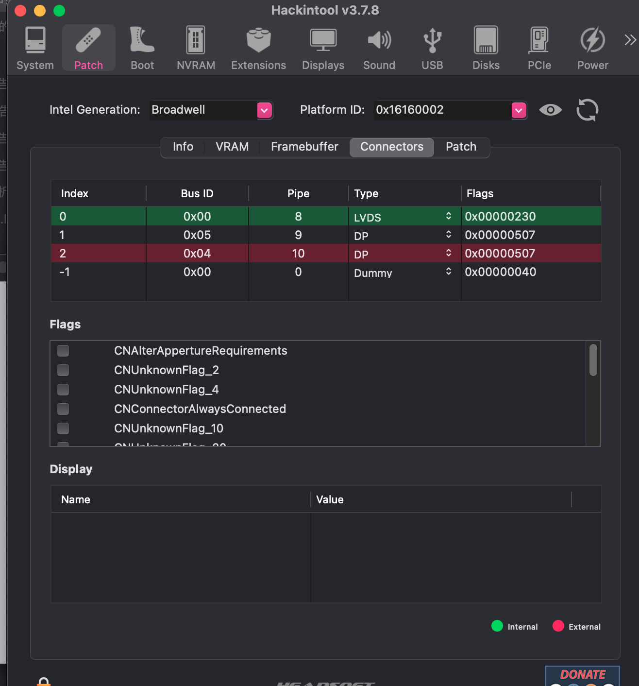

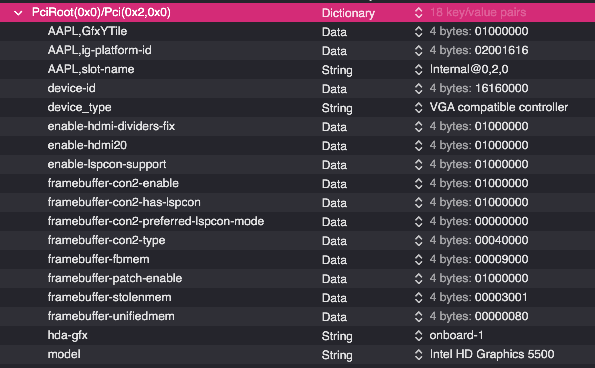

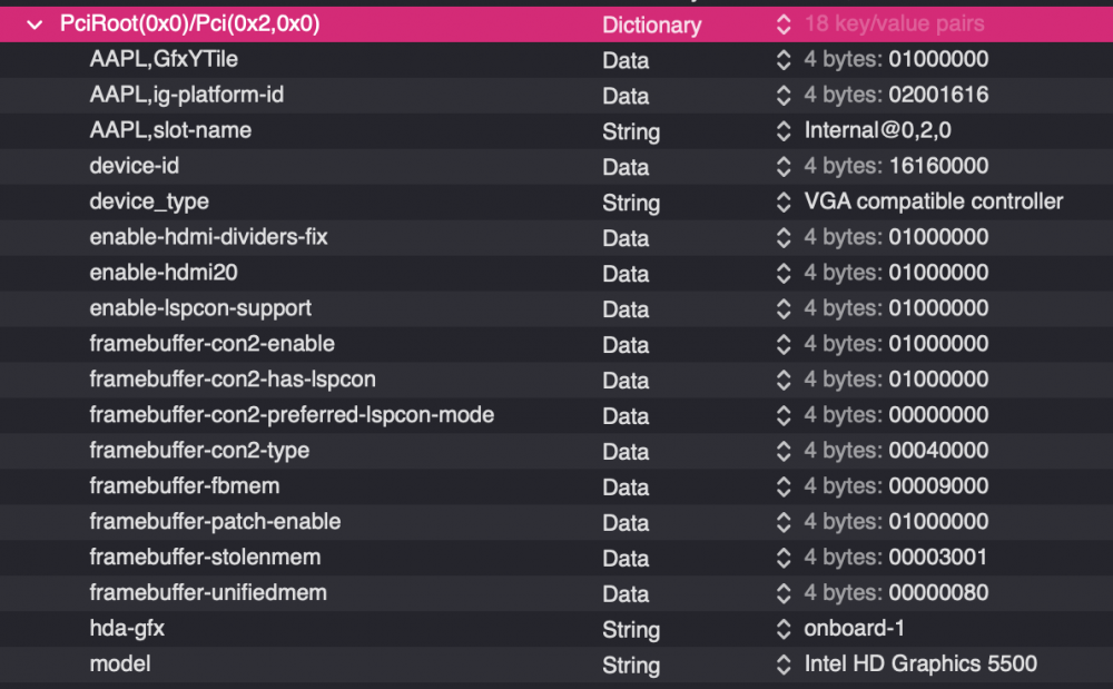

This is the config of device properties.image.thumb.png.c72385226b3eea66afa02f897d20e579.png

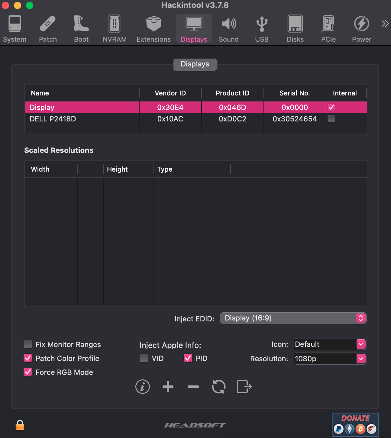

Here is some screenshots from hackintools.

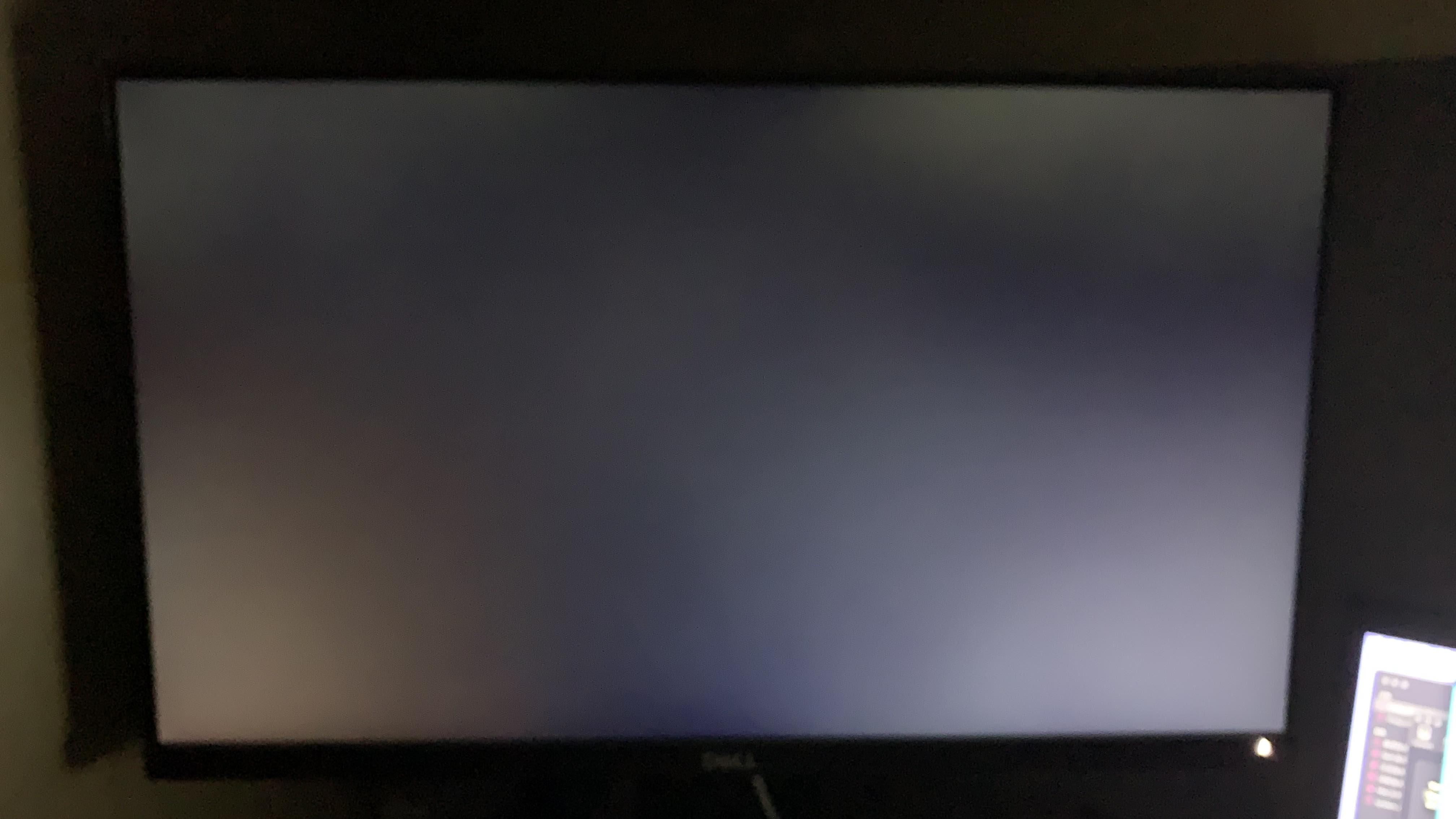

Here is some photos of the "black screen".
As you can see, it is not really black like do not plug in charge, it has the back lights.
