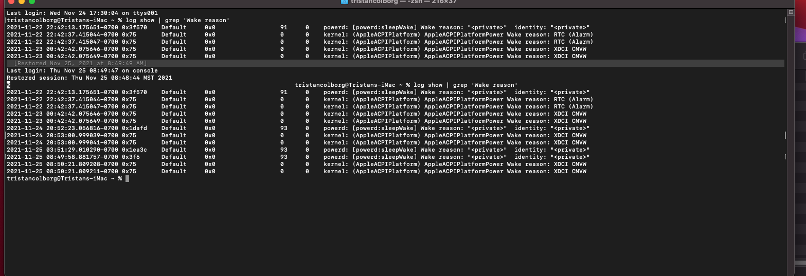

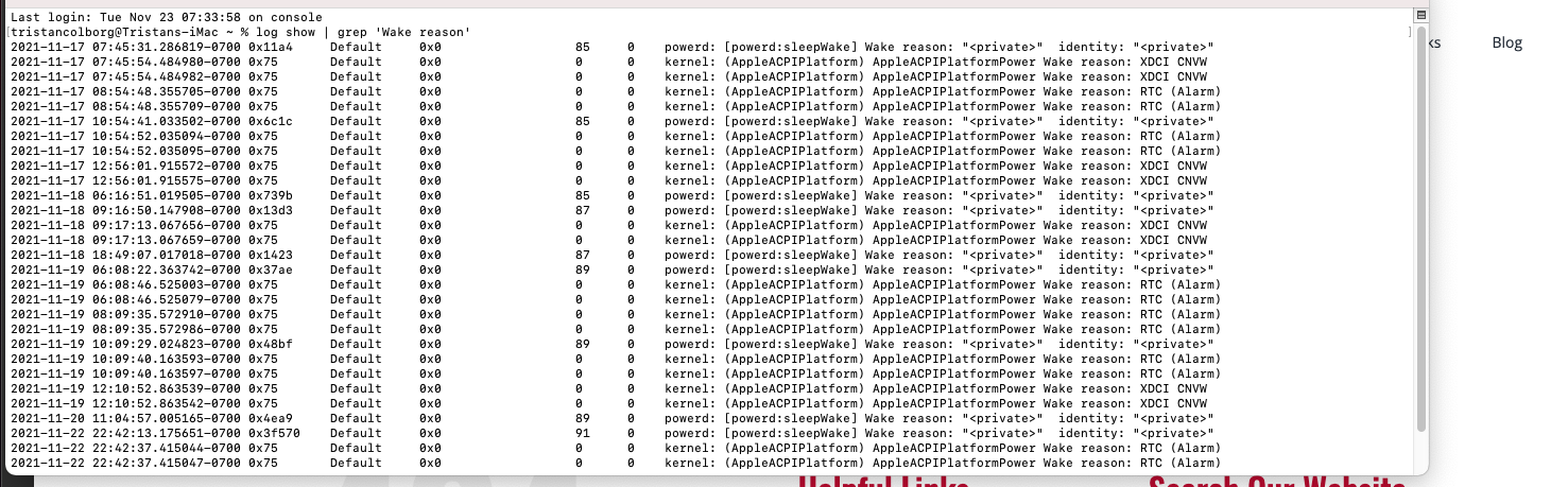

Tristan Colborg Posted November 23, 2021 Share Posted November 23, 2021 Hello everyone I recently upgraded some hardware on my unit, and freshly installed Big Sur. I mapped my USB ports and followed the open-core guide for wake issues, but my computer is constantly waking up. I ran the terminal command "grep "Wake Reason" and got the below information but can't figure out what is causing it. Attached is my EFI folder, and would love some help getting this resolved. EFI.zip Link to comment Share on other sites More sharing options...

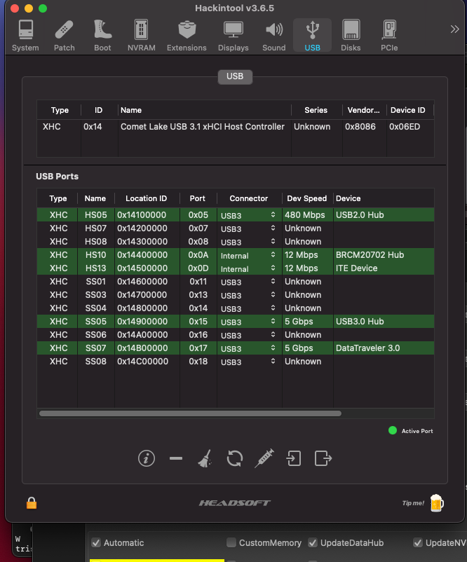

Tristan Colborg Posted November 26, 2021 Author Share Posted November 26, 2021 21 hours ago, Baio77 said: I wrote to add files and not to replace Okay I added this to my usb EFI with my current set up but still getting wake issues. I have redone my kext file for USB mapping but still getting wake issues. Here is my current USB map. Also my terminal "Wake Reason" log. The only other thing I can think of doing is disabling the BT on the motherboard. EFI.zip Link to comment Share on other sites More sharing options...

Tristan Colborg Posted November 26, 2021 Author Share Posted November 26, 2021 6 hours ago, Baio77 said: Describe PC HW in USB test this EFI.zip I may have figured it out, by removing the Built in Bluetooth port. I didn't have any random wakes last night, let me see how today goes. Link to comment Share on other sites More sharing options...

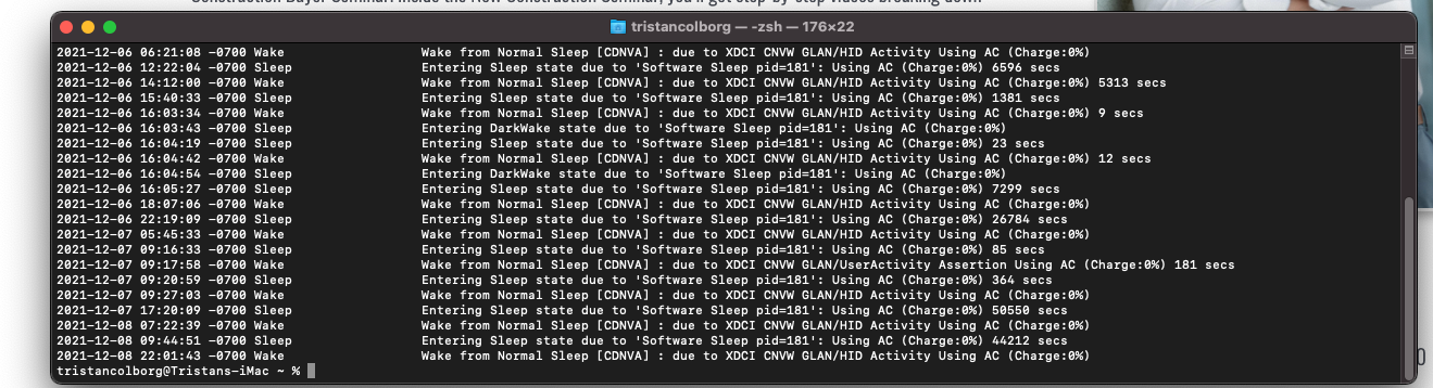

Tristan Colborg Posted December 9, 2021 Author Share Posted December 9, 2021 So I have got the computer to do better at staying asleep, however, I am still getting some random wakelocks. Also, the computer only goes to sleep if I put it to sleep using the power menu. Any additional thoughts help would be appreciated. EFICurrent.zip Link to comment Share on other sites More sharing options...
