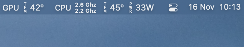

Aluveitie Posted November 16, 2021 Share Posted November 16, 2021 I started reworking RadeonMonitor to be independent of FakeSMC to use it with VirtualSMC or in a VM without both. The RadeonSensor.kext provides the GPU temperature which the RadeonGadget.app can display in the status bar. The Design is kept close to the AMD Power Gadget. The SMCRadeonGPU.kext additionally can export the temperature to VirtualSMC for tools like iStats and HWMonitor. https://github.com/aluveitie/RadeonSensor/releases/tag/0.3.1 4 Link to comment https://www.insanelymac.com/forum/topic/349632-radeonsensor-monitor-gpu-temperature-with-virtualsmc-or-vm/ Share on other sites More sharing options...
miliuco Posted November 16, 2021 Share Posted November 16, 2021 (edited) 2 hours ago, Aluveitie said: I started reworking RadeonMonitor to be independent of FakeSMC to use it with VirtualSMC or in a VM without both... RadeonSensor.kext must be placed before SMCRadeonGPU.kext as seen in Info.plist or it doesn't matter? Edited November 16, 2021 by miliuco Link to comment https://www.insanelymac.com/forum/topic/349632-radeonsensor-monitor-gpu-temperature-with-virtualsmc-or-vm/#findComment-2771981 Share on other sites More sharing options...
Aluveitie Posted November 16, 2021 Author Share Posted November 16, 2021 (edited) @miliuco Yes, the RadeonSensor.kext must come first, since SMCRadeonGPU.kext is depending on it to get the temperature. Edited November 16, 2021 by Aluveitie 1 Link to comment https://www.insanelymac.com/forum/topic/349632-radeonsensor-monitor-gpu-temperature-with-virtualsmc-or-vm/#findComment-2771984 Share on other sites More sharing options...
miliuco Posted November 16, 2021 Share Posted November 16, 2021 @Aluveitie Tried. It works good. it adds an extra menubar GPU temp sensor to iStats. 1 1 Link to comment https://www.insanelymac.com/forum/topic/349632-radeonsensor-monitor-gpu-temperature-with-virtualsmc-or-vm/#findComment-2771997 Share on other sites More sharing options...
