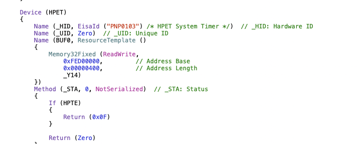

  1. The HP EliteDesk 800 G3 Mini DSDT allows control of device HPET by setting HPTE = 0 or 1.  Setting HPTE to 0 (as in the previous example I posted for you) should disable device HPET.  You will need to confirm this in your own DSDT.

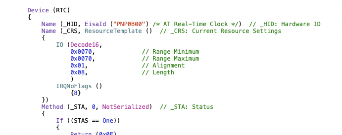

  2. The HP EliteDesk 800 G3 Mini DSDT allows control of device RTC by setting variable STAS = 1 to enable RTC and something other than 1 to disable RTC.  If your Prodesk G3 has the same STAS control mechanism, you would add STAS = 0 in the INI method in my previous example SSDT.  Seting STAS = 0 will disable the original RTC.  You will need to confirm this in your own DSDT.
  3. After you disable RTC (by setting STAS = 0 if that is what your DSDT indicates), you can use the RTC0 patch from my previous example to create a new RTC0 device.

  1. Is HPTE used to enable/disable Device HPET?  I think the answer is "yes," but you need to examine your DSDT to confirm.
  2. Is STAS used to enable/disable Device RTC?  I think the answer is "yes," but you need to examine your DSDT to confirm.

1 Yes I think So:
2 Yes I think So
  • I see 2 devices. In your example file I only see device RTC0 ... lost here.
