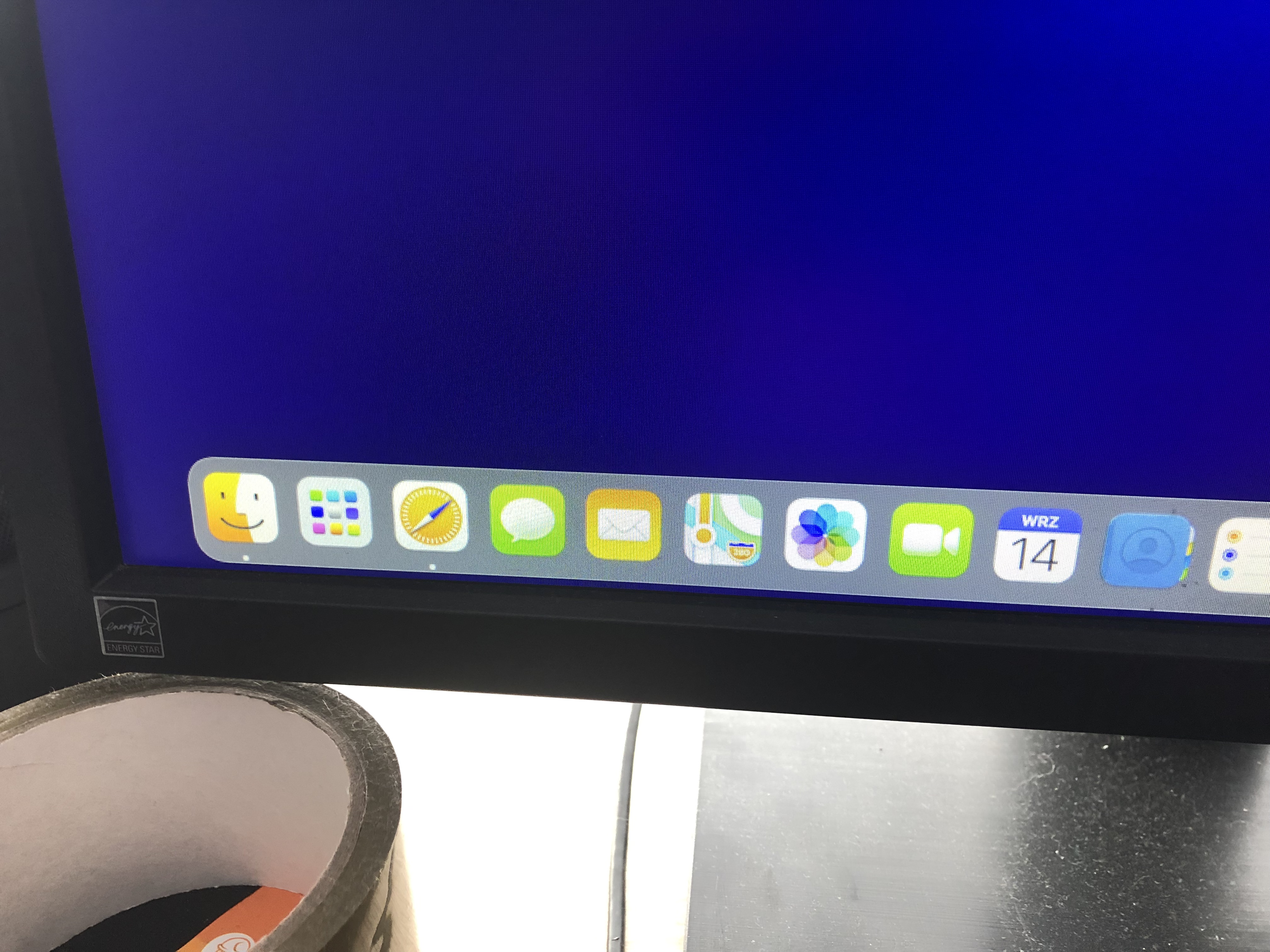

teargas666 Posted September 14, 2021 Share Posted September 14, 2021 Hi,I have a problems with fake colors on my hackintosh. After installation the configuration of the user was very, very slow. After login to my account I have correctly recognized GPU, but the colors are wrong... What have I do to correct or set properly them? There is also No graphics acceleration at all. Dock is not transparent. When I a SS and open it on my phone colors are ok. When the Big Sur is booted in safe mode everything is correct…I have also problems with performance of the system. Minimization of the Safari takes approximately 5-6 seconds, restore of the Safari windows takes 3-4 seconds and makes some glitches...CPU: i5-7400MoBo: GA-H110m-S2HRAM: 16 GB RAMGPU: UHD630Screen: LG E2210OpenCore 0.7.1 Link to comment https://www.insanelymac.com/forum/topic/348902-big-sur-1152-wrong-colours/ Share on other sites More sharing options...

Edhawk Posted September 14, 2021 Share Posted September 14, 2021 @Hervé it would probably help if @teargas666 informed you that he is using the VGA port, and that is why he is seeing the graphics issues, the IGPU lacks acceleration etc. Link to comment https://www.insanelymac.com/forum/topic/348902-big-sur-1152-wrong-colours/#findComment-2766431 Share on other sites More sharing options...
teargas666 Posted September 16, 2021 Author Share Posted September 16, 2021 Hi. no, there is no change on the DVI cable. In the following link I have uploaded requested files. https://we.tl/t-apkWhmTOmv Link to comment https://www.insanelymac.com/forum/topic/348902-big-sur-1152-wrong-colours/#findComment-2766611 Share on other sites More sharing options...
teargas666 Posted September 16, 2021 Author Share Posted September 16, 2021 35 minutes ago, Hervé said: Really? You config shows that you've not followed the Dortania guidance on the matter of iGPU/graphics. You just inject the default KBL framebuffer 0x5916000, not the recommended properties at all. I suggest you do so. Same applies for the SMBIOS: you've opted for iMac18,2 when the Dortania guidance recommends iMac18,1: If you use iMac18,2 or iMac18,3, it's usually in the case of a dGPU alongside the iGPU and Clover then recommend KBL framebuffer 0x59120003 not 0x59120000. KBL framebuffer 0x59160000 is actually a mobile layout when KBL framebuffer 0x59120000 is a desktop one. No need to say more... ID: 59160000, STOLEN: 34 MB, FBMEM: 0 bytes, VRAM: 1536 MB, Flags: 0x00000B0B TOTAL STOLEN: 35 MB, TOTAL CURSOR: 1 MB (1572864 bytes), MAX STOLEN: 103 MB, MAX OVERALL: 104 MB (109588480 bytes) Model name: Intel HD Graphics KBL CRB Camellia: CamelliaDisabled (0), Freq: 1388 Hz, FreqMax: 1388 Hz Mobile: 1, PipeCount: 3, PortCount: 3, FBMemoryCount: 3 [0] busId: 0x00, pipe: 8, type: 0x00000002, flags: 0x00000098 - ConnectorLVDS [1] busId: 0x05, pipe: 9, type: 0x00000400, flags: 0x00000187 - ConnectorDP [2] busId: 0x04, pipe: 10, type: 0x00000800, flags: 0x00000187 - ConnectorHDMI 00000800 02000000 98000000 01050900 00040000 87010000 02040A00 00080000 87010000 ID: 59120000, STOLEN: 38 MB, FBMEM: 0 bytes, VRAM: 1536 MB, Flags: 0x0000110B TOTAL STOLEN: 39 MB, TOTAL CURSOR: 1 MB (1572864 bytes), MAX STOLEN: 115 MB, MAX OVERALL: 116 MB (122171392 bytes) Model name: Intel HD Graphics KBL CRB Camellia: CamelliaDisabled (0), Freq: 1388 Hz, FreqMax: 1388 Hz Mobile: 0, PipeCount: 3, PortCount: 3, FBMemoryCount: 3 [1] busId: 0x05, pipe: 9, type: 0x00000400, flags: 0x00000187 - ConnectorDP [2] busId: 0x04, pipe: 10, type: 0x00000400, flags: 0x00000187 - ConnectorDP [3] busId: 0x06, pipe: 10, type: 0x00000400, flags: 0x00000187 - ConnectorDP 01050900 00040000 87010000 02040A00 00040000 87010000 03060A00 00040000 87010000 You may find things will work better if you actually apply the recommended settings which you stated you did when in fact you did not. ok. I will do it tomorrow And i will check. a lot od these changes were made due to wrong colours. I will back tomorrow Link to comment https://www.insanelymac.com/forum/topic/348902-big-sur-1152-wrong-colours/#findComment-2766617 Share on other sites More sharing options...
teargas666 Posted September 23, 2021 Author Share Posted September 23, 2021 (edited) ok, I'm after a couple of tests... Framebuffer 00001219 + SMBIOS 18,2 is booting, colors are ok, but gpu is recognized as just 6MB Framebuffer 00001219 + SMBIOS 18,1 is not booting Framebuffer 00001259 + SMBIOS 18,1 is not booting Framebuffer 00001259 + SMBIOS 18,2 is booting with wrong colors Im able to set the stolen memory in the UEFI and set is for 64 MB Edited September 23, 2021 by teargas666 Link to comment https://www.insanelymac.com/forum/topic/348902-big-sur-1152-wrong-colours/#findComment-2767285 Share on other sites More sharing options...
teargas666 Posted October 14, 2021 Author Share Posted October 14, 2021 (edited) hi, there is update. Finally I have correct colors in my hackintosh, gpu is recognized correctly but Dock and Task Bar are not transparent and Safari's windows are very slow when I try to minimize and restore the window. Edited October 16, 2021 by teargas666 Link to comment https://www.insanelymac.com/forum/topic/348902-big-sur-1152-wrong-colours/#findComment-2769248 Share on other sites More sharing options...
