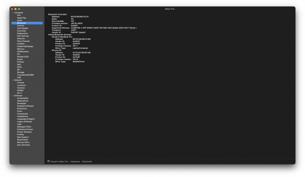

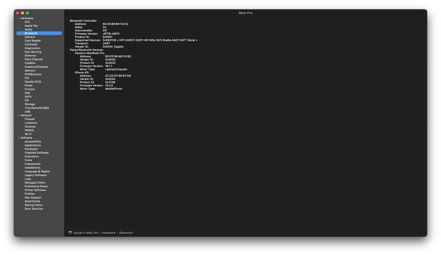

Hi you all, I have a few issues with my Asus X99 Deluxe builtin wifi+bt module (Azurewave 4360+20702 [0b05:180a]. The problem is that if I turn off bluetooth I need to reboot my computer to be able to get it back on #1 and also wierd is that in about my mac bluetooth section as transport appears UART not USB #2. I have to mention that I have fully mapped usb and in big sur bluetooth works flawlesly (including airdrop and handoff), in monterey handoff and airdrop works only one way (from my macbook to my hack or my iphone to my hack).

#2 About My Mac
