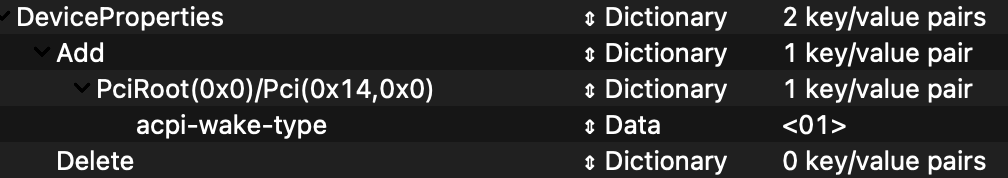

miliuco Posted June 14, 2021 Author Share Posted June 14, 2021 (edited) 40 minutes ago, eSaF said: @miliuco - Hi Bro this is my readout from BS and Monterey, my problem is, Sleep/Wake is very flaky, sometimes it will sleep and another time it will not, Wake is not a problem it will wake with a double click of the mouse no problem. I did have a kext that would wake the machine with just one click but I cannot find it after doing numerous clean installs so now I have to do two clicks to wake the machine... This are the 2 files, SSDT and kext, that go toghether to wake up with a single click. This is the website:https://github.com/osy/USBWakeFixup But before using this method, do you have acpi-wake-type property in DeviceProperties relative to USB device (PciRoot(0x0)/Pci(0x14,0x0) on my system)? Sometimes this is enough to get you out of sleep with just one touch. As per Dortania guide: "So an odd bug with Intel's 100 series chipsets and newer is that sometimes macOS requires a second keyboard press or some other wake event to power up the monitor as well, with some requiring a keypress+power button to wake. Well to fix this, we need to either: Set acpi-wake-type to the USB Controller(Recommended...)" You say "sometimes it will sleep and another time it will not", have you noticed if it is like in my post, the first time yes and subsequent times no? usbw.zip Edited June 14, 2021 by miliuco Link to comment https://www.insanelymac.com/forum/topic/348106-solved-full-sleep-in-the-first-sleep-but-not-in-the-subsequent-ones-before-shutdown-or-reboot/#findComment-2760801 Share on other sites More sharing options...
