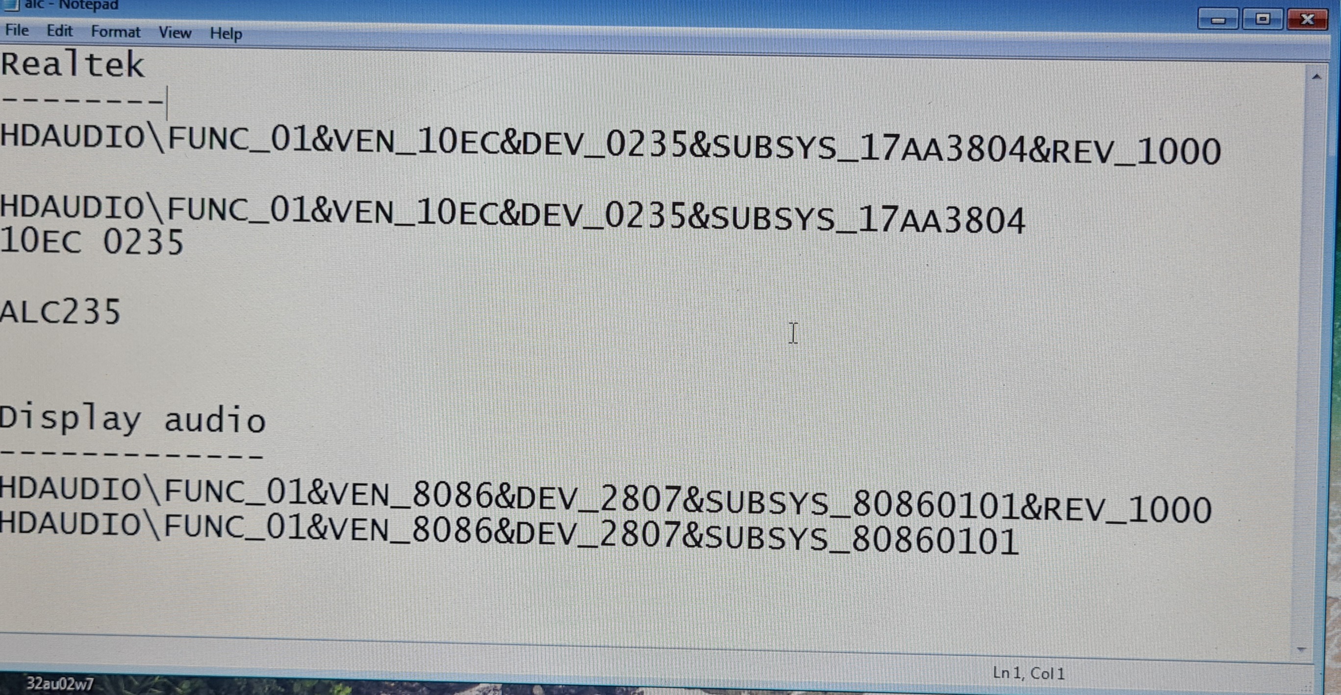

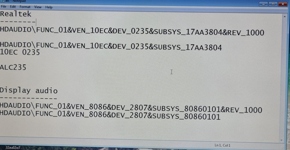

sbhas2k Posted May 30, 2021 Author Share Posted May 30, 2021 (edited) 2 hours ago, Mirone said: Hello, none of the Layout-Id's contained in AppleALC work for you? not even the Speakers? Yes, you are correct. Only voodoo kext works Even I have installed windows in a different hdd just to check the ALC codec details and confirmed it was indeed 235 Edited May 30, 2021 by sbhas2k Added windows hardware details Quote Link to comment https://www.insanelymac.com/forum/topic/347963-alc-235-lenovo-b40-70-catalina-issue/#findComment-2759641 Share on other sites More sharing options...
Mirone Posted May 30, 2021 Share Posted May 30, 2021 Could you send me a dump of your codec extracting with the latest version of linux? Quote Link to comment https://www.insanelymac.com/forum/topic/347963-alc-235-lenovo-b40-70-catalina-issue/#findComment-2759643 Share on other sites More sharing options...

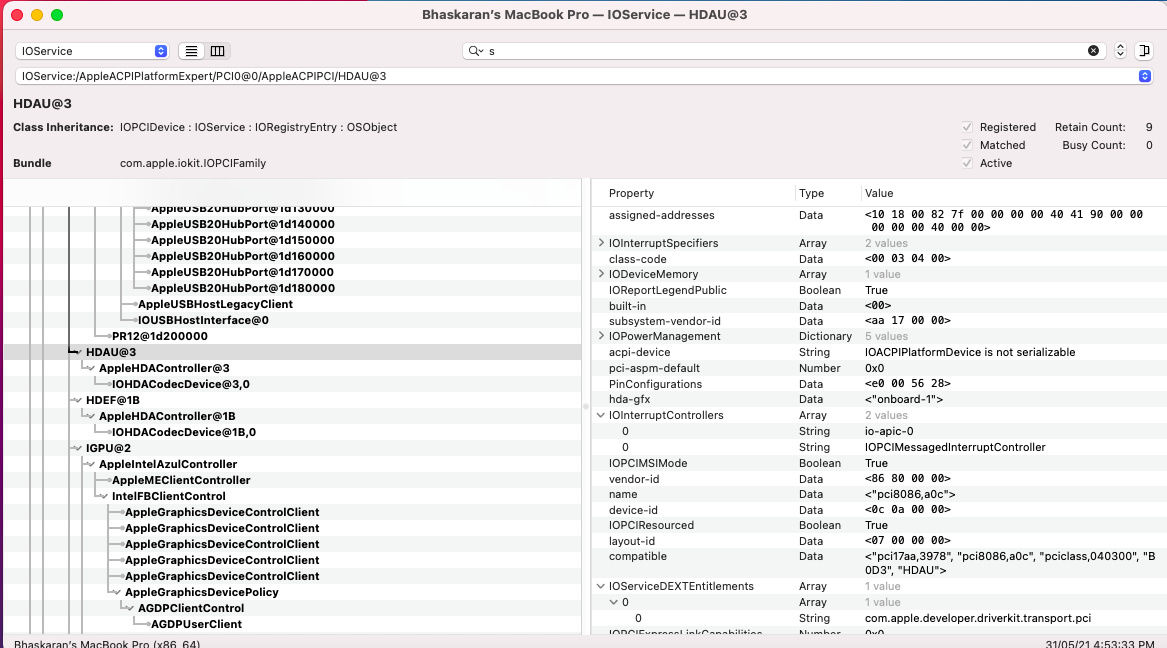

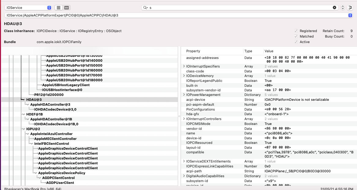

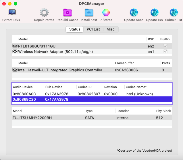

sbhas2k Posted May 31, 2021 Author Share Posted May 31, 2021 17 minutes ago, wern apfel said: The linux-dump shows only the digital codec. Do you see a device and have no sound? I think the issue is not AppleALC. An IOReg-dump could be useful. Ioreg shows both intel hashwell hdmi and alc235. Will try to take a dump (as a result of trying multiple things my OS Is no longer booting:( ) Quote Link to comment https://www.insanelymac.com/forum/topic/347963-alc-235-lenovo-b40-70-catalina-issue/#findComment-2759689 Share on other sites More sharing options...

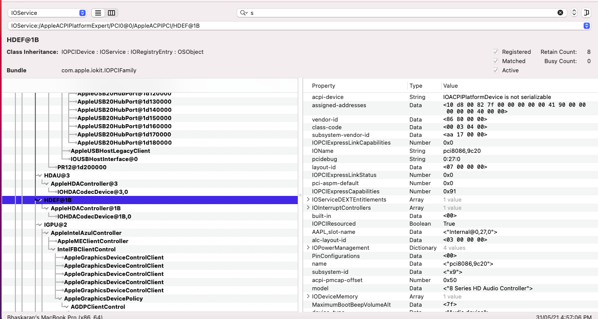

sbhas2k Posted May 31, 2021 Author Share Posted May 31, 2021 (edited) 1 hour ago, sbhas2k said: Ioreg shows both intel hashwell hdmi and alc235. Will try to take a dump (as a result of trying multiple things my OS Is no longer booting:( ) I had another hdd with bigsur installed. Please find attached screenshots from IORegistry explorer (dunno the way to take dump) and dpci manager. You can see 2 entries for audio, one for intel hdmi and another alc235 Hope this helps. Edited May 31, 2021 by sbhas2k screenshots attached Quote Link to comment https://www.insanelymac.com/forum/topic/347963-alc-235-lenovo-b40-70-catalina-issue/#findComment-2759694 Share on other sites More sharing options...

wern apfel Posted May 31, 2021 Share Posted May 31, 2021 40 minutes ago, sbhas2k said: My bad. Please find the same attached IORegistryExport.zip 5.68 MB · 0 downloads AppleALC is not loaded, but VoodooHDA. Remove Voodoo if you wan't to use AppleALC. Quote Link to comment https://www.insanelymac.com/forum/topic/347963-alc-235-lenovo-b40-70-catalina-issue/#findComment-2759704 Share on other sites More sharing options...
sbhas2k Posted May 31, 2021 Author Share Posted May 31, 2021 1 hour ago, wern apfel said: AppleALC is not loaded, but VoodooHDA. Remove Voodoo if you wan't to use AppleALC. Please find the ioreg dump with AppleALC. Thanks ioreg_alc.zip Quote Link to comment https://www.insanelymac.com/forum/topic/347963-alc-235-lenovo-b40-70-catalina-issue/#findComment-2759707 Share on other sites More sharing options...

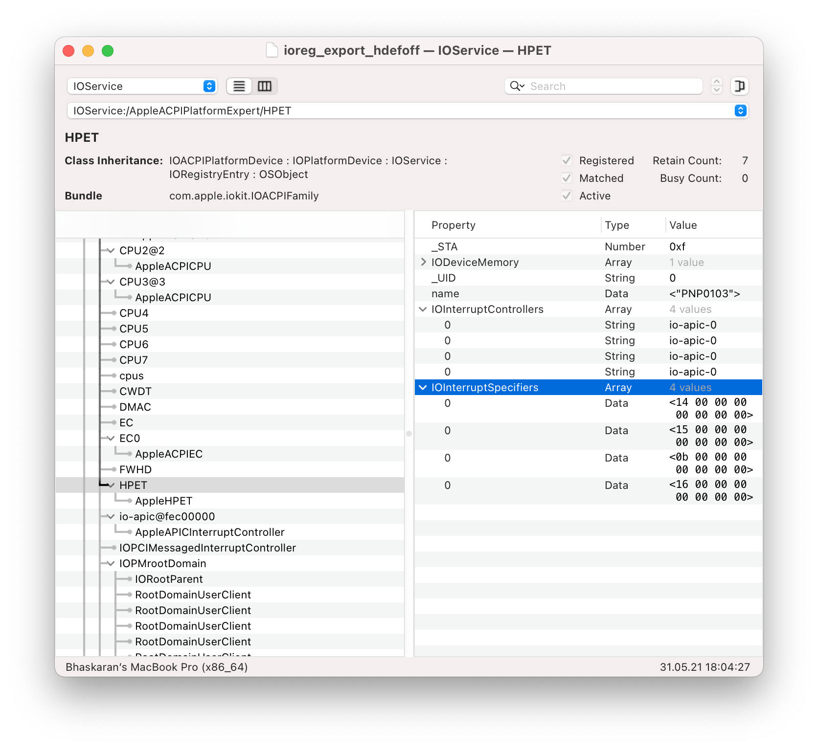

wern apfel Posted May 31, 2021 Share Posted May 31, 2021 17 minutes ago, sbhas2k said: Hi. I have included this ssdt and restarted. Please find attached IOReg export. Let me know anything else needs to be done or direct me on the correct path ioreg_export_hdefoff.zip 5.7 MB · 0 downloads HPET is still there, try this SSDT. If you use Clover enable the HPET fix. SSDT-HPET.aml.zip Quote Link to comment https://www.insanelymac.com/forum/topic/347963-alc-235-lenovo-b40-70-catalina-issue/#findComment-2759712 Share on other sites More sharing options...
sbhas2k Posted May 31, 2021 Author Share Posted May 31, 2021 25 minutes ago, wern apfel said: HPET is still there, try this SSDT. If you use Clover enable the HPET fix. SSDT-HPET.aml.zip 980 B · 2 downloads I can still see HPET Quote Link to comment https://www.insanelymac.com/forum/topic/347963-alc-235-lenovo-b40-70-catalina-issue/#findComment-2759713 Share on other sites More sharing options...

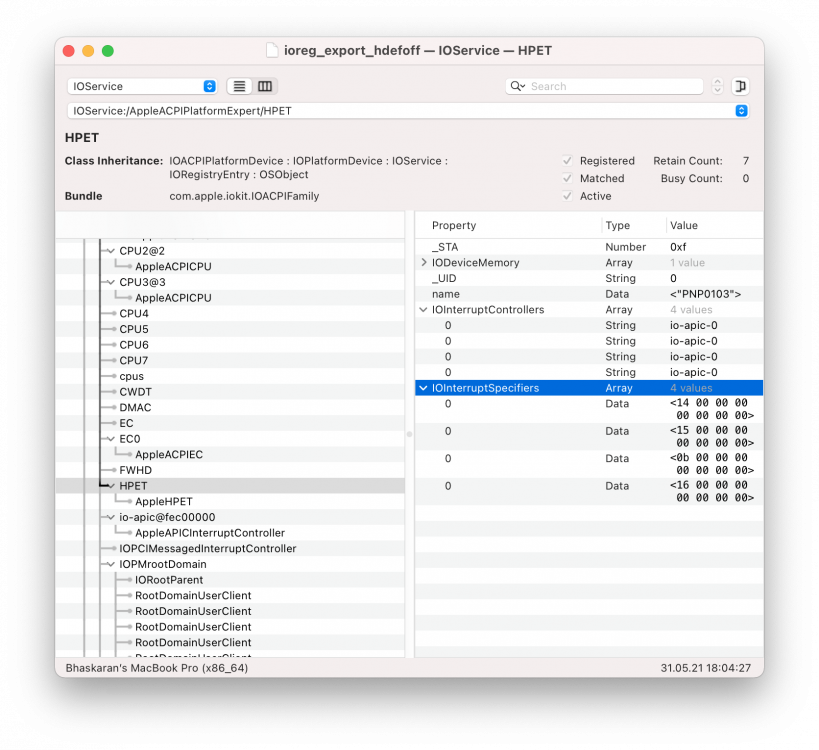

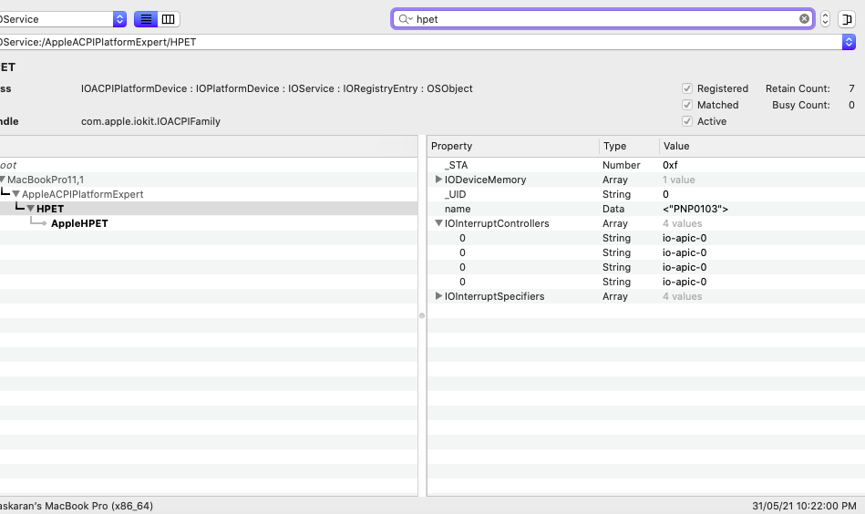

wern apfel Posted May 31, 2021 Share Posted May 31, 2021 2 minutes ago, sbhas2k said: I can still see HPET The second SSDT does not disable HPET, but assigns low IRQs. Show me the IOInterruptSecifiers. Quote Link to comment https://www.insanelymac.com/forum/topic/347963-alc-235-lenovo-b40-70-catalina-issue/#findComment-2759714 Share on other sites More sharing options...
sbhas2k Posted May 31, 2021 Author Share Posted May 31, 2021 (edited) 1 hour ago, wern apfel said: The second SSDT does not disable HPET, but assigns low IRQs. Show me the IOInterruptSecifiers. How to get the interrupt specifiers? I have attached my efi folder if that contains the same. Attached IOReg output as well EFI.zip io.txt.zip Edited May 31, 2021 by sbhas2k Quote Link to comment https://www.insanelymac.com/forum/topic/347963-alc-235-lenovo-b40-70-catalina-issue/#findComment-2759719 Share on other sites More sharing options...
wern apfel Posted May 31, 2021 Share Posted May 31, 2021 It was very close, see screenshot. You already had that HPET-SSDT, but somehow it does not work. Can you upload your DSDT? Use MaciASL to save it. Quote Link to comment https://www.insanelymac.com/forum/topic/347963-alc-235-lenovo-b40-70-catalina-issue/#findComment-2759721 Share on other sites More sharing options...
