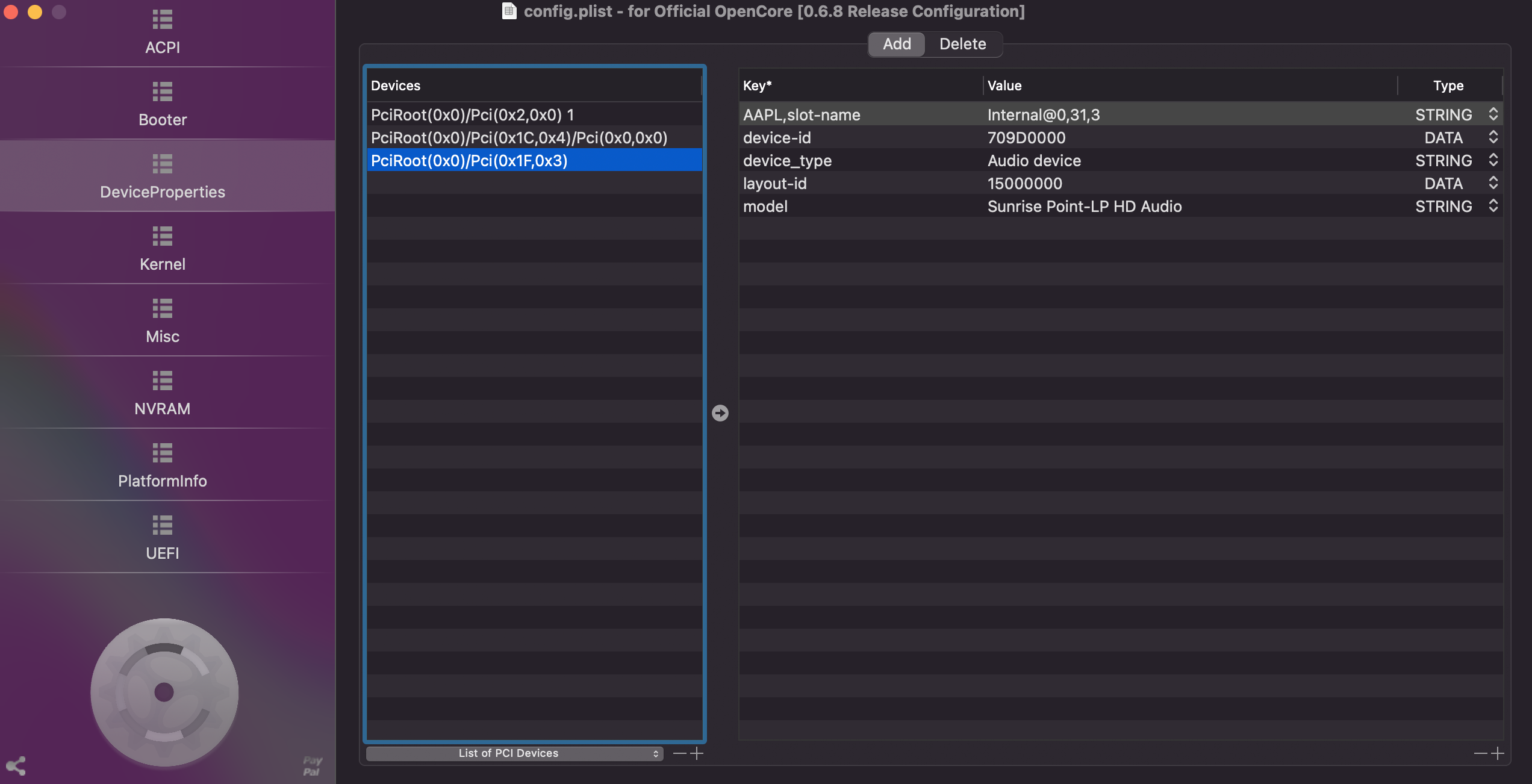

Currently everything is working beautifully, dual boot to either MacOS 11.2.3 or Win10Pro 20H2 on separate WD_SN750 2TB drives in M.2_1 and M.2_2.

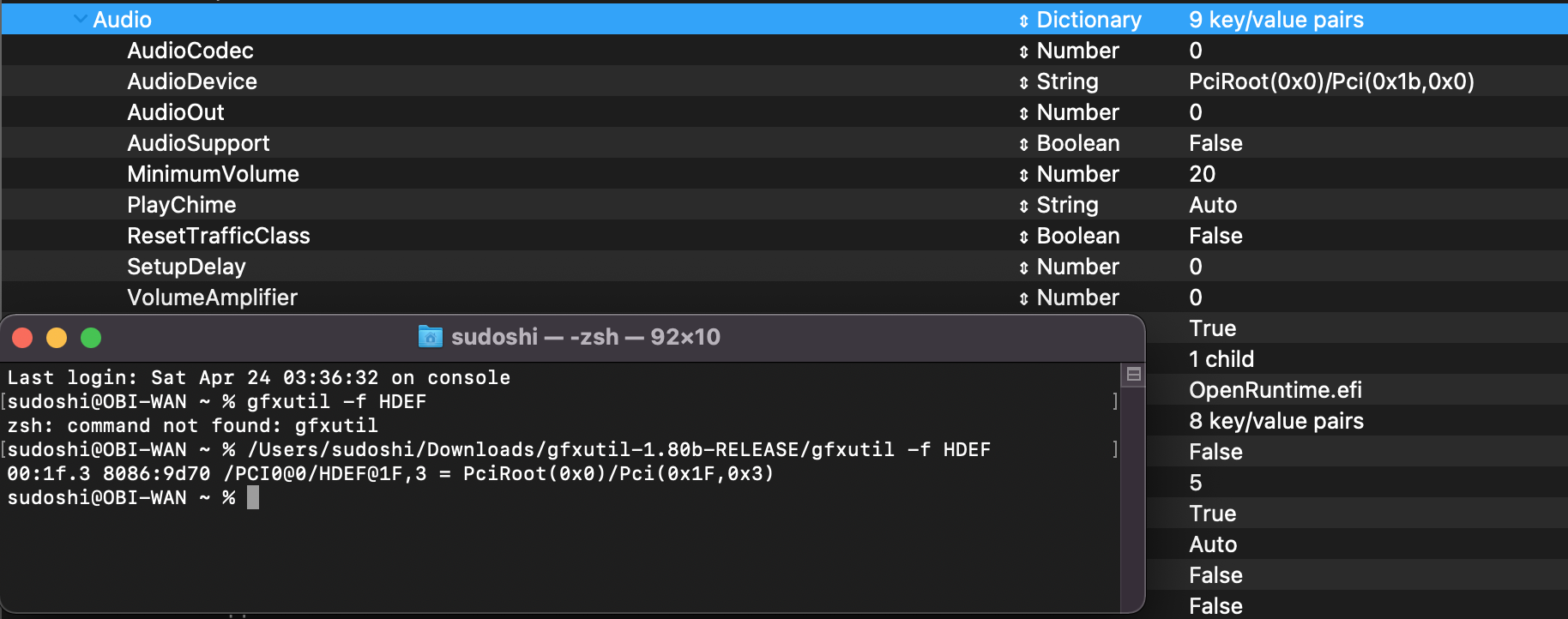

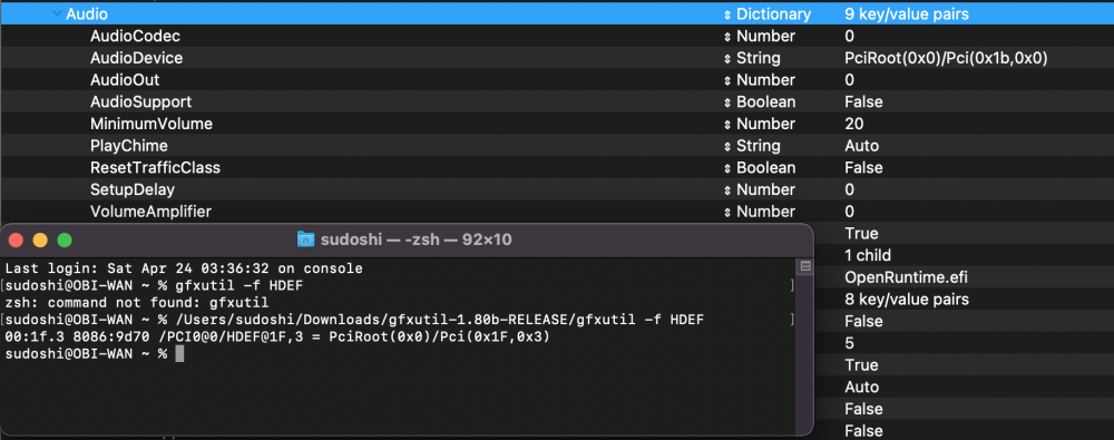

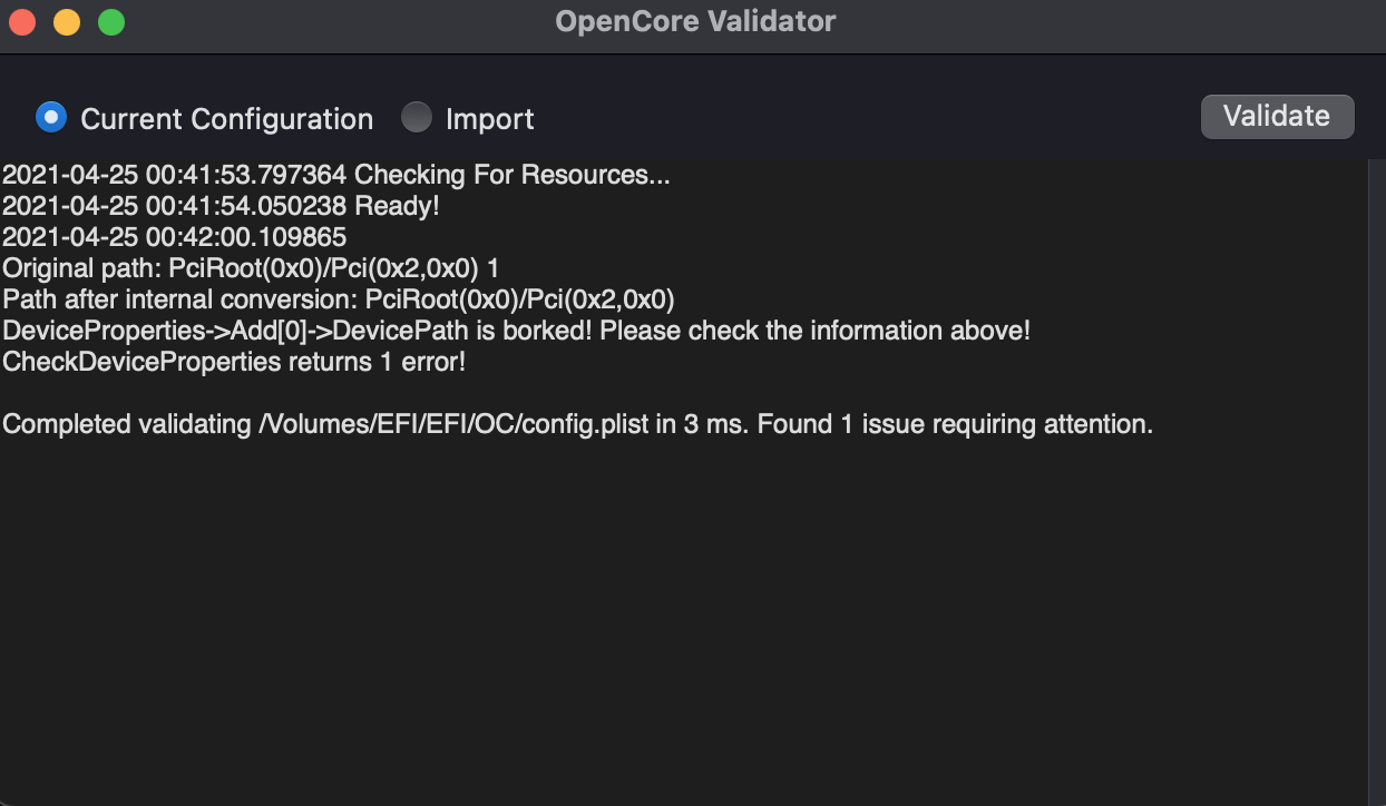

But my audio out via any front or rear ports are 'borked' according to OC Configurator.  The only audio that works is via HDMI to the temporary TV I have the system hooked up to as I await a 38" widescreen.

first delete  layout-id from properties
open nvram section in configurator and boot-arg  add this  alcid=
and try these values 3 o r  11 or  13 and so on  15, 17, 18, 20, 21, 27, 28, 29, 30, 31, 66, 71, 86, 99, 100
each number individual not all
Edited by eng_redaesm

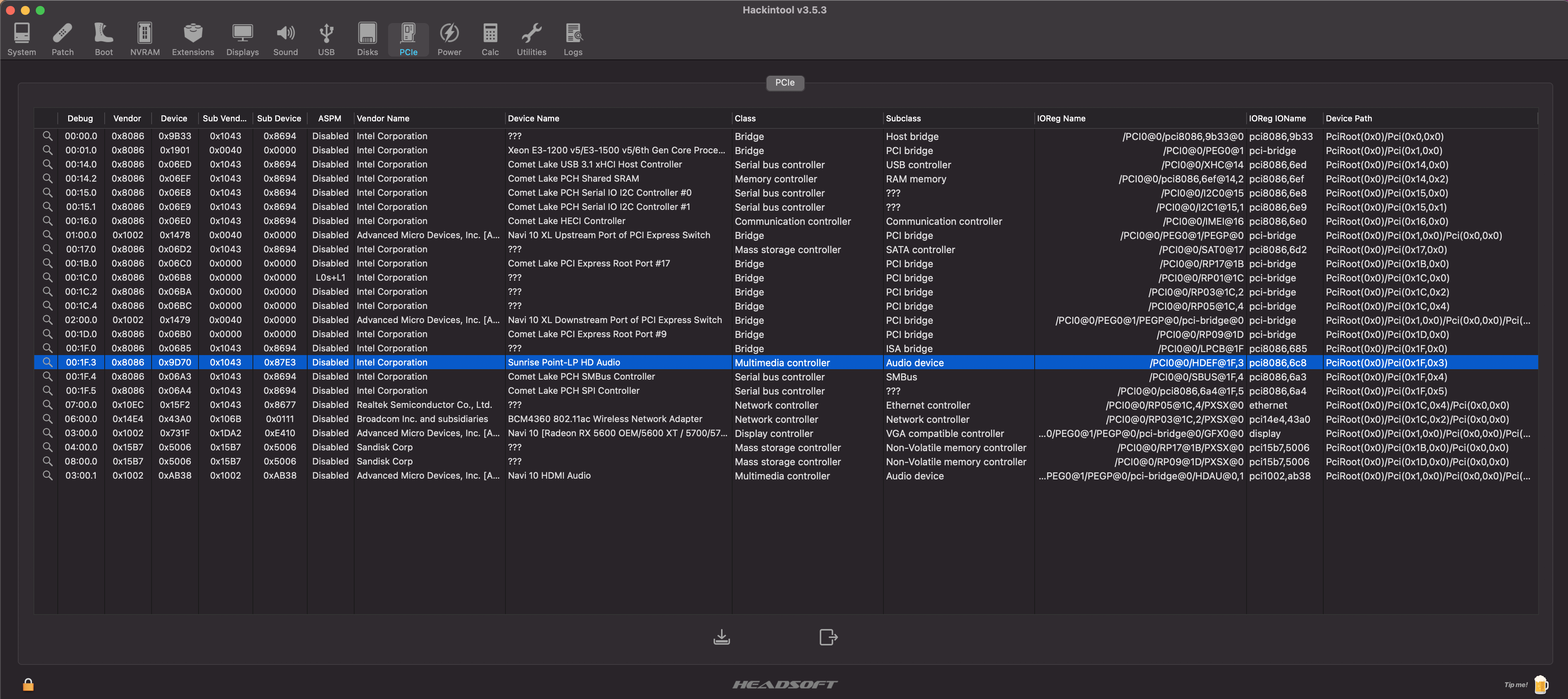

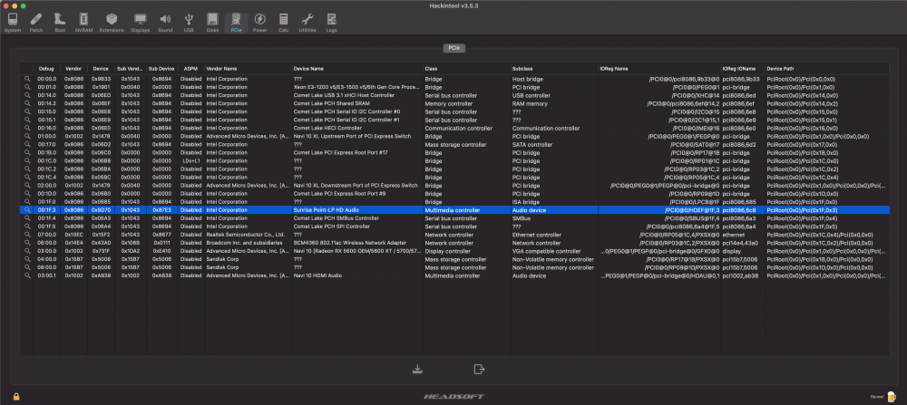

needed the list to run the audio.
  • AppleALC.kext
  • FakeID.kext
  • FakePCIID_Intel_HDMI_Audio.kext
  • device-id=709D0000
  • layout-id=15000000
your config just
                <string>-v keepsyms=1 debug=0x100 alcid=1 agdpmod=pikera</string>
need reconfig
Edited by vltra
add some

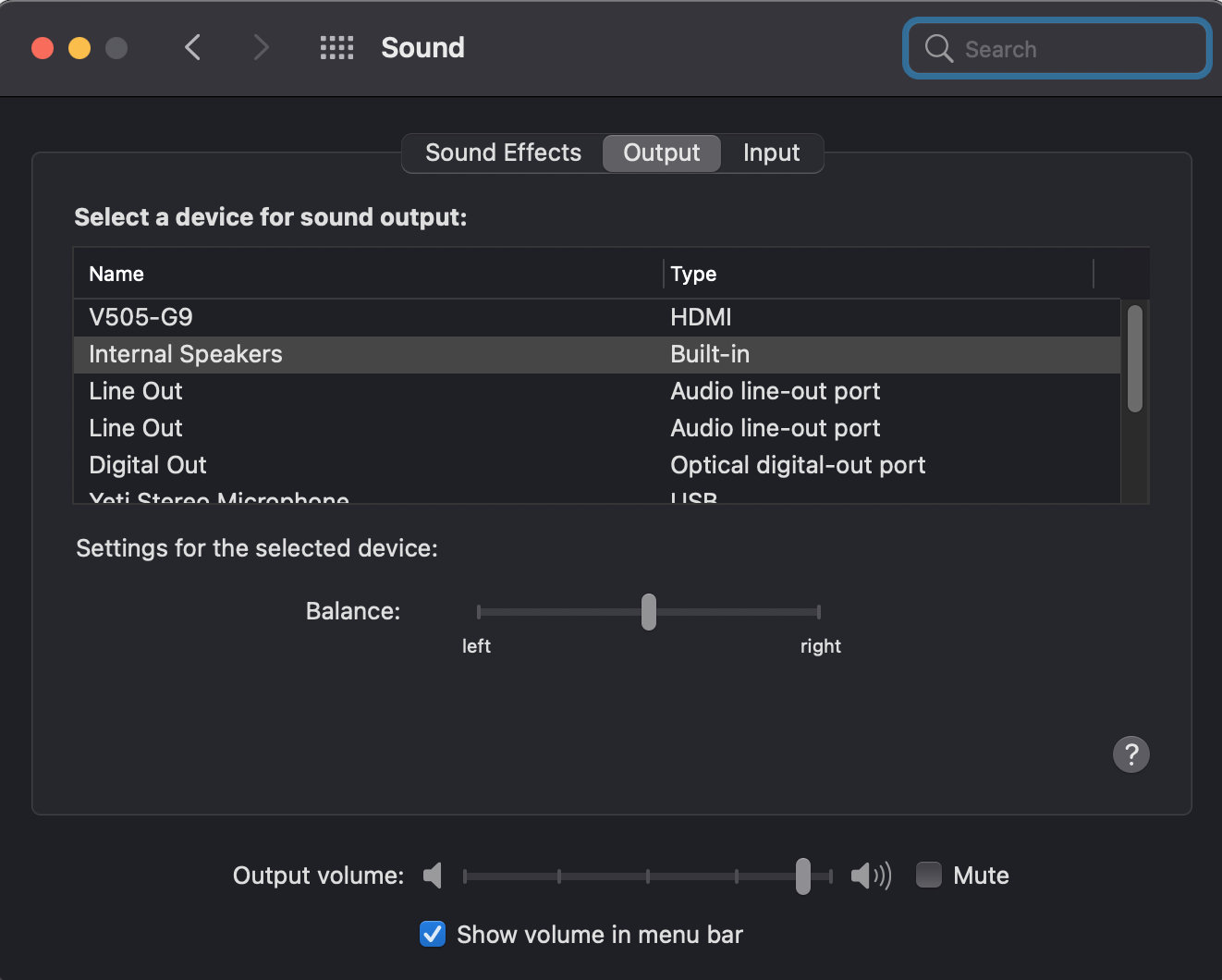

On 4/26/2021 at 5:05 AM, macjedi said:
Ok.  Audio is working, now I have to find the right layout ID (alcid=* * in boot-args of config.plist)for this ASUS PRIME Z490-P (Realtek ALC887)
I'll report back when I find it, and will post a link to my working EFI.
On my Gigabyte H97-HD# using the same ALC887, ID-1 or ID7 works with all internal ports (headphone etc) and if using a USB DAC sound device. If you have an SPDIF (I only use optical) riser card or ? motherboard based port - try to use id-99.
