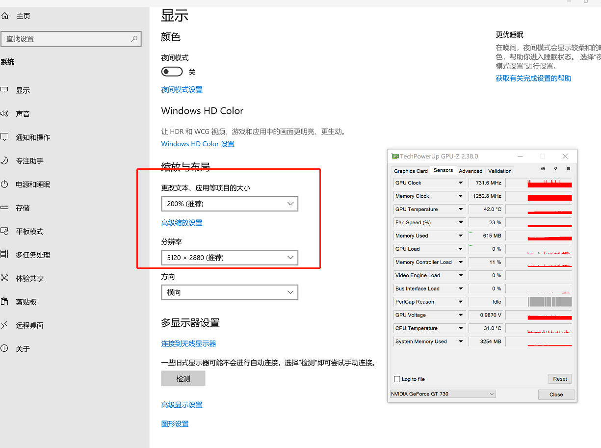

MarvZheng Posted April 14, 2021 Share Posted April 14, 2021 (edited) 4790K + Z87-C. iGPU HD4600 is disabled in motherboard BIOS. I just got a new DELL GT730 with dual DP ports. Connected 2 DP ports at the same time with my DELL UP2715k, it works well on Win10 with 5k resolution. But with Big Sur, 5k doesn't work, it looks quite weird on color & resolution, not at 5k. I tried to switch to single DP1 or DP2, they works well at 4k resolution. Previously I use AMD card, boot with agdpmod=pikera and everything is done. I did the same but it shows a black screen after it finishes the process bar before entering onto desktop. I can fell that system booting is complete but just black screen. Edited April 14, 2021 by MarvZheng Link to comment https://www.insanelymac.com/forum/topic/347402-gt730-gk208-b-for-big-sur-on-dell-5k-monitor/ Share on other sites More sharing options...
MarvZheng Posted April 14, 2021 Author Share Posted April 14, 2021 35 minutes ago, Hervé said: Afaik, max. resolution supported by Kepler GK208B GeForce GT730 is 4K 3840x2160 (@24 or 30Hz over HDMI and should be @60Hz over DP). I don't believe it supports 5K resolution unless it's a specific feature of that Dell card but I'd be surprised with this type of cheap entry-level cards and it'd pretty much be unique... With apps such as SwitchResX, you may be able to create a fake 5K resolution but it'd just be a software arrangement, not a real and native resolution of course I guess Dell made a different because on Win10 I did find it work at 5k resolution. The output performance are just same with what I have seen with RX570 before. This GT730 comes with 2DP ports, GDDR5, 2G RAM; the specification is higher than ordinary old GT730? Link to comment https://www.insanelymac.com/forum/topic/347402-gt730-gk208-b-for-big-sur-on-dell-5k-monitor/#findComment-2755520 Share on other sites More sharing options...
