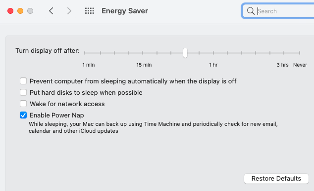

T0pol Posted April 30, 2021 Share Posted April 30, 2021 what do you have in Energy Saver, preferences pannel ? Mine is like Link to comment https://www.insanelymac.com/forum/topic/347284-wakes-up-immediately-after-sleep/#findComment-2756870 Share on other sites More sharing options...

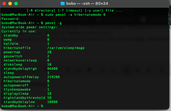

makk Posted May 5, 2021 Share Posted May 5, 2021 (edited) Does your units have powernap? set sleep to 1 standby to 0 hibernatemode 0 no wake for network access set powernap to 20 and it powernaps. Provided you have booting up and set to XCMP X86 Plugin power management. Have to periodically check your BIOS CMOS after tinkering around with kexts patches. CMOS resets happen when we least expect them to. BIOS CMOS USB Wake on to NO (however it is written in your system) Wake on LAN/WLAN to NO Powernap to YES (which turns on virtual hyperthreading) Edited May 7, 2021 by makk Link to comment https://www.insanelymac.com/forum/topic/347284-wakes-up-immediately-after-sleep/#findComment-2757257 Share on other sites More sharing options...
