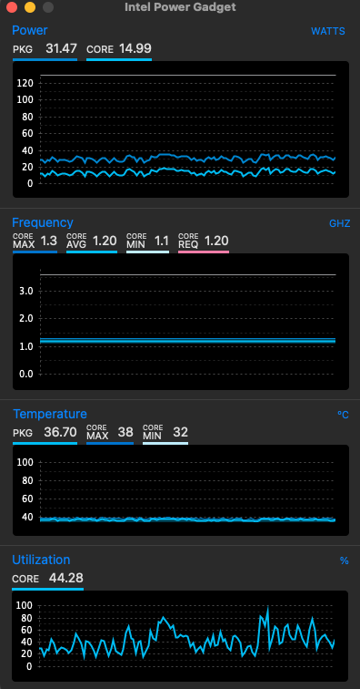

Bahir Posted November 25, 2022 Share Posted November 25, 2022 Someone can help me? I run BigSur 11.7.1, OpenCore 0.8.6 With these 9 patches (1-7) And (2 fro 11.4) my box run extremely slow, CPU stuck forever at 1.2Ghz (I attached IPG screenshot). MOBO: Gigabyte X79-UD3 CPU: i7-3820 Without these patches CPU stuck at 3.7Ghz (sure this is better 🙂 but not for power consumption) Link to comment https://www.insanelymac.com/forum/topic/346988-sandy-bridge-e-power-management-big-sur-1121-big-sur-114/page/3/#findComment-2797790 Share on other sites More sharing options...

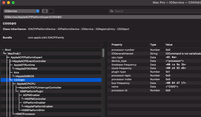

Bahir Posted November 27, 2022 Share Posted November 27, 2022 (edited) On 11/26/2022 at 7:41 AM, verdazil said: Hi! @Bahir, this means that the CPU PM does not work for you at all. Look in the IORegistryExplorer app, what do you see in this place? Show me your EFI and hardware list, it will be easier to understand. In the IORegistryExplorer I see the same as you. Also attached my EFI folder. In it the values of Kernel->Patch that make CPU always 1.2Ghz, i.e. they enabled. MOBO: Gigabyte X79-UD3 CPU: i7-3820 RAM: 32GB (4x8) DDR3 1600MHz (PC3 12800) GPU: NVidia GeForce GT 640 2Mb SSD: Samsung EVO 870 1Tb MacOS: BigSur 11.7.1 (I'd rather install Monterey but I'm not sure it'll work with my GPU/Fresco USB) Edited November 27, 2022 by Bahir Link to comment https://www.insanelymac.com/forum/topic/346988-sandy-bridge-e-power-management-big-sur-1121-big-sur-114/page/3/#findComment-2797868 Share on other sites More sharing options...
