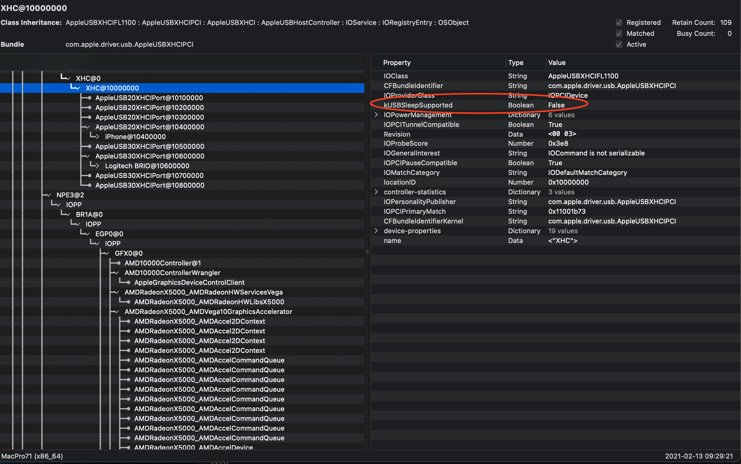

I am trying to figure out how to get the "extra operating current" working for the FL1100 which is natively supported more or less but not perfect. The SMBIOS is macpro7,1

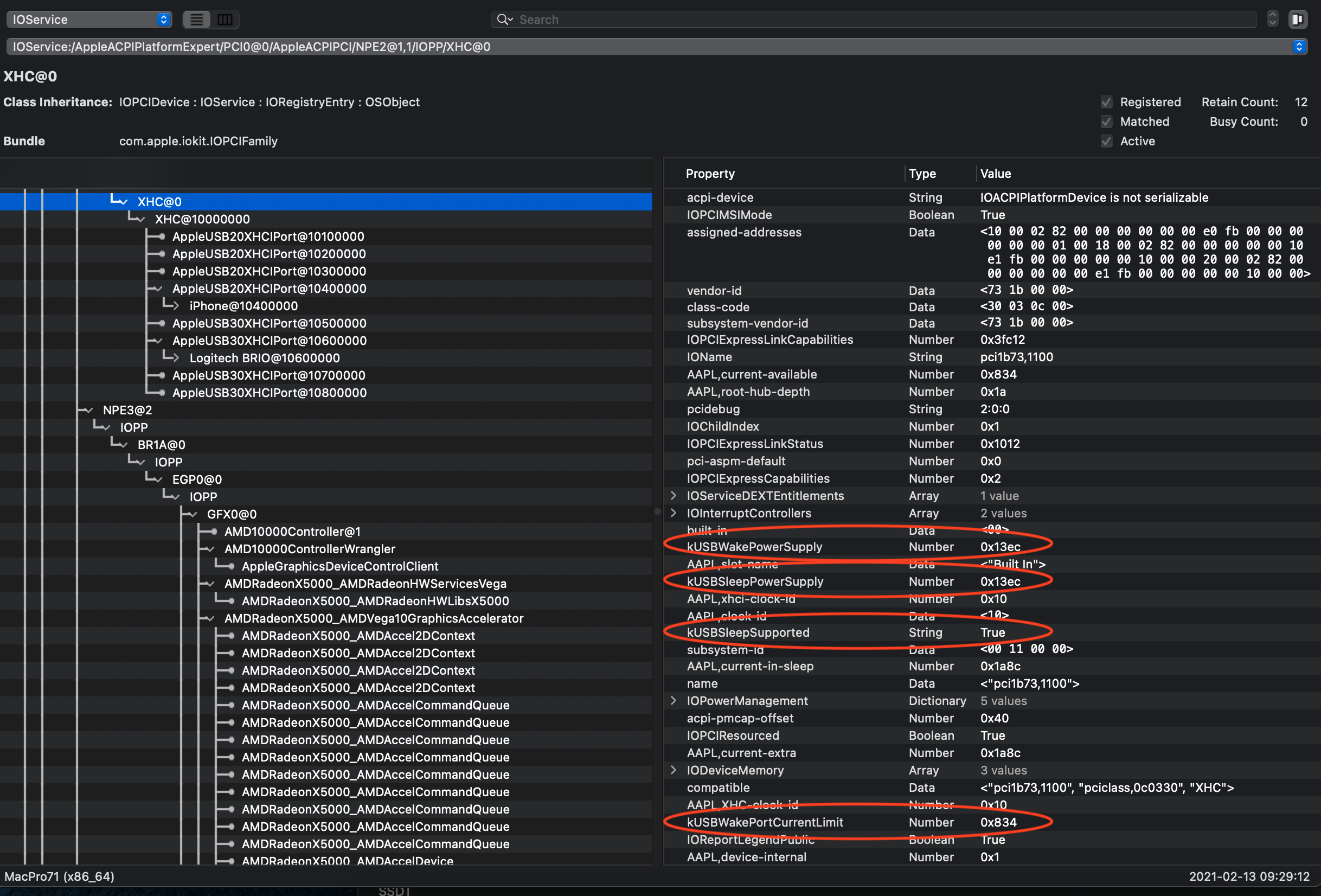

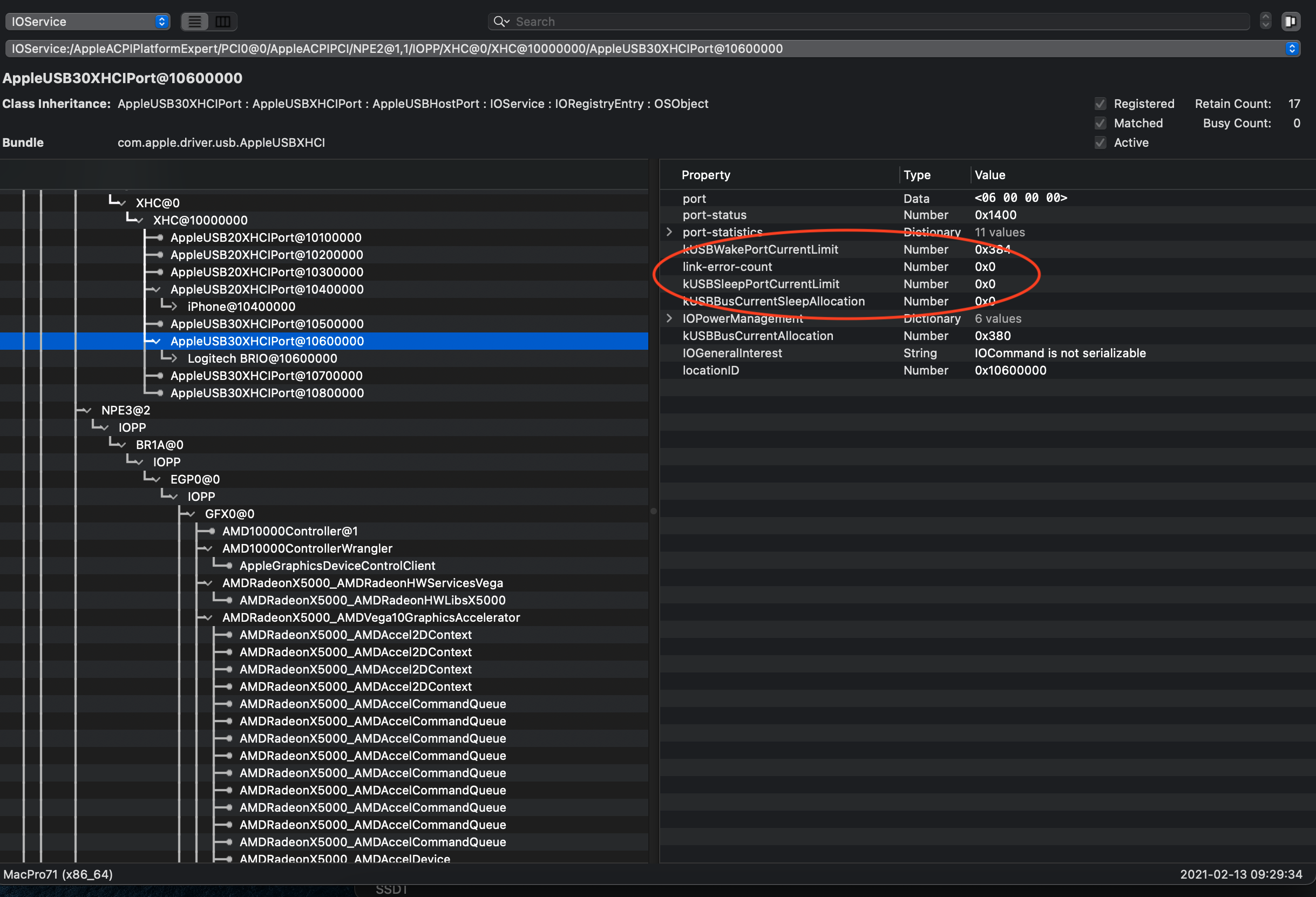

I do not get the kUSB* to propagate down the XHC-device. It stays on the main device and I think one needs it to go down one mor elevel to make it utilised by the driver.
Anyone can help with adressen the subdivide of XHC in the SSDT that I supplied? Maybe one should also rename the ports but haven't come that far yet. Need this to be operating with the extra current of 1600ma
