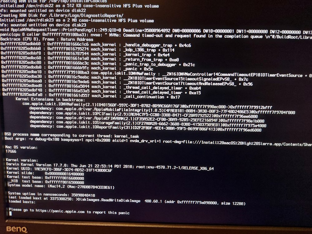

malgkas Posted November 17, 2020 Share Posted November 17, 2020 Hi Everyone, I'm trying to install HighSierra on ASUS Prime X370-Pro/Ryzen 5 2600X/Nvidia GTX 1050 Ti. Every time I trying to boot I'm getting kernel panic from IONVMeFamily. Tried so far NVMeFix.kext, different combinations of config file created from scratch using guide and Olarila config or ACPI files. At the stage I'm on, PC doesn't restart anymore but it crashes on NVMe drive, which I got Windows installed. Is the way to fix or disable the NVMe? I'm planing on installing OSX on normal SATA drive not NVMe drive. BTW. It is doing the same, with little difference when trying fresh Catalina. Kind Regards Malgkas. Link to comment https://www.insanelymac.com/forum/topic/345790-nvme-ionvmefamily-causes-panic-at-boot-with-opencore/ Share on other sites More sharing options...
malgkas Posted November 18, 2020 Author Share Posted November 18, 2020 (edited) Hi, Sorry I've missed that. It's SKHynix HFS256GD9TNG-L5B0B. I don't really need it working on OSX, will not access any data from it anyway. Is there a way to block NVMe support in the OS? Regards Malgkas Edited November 18, 2020 by malgkas Link to comment https://www.insanelymac.com/forum/topic/345790-nvme-ionvmefamily-causes-panic-at-boot-with-opencore/#findComment-2744668 Share on other sites More sharing options...
malgkas Posted November 18, 2020 Author Share Posted November 18, 2020 I've tried adding and enabling "com.apple.iokit.IONVMeFamily" in that section, no difference. If I understand correctly that is "system" name of IONVMeFamily.kext? I think would need add more, but not sure what exactly. Update: Just in case I've tried adding kext name instead but no difference. Link to comment https://www.insanelymac.com/forum/topic/345790-nvme-ionvmefamily-causes-panic-at-boot-with-opencore/#findComment-2744689 Share on other sites More sharing options...
malgkas Posted February 8, 2021 Author Share Posted February 8, 2021 (edited) Hi @Hervé, Thank you for your help, unfortunately nothing actually worked and I've left the problem for while. Yesterday however I've found the way to solve the problem and just wanted to share with everyone. The idea is to block entire controller instead the kexts. Idea came when I've found section in manual about blocking PCIex Graphics card. This method works for NVMe controller as well. I used SSDT Method as I though it looked the easiest, look link to manual below. Hope someone finds this useful. https://dortania.github.io/OpenCore-Install-Guide/extras/spoof.html#ssdt-method All the best! Edited February 8, 2021 by malgkas Link to comment https://www.insanelymac.com/forum/topic/345790-nvme-ionvmefamily-causes-panic-at-boot-with-opencore/#findComment-2750608 Share on other sites More sharing options...
