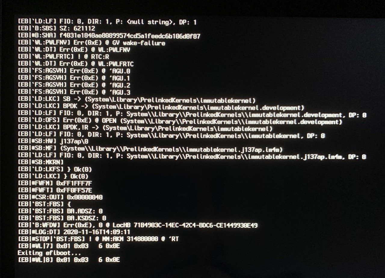

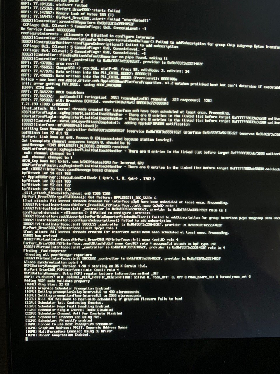

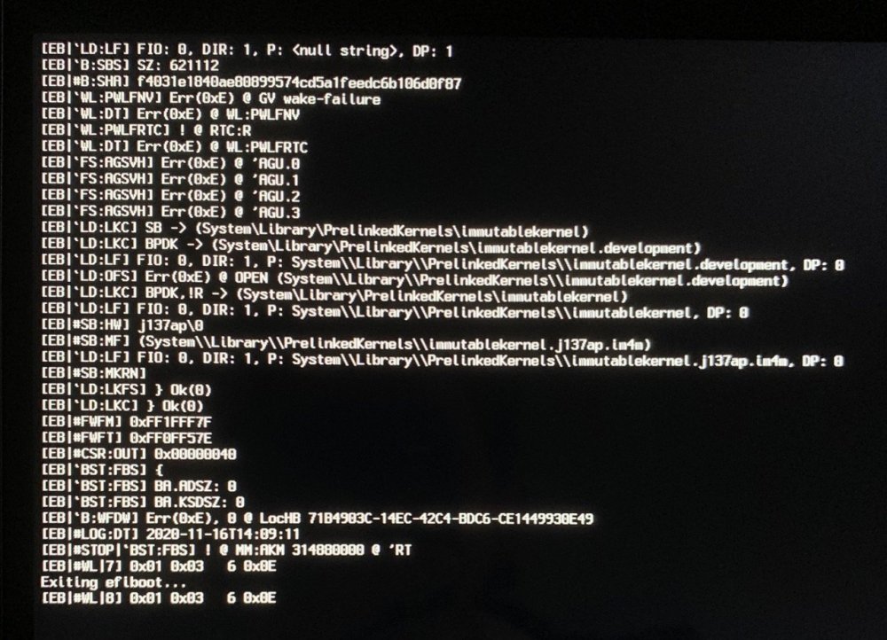

Navaira Posted November 16, 2020 Author Share Posted November 16, 2020 Hey Hervé, I got stuck with: Begin Gfx firmware load process [...] Hash data from ME never returned, status = 1, doing retry # Can you tell me what your boot-args and SMBIOS are? I'm on MacBookPro14,1 and boot-args: -v keepsyms=1 debug=0x100 -cdfon alcid=3 I saw advice to add -disablegfxfirmware to get rid of the Hash error, but the result is… see attachment. (Apparently it works for everyone else.) I think I'm disabling Intel, which leaves me with 0 GPUs. Awkward. Adding -wegnoegcpu results in the second screenshot. Which looks…good? I hear the sound that normally means the charger is attached and the login window about to appear (in Mojave), but, well, it doesn't appear. Would the 4K screen make a difference? I looked up your Latitude and it says it's a 1920x1080 display. Thank you for helping with this. Link to comment https://www.insanelymac.com/forum/topic/345757-fixed-lenovo-yoga-c930-8550uuhd-620-opencore-no-qeci-%E2%80%93%C2%A0worked-in-clover/#findComment-2744370 Share on other sites More sharing options...

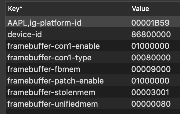

Navaira Posted November 16, 2020 Author Share Posted November 16, 2020 FIXED. I used this guy's config.plist Devices section and his boot args. The only thing I needed to do was replace 5916 with 591b in both platform-id and device-id. RESUUUUUULT!!!! Thanks for taking the time, Hervé 1 Link to comment https://www.insanelymac.com/forum/topic/345757-fixed-lenovo-yoga-c930-8550uuhd-620-opencore-no-qeci-%E2%80%93%C2%A0worked-in-clover/#findComment-2744386 Share on other sites More sharing options...
