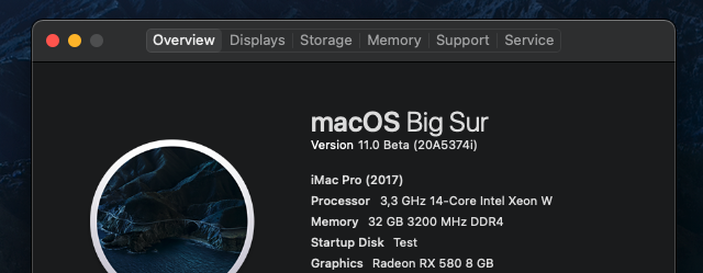

slurpi Posted September 27, 2020 Share Posted September 27, 2020 (edited) Hi everyone: This is to report a success (!) in installing macOS Big Sur Beta 6 (version 20A5364e) on my system MSI X299 SLI Plus with Intel i9 9940X using OpenCore 0.6.1. I followed the main OpenCore guide here: https://dortania.github.io/OpenCore-Install-Guide/ Make sure you look for the Skylake-X or HEDT sections. The SMBIOS is for the iMacPro1,1. There were two main issues that had to be taken care of: * I needed the kernel argument npci=0x2000 otherwise USB would not work. * I had to replace the precompiled SSDT-AWAC with my own RTC SSDT, as explained here:https://dortania.github.io/Getting-Started-With-ACPI/Universal/awac-methods/manual.html#rtc0-method The problem is that my SSDT does not have any AWAC to be patched. A sign that I needed this was that booting into the installer hanged around loading Lilu or some of the SMC extras. The path to replace in the provided SSDT-RTC0 is: ** PCI0 -> PC00 ** LPCB -> LPC0 This is probably specific to my motherboard. Instead of using the SSDT-AWAC, I use my own RTC0 like this: DefinitionBlock ("", "SSDT", 2, "ACDT", "RTC0", 0x00000000) { External (_SB_.PC00.LPC0, DeviceObj) // (from opcode) Scope (_SB.PC00.LPC0) { Device (RTC0) { Name (_HID, EisaId ("PNP0B00")) // _HID: Hardware ID Name (_CRS, ResourceTemplate () // _CRS: Current Resource Settings { IO (Decode16, 0x0070, // Range Minimum 0x0070, // Range Maximum 0x01, // Alignment 0x08, // Length ) IRQNoFlags () {8} }) Method (_STA, 0, NotSerialized) // _STA: Status { If (_OSI ("Darwin")) { Return (0x0F) } Else { Return (Zero) } } } } } Only the lines: External (_SB_.PC00.LPC0, DeviceObj) // (from opcode) Scope (_SB.PC00.LPC0) are different from the original SSDT-RTC0 here:https://github.com/acidanthera/OpenCorePkg/blob/master/Docs/AcpiSamples/SSDT-RTC0.dsl By following the guide above and implementing these two differences, I was able to install macOS Big Sur beta 6. Big thanks to the amazing OpenCore team for allowing this. Not only the complete tools, files, binaries, are fantastic, but the manual is amazing! Edited September 28, 2020 by slurpi extra info on the need for RTC 2 Link to comment https://www.insanelymac.com/forum/topic/345284-msi-x299-sli-plus-bigsur-beta-6-oc-061/ Share on other sites More sharing options...
slurpi Posted September 28, 2020 Author Share Posted September 28, 2020 Successful update from beta 6 to beta 8. Link to comment https://www.insanelymac.com/forum/topic/345284-msi-x299-sli-plus-bigsur-beta-6-oc-061/#findComment-2738640 Share on other sites More sharing options...
slurpi Posted October 2, 2020 Author Share Posted October 2, 2020 Successful update to beta 9. But I had to reset the NVRAM and also set SecureBootModel to Disabled in config.plist. Without this, the update would not download. 2 Link to comment https://www.insanelymac.com/forum/topic/345284-msi-x299-sli-plus-bigsur-beta-6-oc-061/#findComment-2739059 Share on other sites More sharing options...
slurpi Posted October 16, 2020 Author Share Posted October 16, 2020 Now on OC 0.6.2, but still on beta 9. Needed an update to config.plist, but only to avoid warnings from parsing at boot. 1 Link to comment https://www.insanelymac.com/forum/topic/345284-msi-x299-sli-plus-bigsur-beta-6-oc-061/#findComment-2740714 Share on other sites More sharing options...
