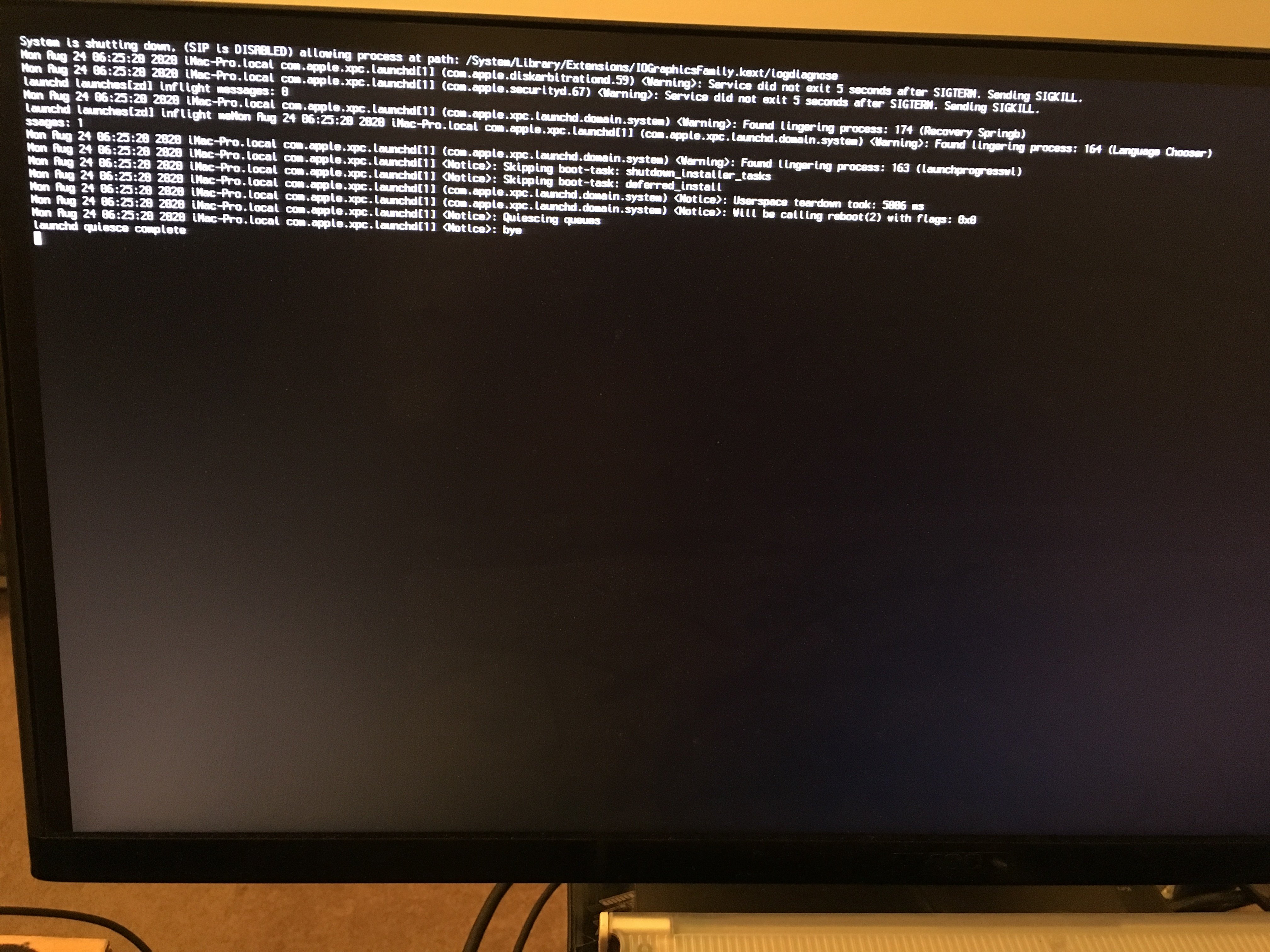

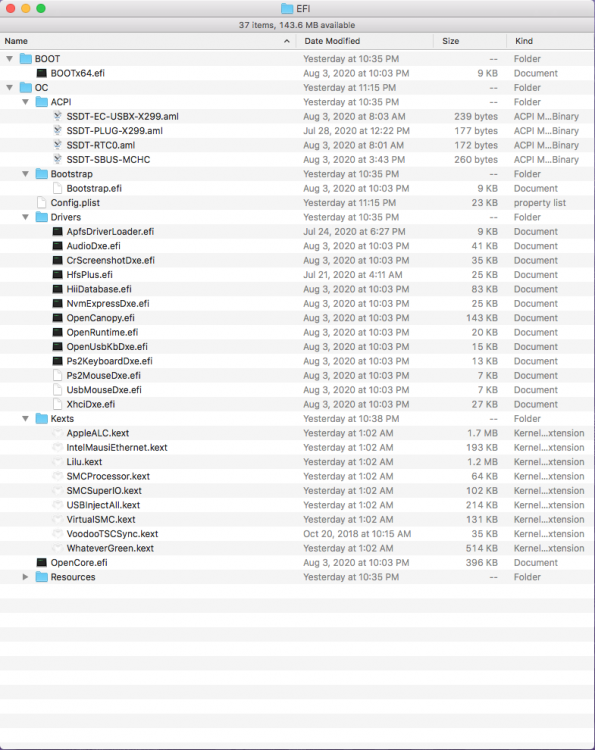

macattackjack Posted August 24, 2020 Share Posted August 24, 2020 (edited) I finally got an OC EFI that boots the BS Beta 4 on my Asus Prime X299-A Mobo, i7-9800X, EVGA GT710 GPU. Installer comes up, all good. Starts installing. Then quits at the 12 minute mark, and I get this screen. Not only does the computer not restart without hitting the reset button on the motherboard, but it keeps other OS on a different drive from restarting until I reset the NVRAM. I tried a few variations on the config list, but as I am new to OC, I don't want to poke around without knowing what I'm doing. But it seems to me a bunch of services aren't working properly. Also, VooDooTSCSync, was an old version that requires setting the threat count. The current version, that auto reads it, works fine. Attached is a pic of my EFI files and the configConfig.plist Any thoughts? Edited August 24, 2020 by macattackjack Link to comment Share on other sites More sharing options...

macattackjack Posted August 27, 2020 Author Share Posted August 27, 2020 Maldon also has what I believe is a system image. When I use the OC EFI from the flash installer, the system goes through the complete Verbose logging, but instead of the desktop, the screen goes black and the composer crashes. It really doesn't like something, but there's no way to fiddle around with the settings the way you can with Clover. Link to comment Share on other sites More sharing options...
macattackjack Posted August 27, 2020 Author Share Posted August 27, 2020 SOLVED: I delete alcid=1 and ncpi=0x2000 from the boot arguments, and it worked. It shuts down properly and the system boots. However, I think because I don't know if I formatted the SSD correctly because the first time the copy failed. But second time worked, but in the Opencore Boot menu it shows "Preboot" as the volume, not MacHD the drive name. I am going to try installing from the Flash drive again and see what happens, but in the meant time, here's the working OC folder from the EFI Folder. The whole EFI went over the file size limit. OC.zip Link to comment Share on other sites More sharing options...
