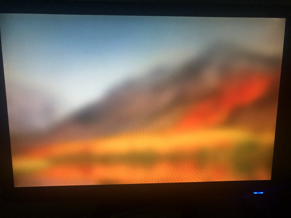

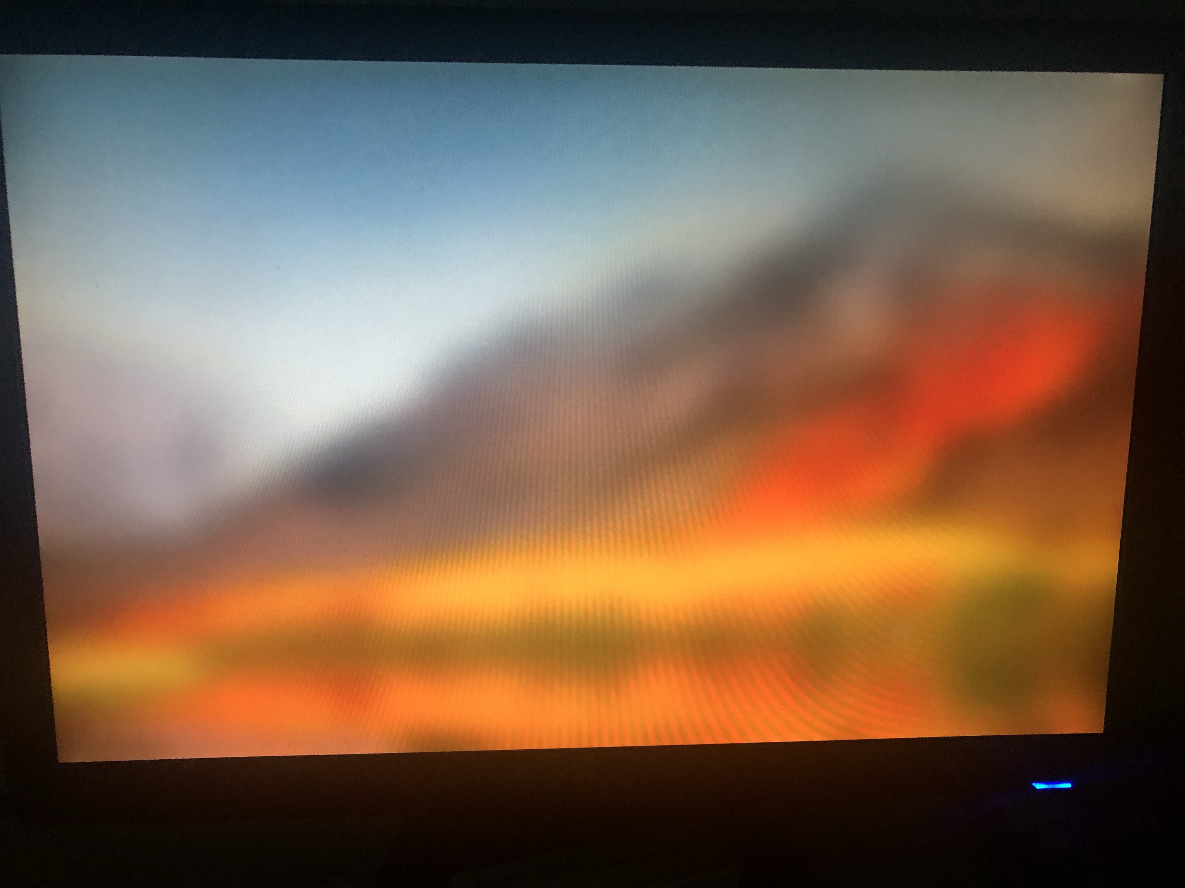

Just now, xKaoSx said:
Thank you @MacNB I am try this config and SSDT problem solved.
But I have a new problem. Computer starting and macOS booting. Lock Screen is black and only mouse. Graphic card is ok with fan normally.

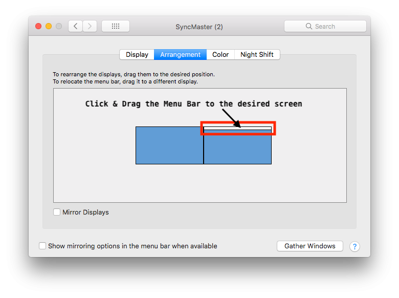

BTW, if you have two screens and you wish to change which one becomes the default Login screen then you can do that from System Preferences->Display setting:
You click on the menu bar in the above screen and drag that menu bar to the desired screen (e.g. the one adjacent) and then that screen will have the login screen and dock by default on boot.

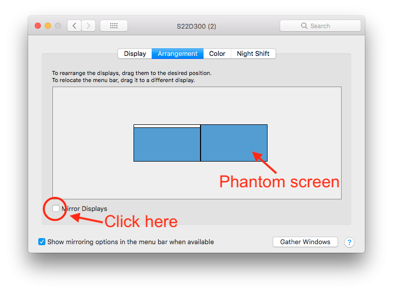

Thanks! I have only one screen connected with VGA but i can see two screen in macOS. There aren't any way to disable the other inexistent monitor?
As I said in the OC thread, GeForce 2xx series GPU's only really supported two outputs.
The VGA output is a mirror of either the HDMI or the DVI depending on the manufacturer.
So it appears as if the VGA connector is working.
And since it is mirroring HDMI, the mirror screen appears.
It may be possible to eliminate the "ghost screen". Do some search.

So I found a VGA monitor in my attic and tried a SINGLE VGA monitor on my GT240 to reproduce the problem you are having.

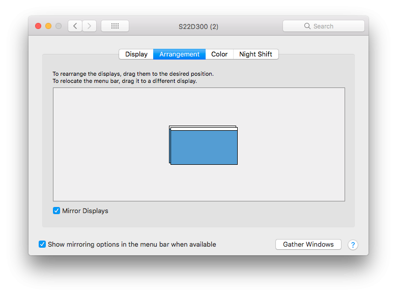

A workaround is to MIRROR the phantom screen:
Once you click "Mirror Displays", you will see:
Your mouse will now stay within the screen boundary only.
WARNING: While this workaround works fine, I then plugged in my second HDMI monitor and the system CRASHED !
@MacNB Thank you so much for going up to the attic to get the old monitor to test the connector for me. In the end the cleanest and most stable thing is to buy another DVI cable, because with the active duplication the performance of the GPU was worse. Now everything works great, thank you very much.
