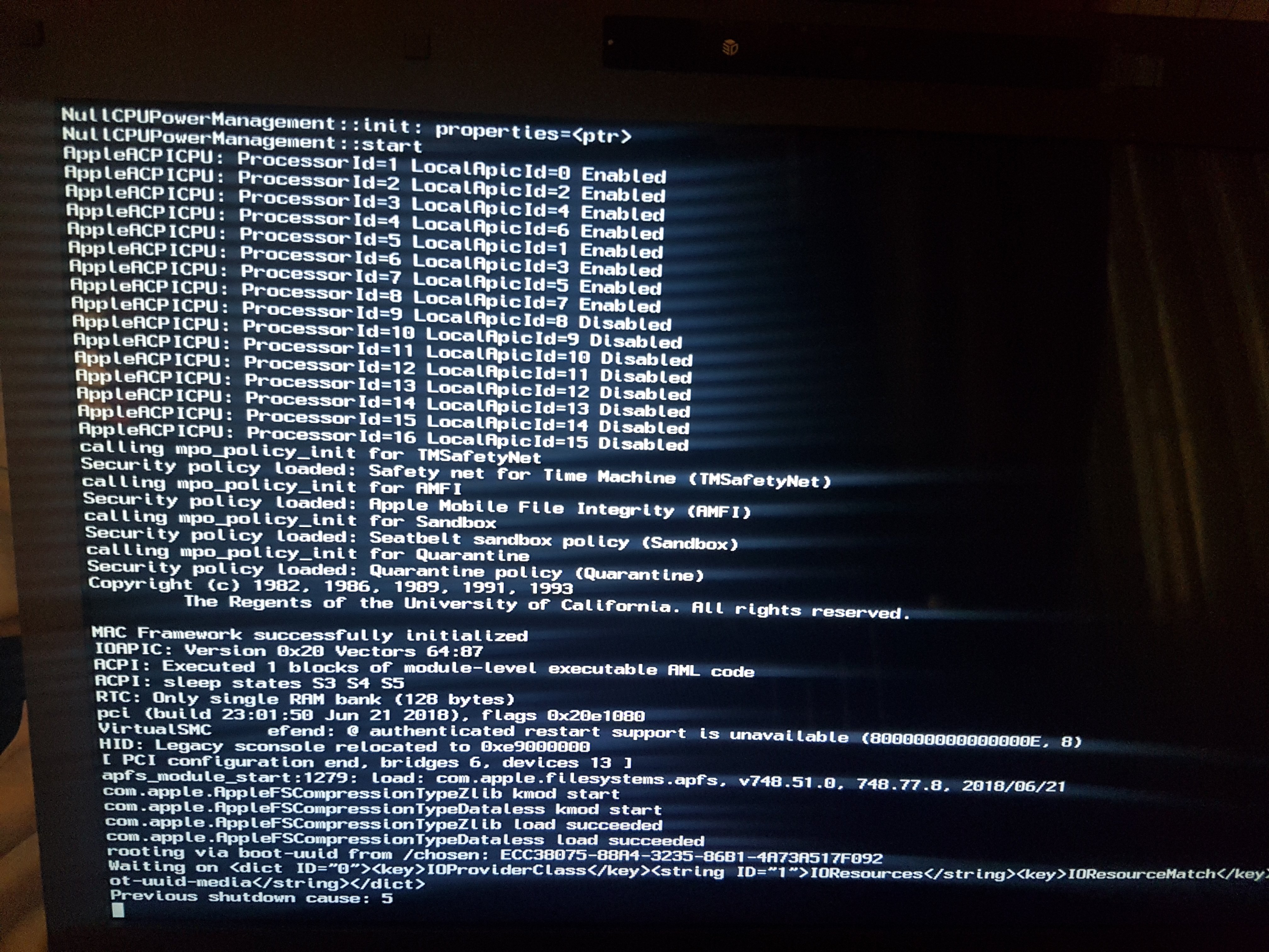

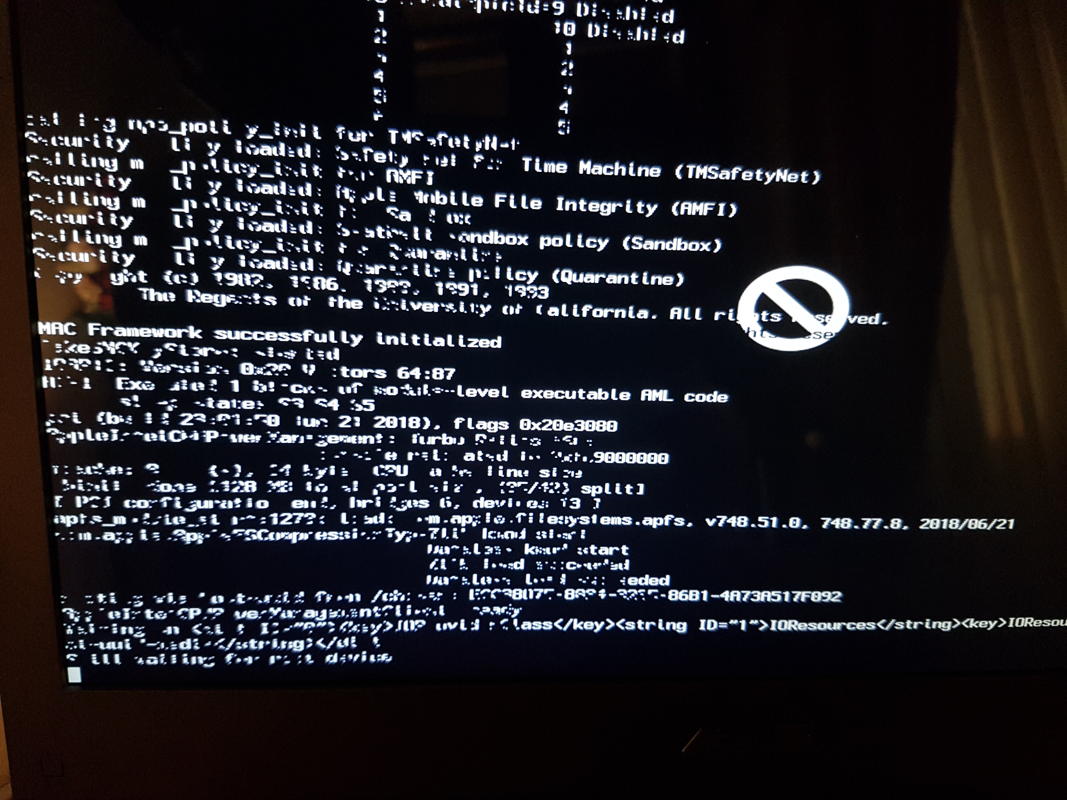

LuisImpreza Posted June 16, 2020 Share Posted June 16, 2020 (edited) Hey, good afternoon, everybody, First of all, I want to thank all the colleagues who every day make this forum the biggest in the world, really, thank you all. Currently I have a problem with my laptop, it is an Asus G74SX that in the firm can see all the details. I have tried more than 8 or 10 config.plist files to be loaded in clover, without success, it is never able to reach the installation window of High Sierra, actually I managed to install some time ago "Captain" but I need to start working with High Sierra, it is very good operating system and also, it still has compatibility with Nvidia graphic cards. Please help me to see if I can finally enjoy my laptop and make everything work for real, because I have never been able to make everything work as if it were an original equipment. I leave images of the errors so you can see them more easily. With all my heart, thank you very much! Edited June 25, 2020 by LuisImpreza Insert img Link to comment https://www.insanelymac.com/forum/topic/344179-impossible-to-install-high-sierra-in-laptop-asus-g74sx-configure-capit%C3%A1n-perfect-full-for-asus-g74sx/ Share on other sites More sharing options...

LuisImpreza Posted June 16, 2020 Author Share Posted June 16, 2020 40 minutes ago, Hervé said: In that case, stick to El Capitan; you won't be able to run Sierra or High Sierra on this laptop with Fermi graphics. If your dGPU is on an MXM-B (3.0) module, you may be able to consider swapping it out for a Kepler module if that is at all supported on the laptop. If it were, given that Kepler graphics are supported OOB from Sierra to current Catalina (Mojave and Catalina only support nVidia cards of the Kepler generation, nothing else), you could consider one of those Kepler MXM-B (3.0) modules. There are also Kepler MXM-A and Kepler 2.0 MXM-A modules too but I can't remember if they can be interchanged (I think they can). I've read that some of those Kepler MXM models can be obtained for very cheap (eg: Quadro K610M). It's a real shame, because the graphics card that this laptop has, is very powerful and also with 3D technology, which I like very much and I use it. In that case, I'll stay with the captain, the problem comes from the fact that I don't know how to make a SSDT or DSDT file in order to make all the components of my laptop work 100%. To know which exact KEXT files I need and not to include junk kext that are not useful. Could you help me out, Hervé? The files are extracted in the zip, because I pressed F4 in clover before sharing with you. I can change the title of the post if you want. Thank you very much indeed. Link to comment https://www.insanelymac.com/forum/topic/344179-impossible-to-install-high-sierra-in-laptop-asus-g74sx-configure-capit%C3%A1n-perfect-full-for-asus-g74sx/#findComment-2725869 Share on other sites More sharing options...
