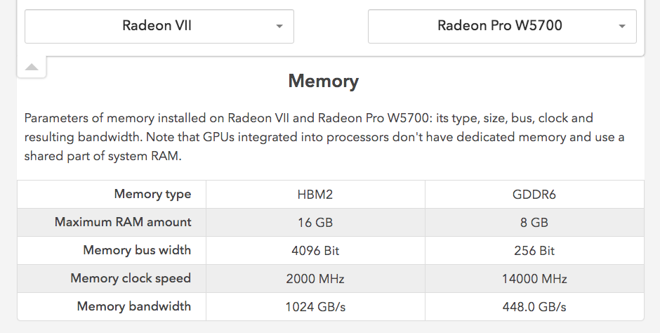

anannyo Posted June 5, 2020 Author Share Posted June 5, 2020 Hey @AudioGod, I will love your thoughts on the GPU that I should go for between this 2: RADEON PRO W5700 vs RADEON VII The price difference is only $100 between these 2 and I will use this build for video editing and rendering. I am leaning towards RADEON VII as it has 16GB HMB2 memory compared to 8 GB GDDR6 memory; and RADEON VII has 4096 Bit memory bus width compared to 256 Bit. I attached the memory difference screenshot for your reference; I would love to know your thoughts. Link to comment Share on other sites More sharing options...
AudioGod Posted June 5, 2020 Share Posted June 5, 2020 7 minutes ago, anannyo said: Hey @AudioGod, I will love your thoughts on the GPU that I should go for between this 2: RADEON PRO W5700 vs RADEON VII The price difference is only $100 between these 2 and I will use this build for video editing and rendering. I am leaning towards RADEON VII as it has 16GB HMB2 memory compared to 8 GB GDDR6 memory; and RADEON VII has 4096 Bit memory bus width compared to 256 Bit. I attached the memory difference screenshot for your reference; I would love to know your thoughts. Yup I agree with you there, if your doing video editing then the Radeon VII is your best choice. That or you wait until Big Navi is released but that might not be for a while. 1 Link to comment Share on other sites More sharing options...
