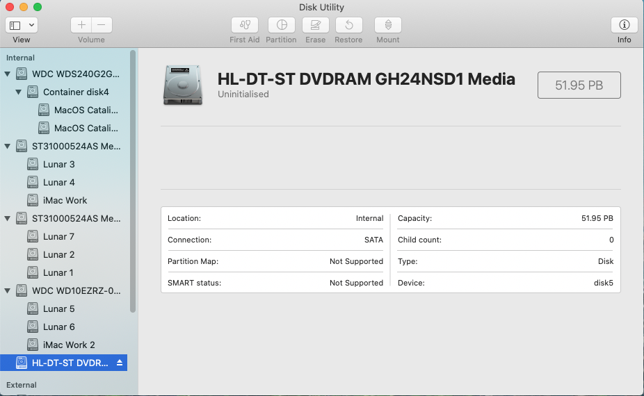

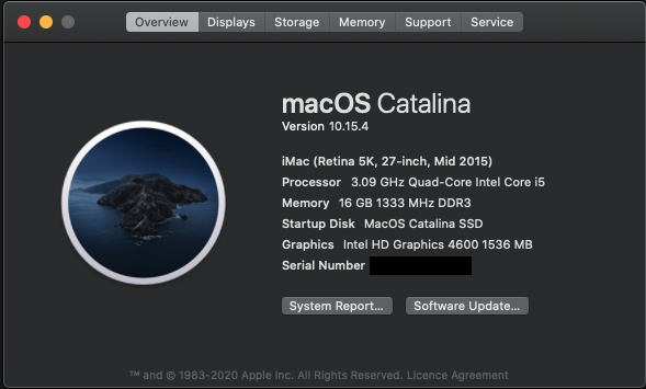

Everything is working except the DVD Drive. After every boot, a window pop's up saying the disk is uninitialized and ejects the tray.
So I took a look inside the disk utility and it is saying that the drive capacity is 51.95 Peta Byte  :surprised:   :wallbash:
I tried the DVD drive in windows and it worked correctly and it was working fine in macOS HS and Sierra I didn't have to install any additional drivers or kext for it to work
Does anyone know what's happening?
Would this affect my HDD and SSD in some way?
