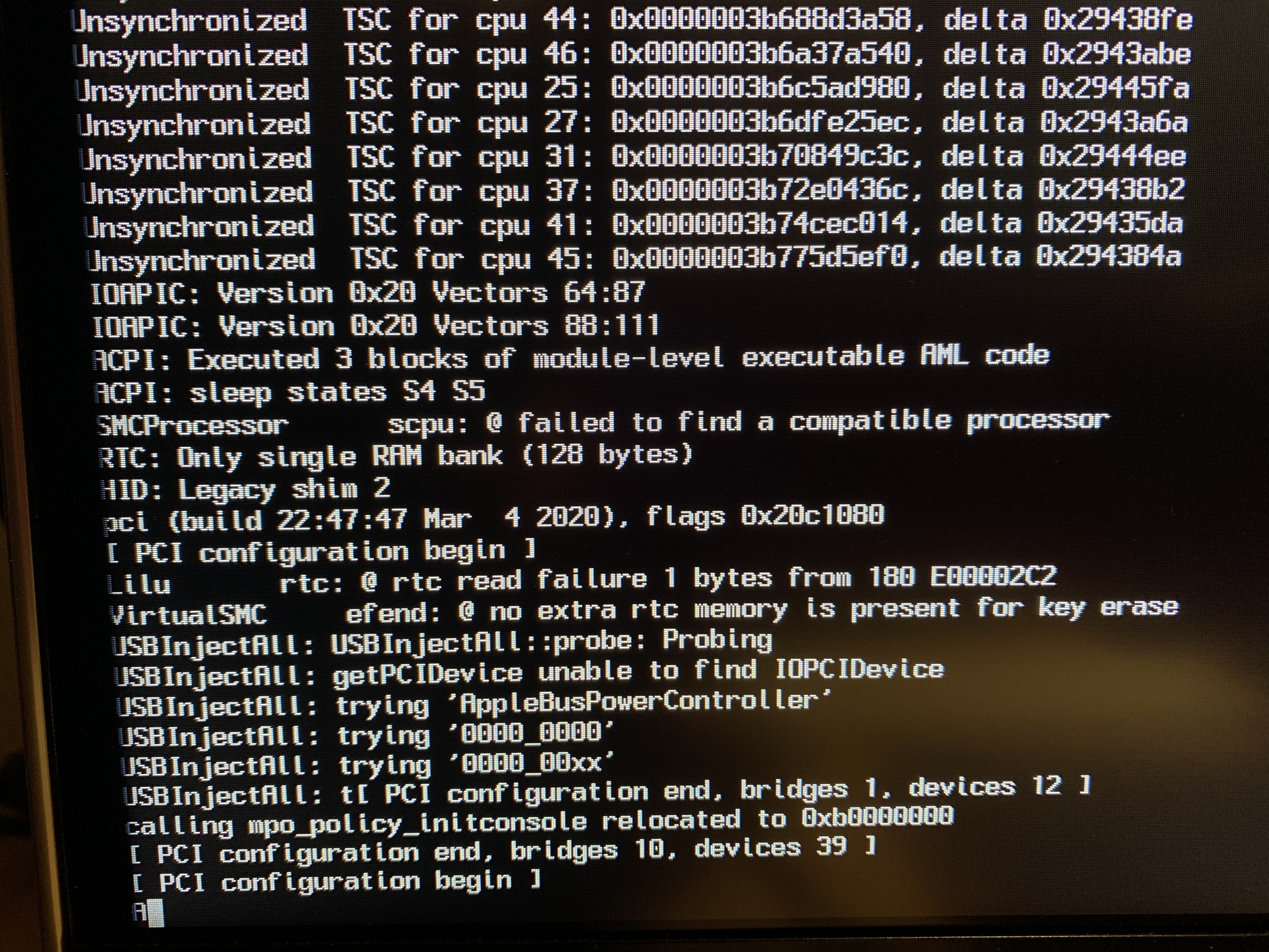

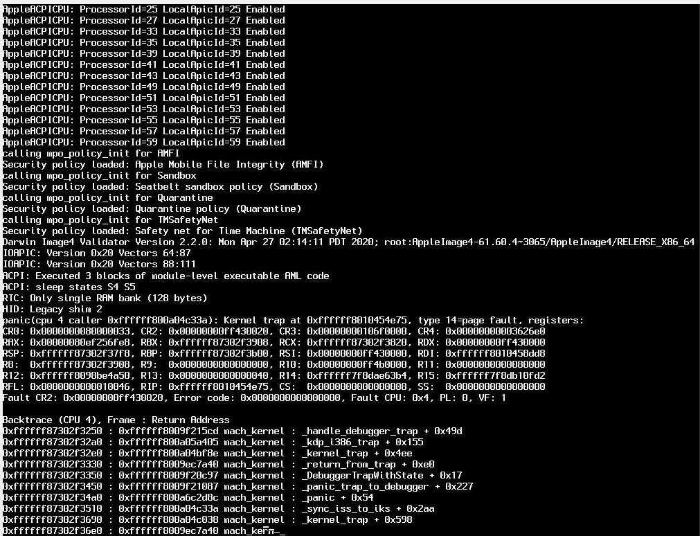

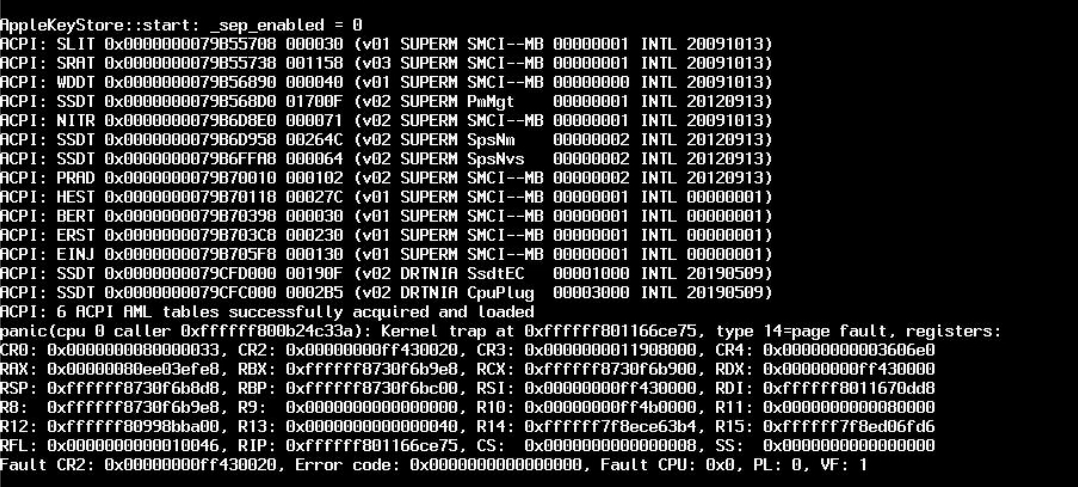

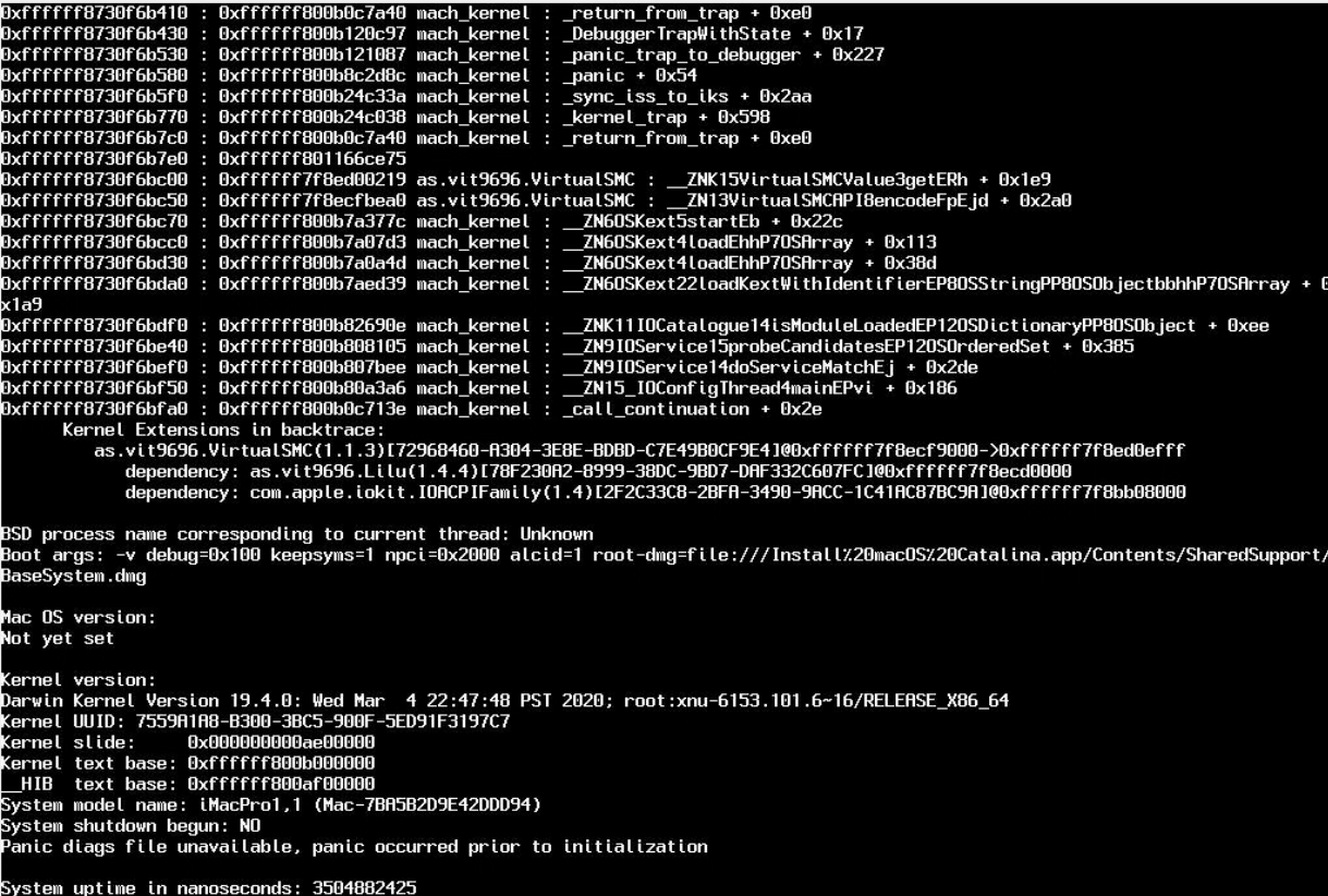

alvarolb Posted May 21, 2020 Share Posted May 21, 2020 Hi! I am new to Hackintosh, and have been trying to install macOS Catalina in my Dual Xeon (E5-2650v4) on a Supermicro X10DRL-i , without success at this moment (I think this is the worst start for a beginner ). I have followed the guide from OpenCore 0.5.8 for a Broadwell-E. I can get the OpenCore boot menu to install macOS, but then it hangs in the process. The reported error is the following, but I cannot get any idea what is failing here. Any help? DSDT_supermicro.aml config.plist Link to comment https://www.insanelymac.com/forum/topic/343920-opencore-with-catalina-and-dual-xeon-on-supermicro-x10drl-i/ Share on other sites More sharing options...

alvarolb Posted May 21, 2020 Author Share Posted May 21, 2020 At this moment I am using the Aspeed VGA adapter on the motherboard. I know it is not compatible, so I have purchased a Saphire Radeon RX 580 that will arrive this week. In the meanwhile, I have disabled some kexts like SMCProcessor and SMCSuperIO, and it went better, at least it detects the CPU cores, but halts in another section (HID). I think that I cannot get further without the GPU... Link to comment https://www.insanelymac.com/forum/topic/343920-opencore-with-catalina-and-dual-xeon-on-supermicro-x10drl-i/#findComment-2723227 Share on other sites More sharing options...
alvarolb Posted May 23, 2020 Author Share Posted May 23, 2020 Now I have the Radeon 580 installed and the error seems to be the same. It actually stops on Only single RAM bank! Link to comment https://www.insanelymac.com/forum/topic/343920-opencore-with-catalina-and-dual-xeon-on-supermicro-x10drl-i/#findComment-2723497 Share on other sites More sharing options...
alvarolb Posted June 2, 2020 Author Share Posted June 2, 2020 Stil on this... this is a nightmare! I have been testing almost everyting. After disabling DevertualiseMmio I was able to run without those kernel panics. Then I also disabled USB3 from the motherboard, disabled my NVME attached to a PCI Express, use the back USB2 port. And it seems that I made some progress, but still with troubles. Any idea? Thanks. Link to comment https://www.insanelymac.com/forum/topic/343920-opencore-with-catalina-and-dual-xeon-on-supermicro-x10drl-i/#findComment-2724656 Share on other sites More sharing options...
