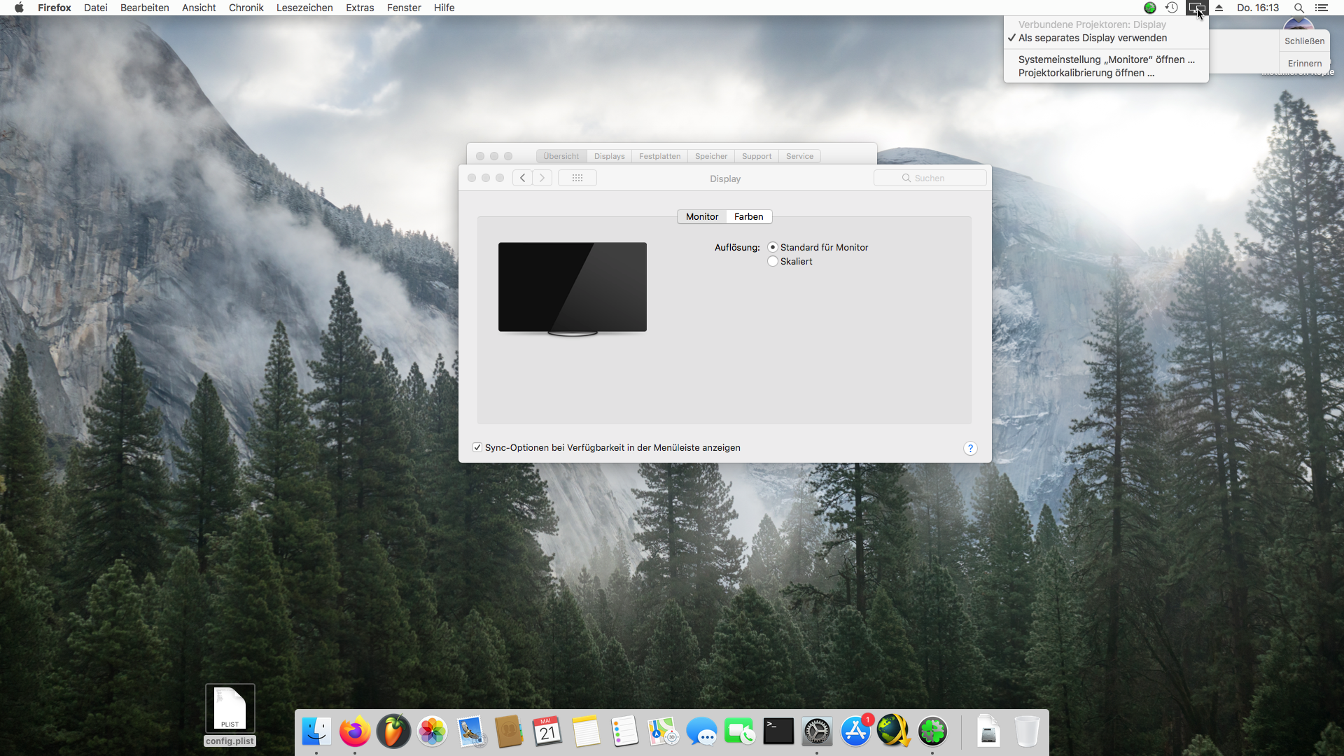

kraizee Posted May 21, 2020 Share Posted May 21, 2020 (edited) Hi folks, I am running a Hackintosh on my ASUS Prime z270m-plus desktop PC. My current OS X version is 10.13.6 High Sierra. Clover is v5.13.0.1 I'm trying to run a dualscreen setup but with no luck so far... My monitors are connected to HDMI & DVI of the intel GPU - no other GPU installed. I read several tutorials and forum discussions and tried some of them, i have to mention I'm no Hackintosh crack. All I tried is using different lg-platform-id but none of them worked, after trying 0x3E9B0007 as lg-platform-id I got another strange behavior, my second monitor is recognized as projector, and duplkicates the picture from the first screen. In monitor settings of OS X i can't see a second display connected, even if I try to search for connected devices. But I got an additional Icon with 2 monitors where I can calibrate the 'projector' or go to display settings but can't change anything. So I changed it back to "Skylake 17,1" e.g. 0x19120000... Lastly I used hackingtool to generate a second device - but I don't really understand what I'm doing there and so this also didn't work. Is there an easy and proper way to get this display recognized as a second display instead of a projector, or can someone explain the use of hackingtool for dummies please? don't know if it helps, in clover I set it as "iMac 17,1" because this iMac runs the same processor like in my hardware. except my processor is @3500MHz and the iMac runs @ 3200MHz... thanks in advance for any ideas how to fix this... Edited May 21, 2020 by kraizee Link to comment https://www.insanelymac.com/forum/topic/343919-i5-6600-integrated-graphics/ Share on other sites More sharing options...
Slice Posted May 26, 2020 Share Posted May 26, 2020 Try to use ig 0x193B0000. It is only frame containing HDMI. Link to comment https://www.insanelymac.com/forum/topic/343919-i5-6600-integrated-graphics/#findComment-2723793 Share on other sites More sharing options...
