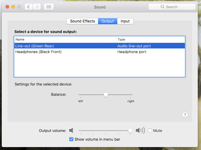

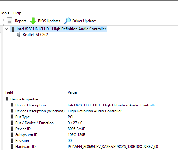

GoogleDNS Posted May 5, 2020 Author Share Posted May 5, 2020 (edited) @Rocky12 I follow your tips, without results... Lookin inside the files, i see some models of ALC, like 283, 269, 273 and others, but not my 262. Have another shot??? My ID in AIDA64 @edit: Holy s***, after waste a lot f*** time, I made it! Researching, I found a ancient VoodooHDA in other site, and edited info.plist with my true Device ID! its a 3A3E, not a 0262 HAHAHHAHAH!!! Puted kext in S/l/e, repaired permissions, rebooted and VOILAAAA! Audio Working, with Microphone and my front devices, very niceeee! Now, I will edit my DSDT slowly, because I m noob yet , but I can enjoy my full work hackintosh !!! Thanks for you attention bro! Keep safe, fly low! Cheers! Edited May 6, 2020 by GoogleDNS Link to comment https://www.insanelymac.com/forum/topic/343676-enable-audio-in-workstation-hpz800-realtek-alc-262/#findComment-2721136 Share on other sites More sharing options...
