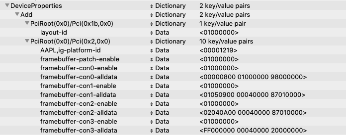

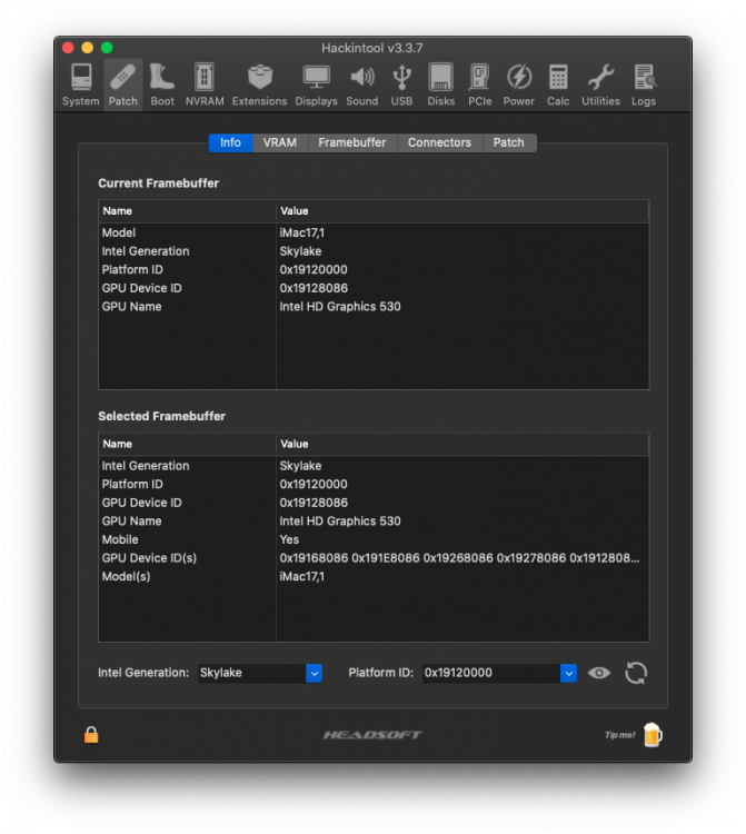

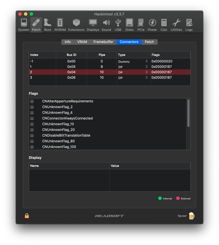

lukeylad118 Posted April 9, 2020 Share Posted April 9, 2020 (edited) Installed Catalina 10.15.4 (19E287) Vanilla with OpenCore on my HP Elitedesk 800 G2 Mini. Everything is working (Wifi isn't but I'm using Ethernet anyway) but my second display. I'm trying to get them both connected via DisplayPort as the only other output on my computer is VGA. I've tried manually setting the framebuffer arguments, but I cannot get it to output to both displays. Yet if I unplug one and restart, it will use the other one just fine. Any help would be greatly appreciated. HP800G2-Mini.iojones EFI.zip Edited April 9, 2020 by lukeylad118 Forgot to add tags Link to comment https://www.insanelymac.com/forum/topic/343350-hd-530-no-dual-screen-via-dp/ Share on other sites More sharing options...
