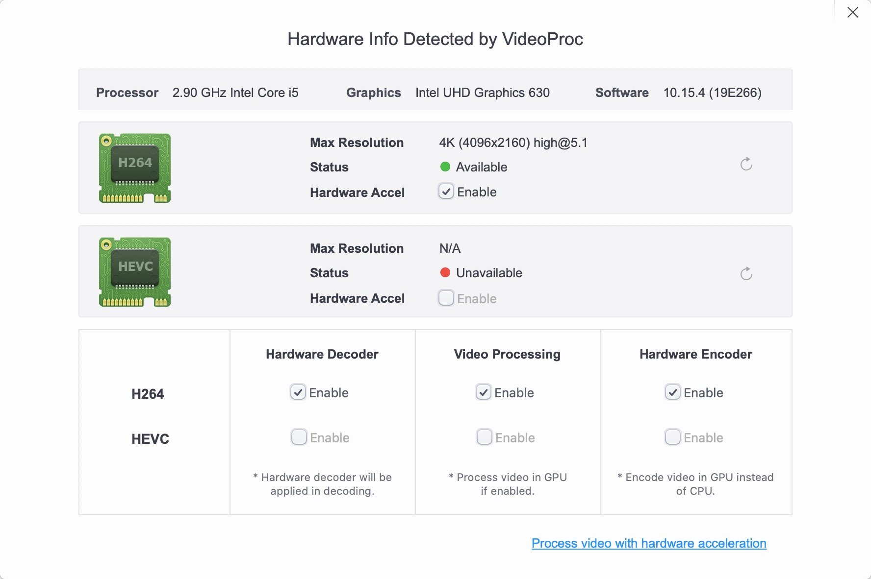

Barry_dhb52 Posted April 8, 2020 Share Posted April 8, 2020 (edited) VideoProc show HEVC not enabled. My hackintosh build: Motherboard: Asrock z370 itx gaming fatality CPU: i5 9400 GPU: iGPU UHD630 framebuffer platform-id: 0x3E9B0007 SMBIOS: Macmini8,1 macOS: 10.15.4 Bootloader:OpenCore 0.5.6 <?xml version="1.0" encoding="UTF-8"?> <!DOCTYPE plist PUBLIC "-//Apple//DTD PLIST 1.0//EN" "http://www.apple.com/DTDs/PropertyList-1.0.dtd"> <plist version="1.0"> <dict> <key>ACPI</key> <dict> <key>Add</key> <array> <dict> <key>Enabled</key> <true/> <key>Path</key> <string>SSDT-PLUG.aml</string> </dict> <dict> <key>Enabled</key> <true/> <key>Path</key> <string>SSDT-EC-USBX.aml</string> </dict> </array> </dict> <key>Booter</key> <dict> <key>Quirks</key> <dict> <key>AvoidRuntimeDefrag</key> <true/> <key>EnableWriteUnprotector</key> <true/> </dict> </dict> <key>DeviceProperties</key> <dict> <key>Add</key> <dict> <key>PciRoot(0x0)/Pci(0x2,0x0)</key> <dict> <key>AAPL,ig-platform-id</key> <data> BwCbPg== </data> </dict> </dict> </dict> <key>Kernel</key> <dict> <key>Add</key> <array> <dict> <key>BundlePath</key> <string>Lilu.kext</string> <key>Enabled</key> <true/> <key>ExecutablePath</key> <string>Contents/MacOS/Lilu</string> <key>PlistPath</key> <string>Contents/Info.plist</string> </dict> <dict> <key>BundlePath</key> <string>VirtualSMC.kext</string> <key>Enabled</key> <true/> <key>ExecutablePath</key> <string>Contents/MacOS/VirtualSMC</string> <key>PlistPath</key> <string>Contents/Info.plist</string> </dict> <dict> <key>BundlePath</key> <string>WhateverGreen.kext</string> <key>Comment</key> <string>Video card</string> <key>Enabled</key> <true/> <key>ExecutablePath</key> <string>Contents/MacOS/WhateverGreen</string> <key>PlistPath</key> <string>Contents/Info.plist</string> </dict> <dict> <key>BundlePath</key> <string>AppleALC.kext</string> <key>Comment</key> <string>Sound</string> <key>Enabled</key> <true/> <key>ExecutablePath</key> <string>Contents/MacOS/AppleALC</string> <key>PlistPath</key> <string>Contents/Info.plist</string> </dict> <dict> <key>BundlePath</key> <string>IntelMausi.kext</string> <key>Comment</key> <string>Intel Ethernet</string> <key>Enabled</key> <true/> <key>ExecutablePath</key> <string>Contents/MacOS/IntelMausi</string> <key>PlistPath</key> <string>Contents/Info.plist</string> </dict> <dict> <key>BundlePath</key> <string>USBPorts.kext</string> <key>Comment</key> <string>USB Customize</string> <key>Enabled</key> <true/> <key>ExecutablePath</key> <string></string> <key>PlistPath</key> <string>Contents/Info.plist</string> </dict> </array> <key>Quirks</key> <dict> <key>DisableIoMapper</key> <true/> <key>PanicNoKextDump</key> <true/> </dict> </dict> <key>Misc</key> <dict> <key>Boot</key> <dict> <key>HideSelf</key> <true/> <key>PickerMode</key> <string>Builtin</string> <key>PollAppleHotKeys</key> <true/> <key>ShowPicker</key> <false/> <key>Timeout</key> <integer>10</integer> </dict> <key>Security</key> <dict> <key>AllowNvramReset</key> <true/> <key>AllowSetDefault</key> <false/> <key>AuthRestart</key> <false/> <key>ExposeSensitiveData</key> <integer>6</integer> <key>HaltLevel</key> <integer>2147483648</integer> <key>ScanPolicy</key> <integer>983299</integer> <key>Vault</key> <string>Optional</string> </dict> </dict> <key>NVRAM</key> <dict> <key>Add</key> <dict> <key>4D1EDE05-38C7-4A6A-9CC6-4BCCA8B38C14</key> <dict> <key>UIScale</key> <data> Ag== </data> </dict> <key>7C436110-AB2A-4BBB-A880-FE41995C9F82</key> <dict> <key>boot-args</key> <string>debug=0x100 keepsyms=1 alcid=11</string> <key>csr-active-config</key> <data> AAAAAA== </data> </dict> </dict> </dict> <key>PlatformInfo</key> <dict> <key>Automatic</key> <true/> <key>Generic</key> <dict> // rip off per machine info </dict> <key>UpdateDataHub</key> <true/> <key>UpdateNVRAM</key> <true/> <key>UpdateSMBIOS</key> <true/> <key>UpdateSMBIOSMode</key> <string>Create</string> </dict> <key>UEFI</key> <dict> <key>ConnectDrivers</key> <true/> <key>Drivers</key> <array> <string>AppleUsbKbDxe.efi</string> <string>ApfsDriverLoader.efi</string> <string>HFSPlus.efi</string> <string>FwRuntimeServices.efi</string> </array> <key>Input</key> <dict> <key>KeyForgetThreshold</key> <integer>5</integer> <key>KeyMergeThreshold</key> <integer>2</integer> <key>KeySupport</key> <true/> <key>KeySupportMode</key> <string>Auto</string> </dict> <key>Output</key> <dict> <key>ProvideConsoleGop</key> <true/> <key>Resolution</key> <string>Max</string> </dict> <key>Protocols</key> <dict> <key>FirmwareVolume</key> <false/> </dict> <key>Quirks</key> <dict> <key>RequestBootVarRouting</key> <true/> </dict> </dict> </dict> </plist> Edited April 9, 2020 by Barry_dhb52 Link to comment https://www.insanelymac.com/forum/topic/343317-help-z370-i5-9400-videoproc-show-hevc-not-enabled-oc056/ Share on other sites More sharing options...
archer0269 Posted April 14, 2020 Share Posted April 14, 2020 SMBIOS: Macmini8,1 imac 19,1 Link to comment https://www.insanelymac.com/forum/topic/343317-help-z370-i5-9400-videoproc-show-hevc-not-enabled-oc056/#findComment-2717467 Share on other sites More sharing options...
