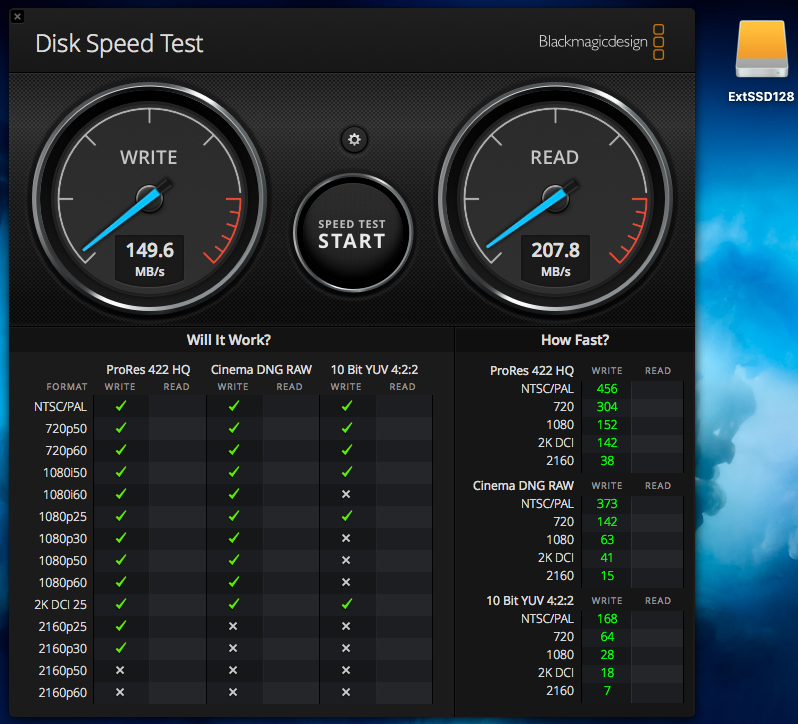

To get USB 3 working I got the kext for the NEC controller from https://github.com/chris1111/USB-3.0-NEC . The installer actually failed to place any kext on my system clover folder, so I run it on my trusty elitebook and then got the mXHCD kext from that clover folder. Speed on external SSD is 150 write and 200 read, the drive could reach 380 read on UASP mode but its still very nice to have.

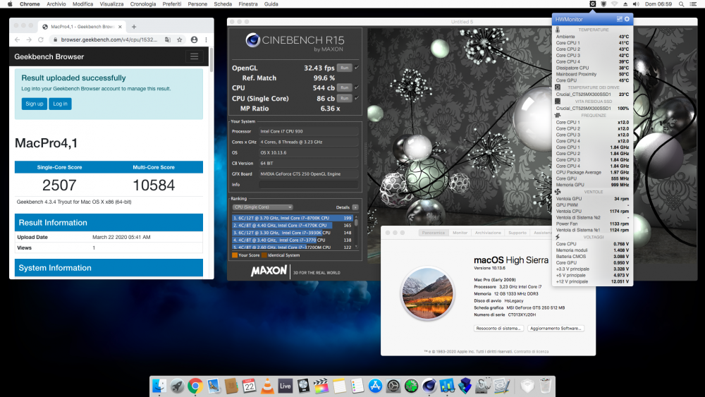

Since the cpu was stable at the lowest possible voltage offset I could select on BIOS, i decided to rise the fsb / BCLK a little bit. System started to act a bit weird around 140 mhz. I then started lowering the undervolt. I did set the RAM to run at 1.4 v at 10x multiplier (rated at 1600mhz at 1.7v). System became unstable because of RAM at around 155 mhz base (1550mhz ram, 3.3ghz CPU). I am testing stability mostly with automatic tools like PcMark 10 and Sandra on windows, since I have no similar long stress tools on macOs. This is giving me a very nice score of around 550 cinebench r15 multi core, actually same score on Windows . Geekebench 4 gives me a very low 2200 single but good 9600 multi > fixed with HPET 64bit options now getting 2500 single and 10500 multi. Temperatures are between 42c at idle (with C states enabled) and 60 on full load.

The whole system feels incredibly smooth (and smoother than on windows 10), i was not expecting this level of user experience, performance and efficiency with hardware that is 11 years old: the CPU is simply incredible also considered the low voltages it is able to operate ( 0.8vat 1.86ghz and 1.04 at the full 3.45ghz speed ). Sure i built some 9900k systems and they are fast, but they also run hotter and louder. Intel really is like microsoft, the bigger they become, the worst they get. I hope the rumors and code snippet in Catalina turn out in a proper Ryzen support very soon.
