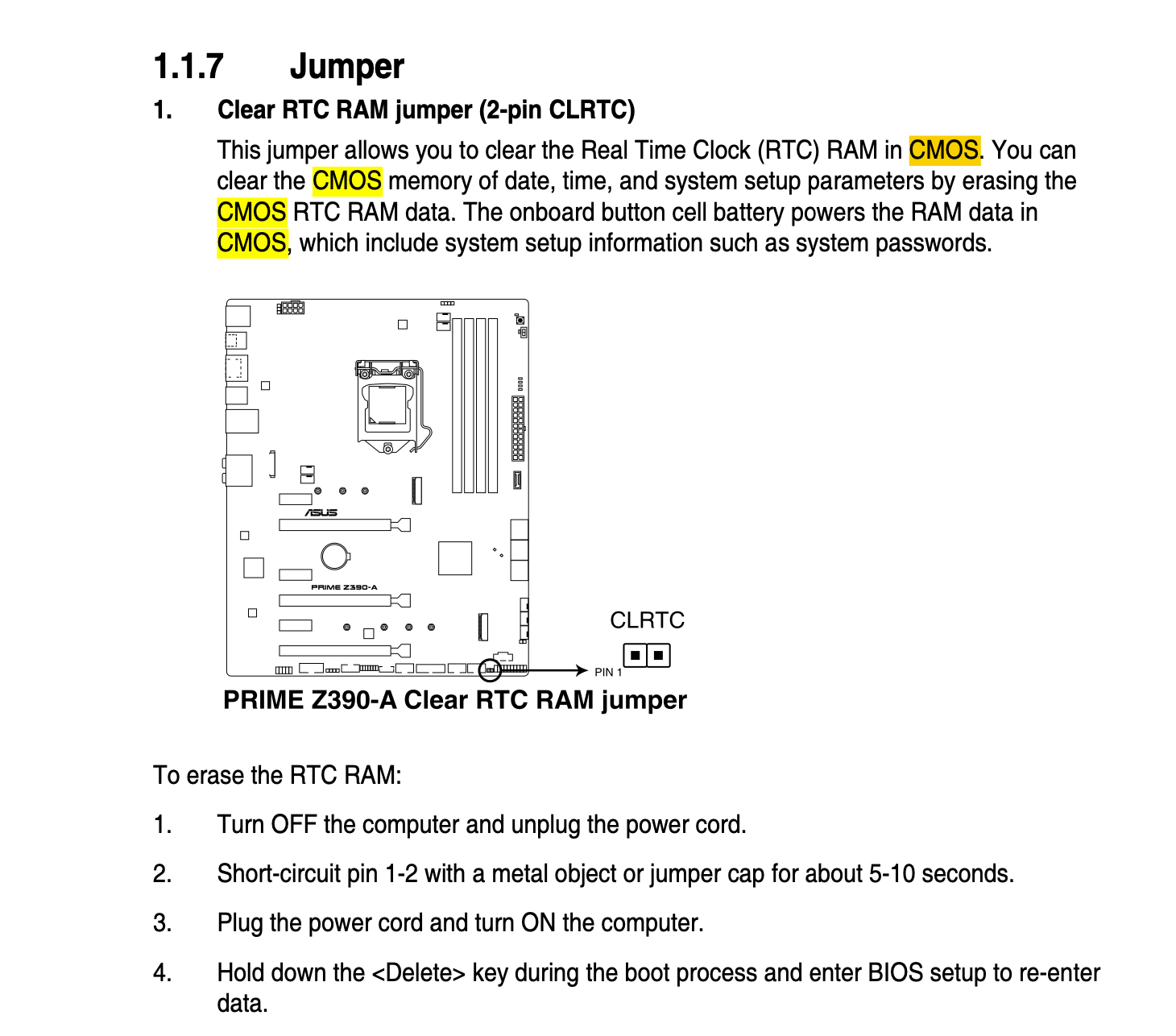

gader Posted February 12, 2020 Share Posted February 12, 2020 clear cmos from the back button of the motherboard? Link to comment https://www.insanelymac.com/forum/topic/342545-reboot-issue/#findComment-2708005 Share on other sites More sharing options...
FALLOFMAN Posted February 12, 2020 Author Share Posted February 12, 2020 4 minutes ago, gader said: clear cmos from the back button of the motherboard? Theres no clear cmos button on my mobo, what about the pins inside? Link to comment https://www.insanelymac.com/forum/topic/342545-reboot-issue/#findComment-2708006 Share on other sites More sharing options...
gader Posted February 12, 2020 Share Posted February 12, 2020 (edited) it should work this is from your board manual Edited February 12, 2020 by gader Link to comment https://www.insanelymac.com/forum/topic/342545-reboot-issue/#findComment-2708008 Share on other sites More sharing options...
FALLOFMAN Posted February 12, 2020 Author Share Posted February 12, 2020 27 minutes ago, gader said: clear cmos from the back button of the motherboard? 5 minutes ago, gader said: it should work this is from your board manual I jumped the pins but it didnt work so in the opencore menu I reset the NVRAM and that got me into the bios Link to comment https://www.insanelymac.com/forum/topic/342545-reboot-issue/#findComment-2708009 Share on other sites More sharing options...
