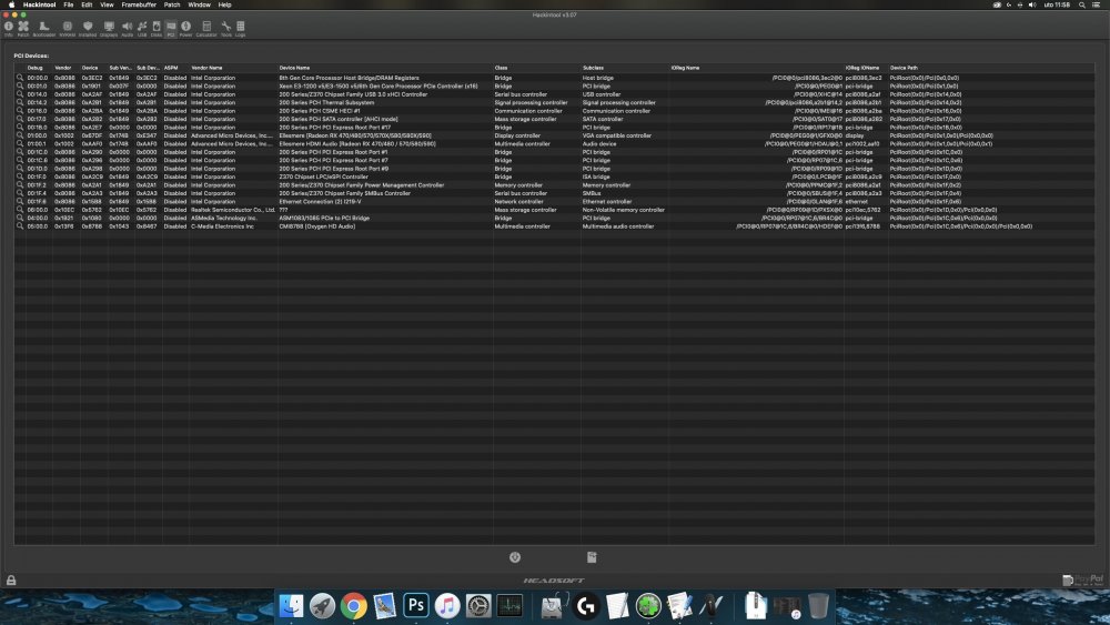

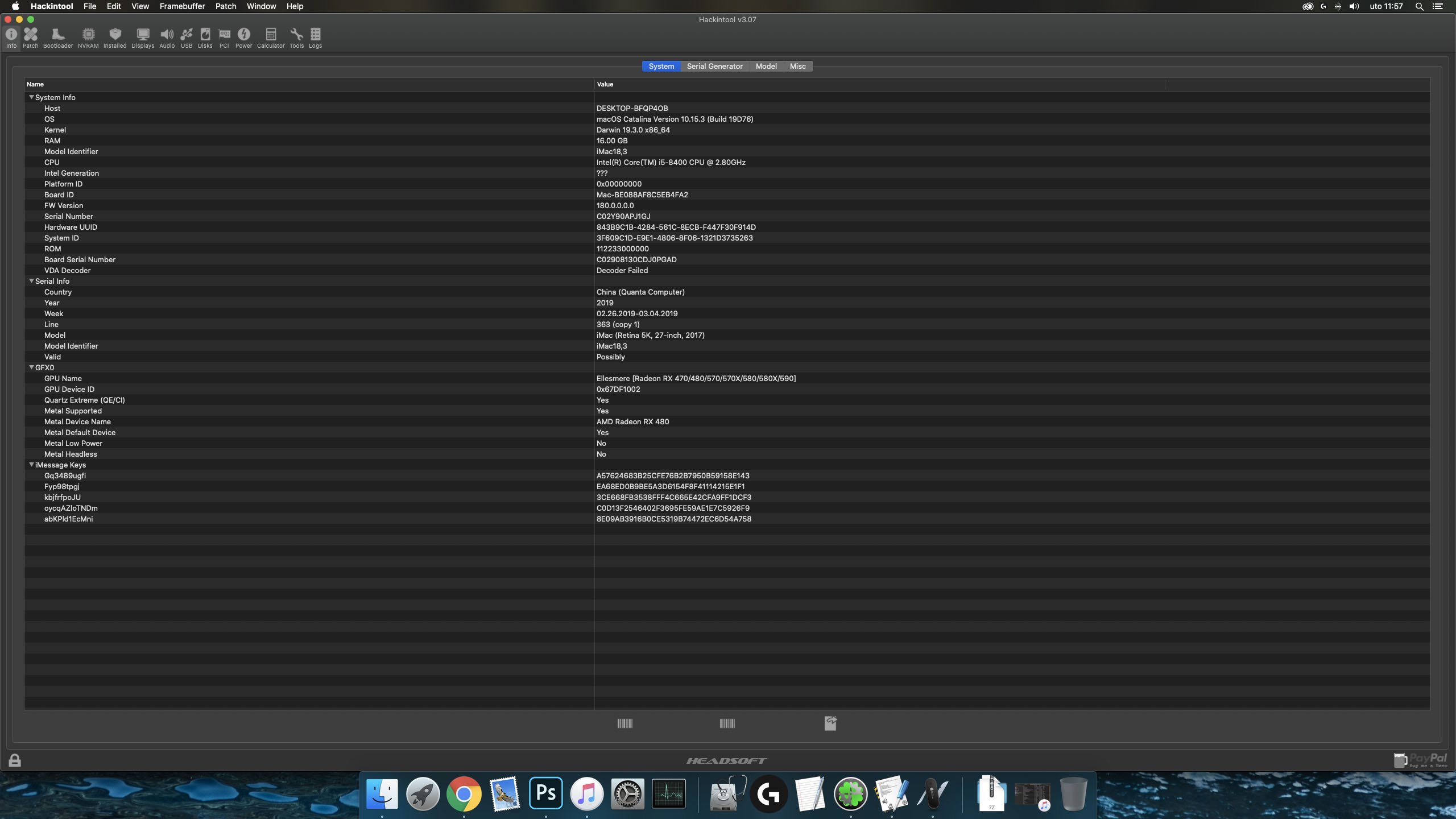

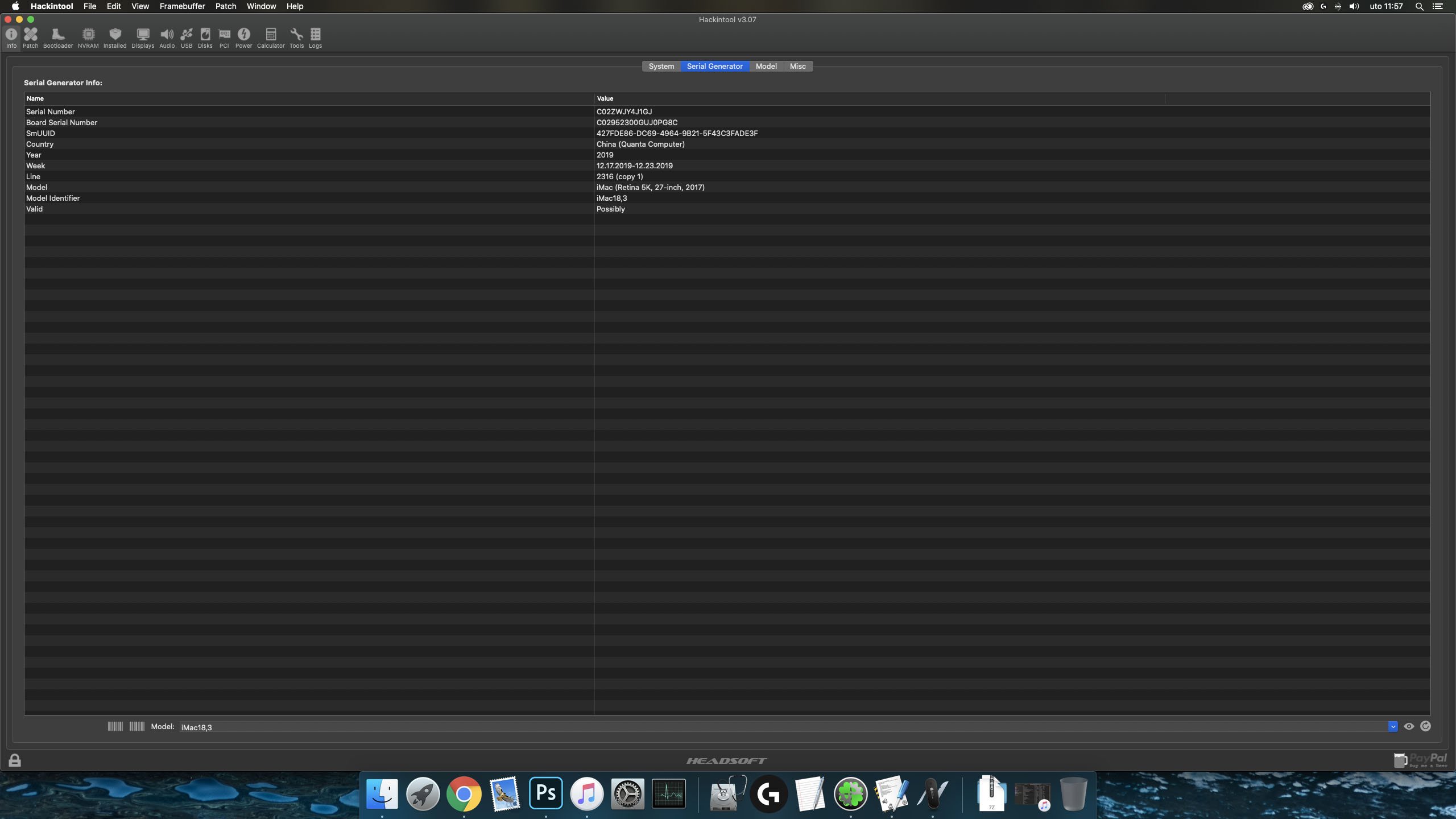

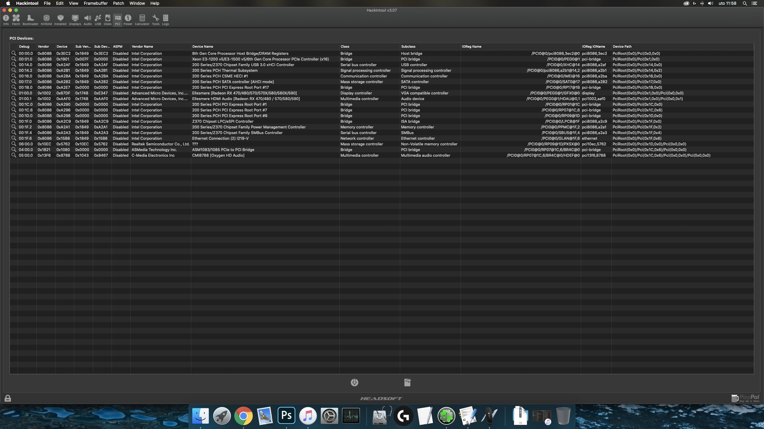

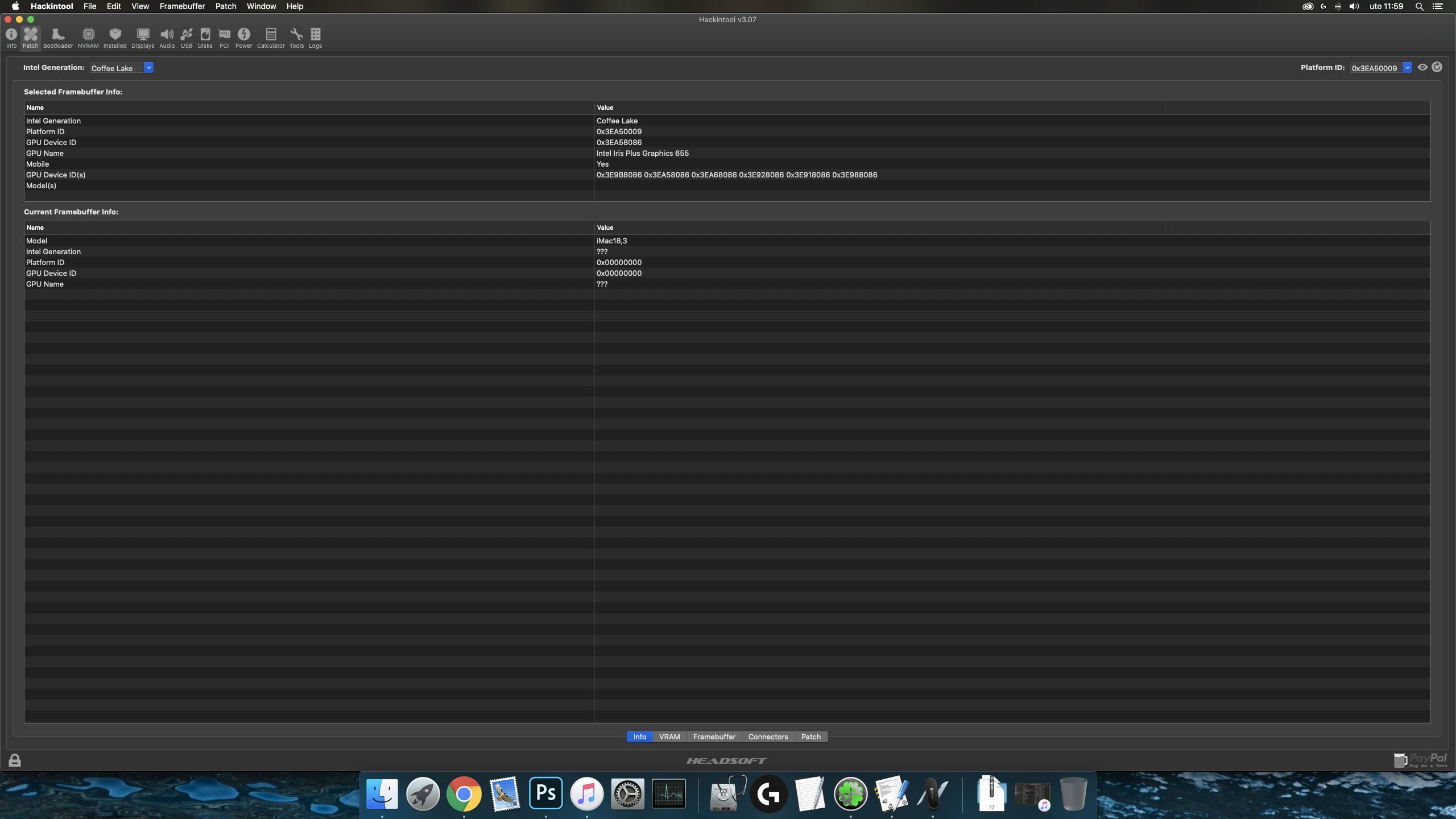

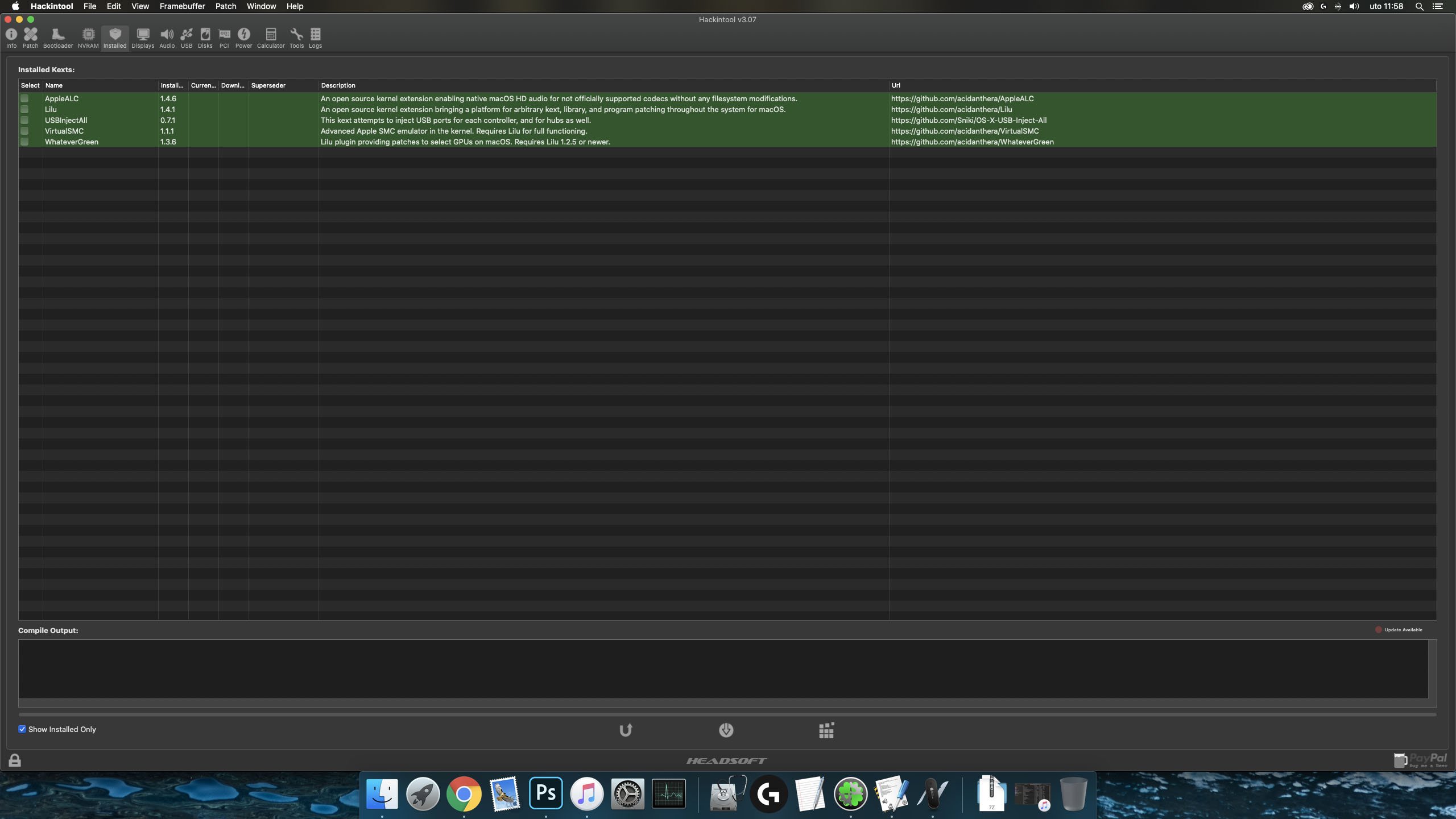

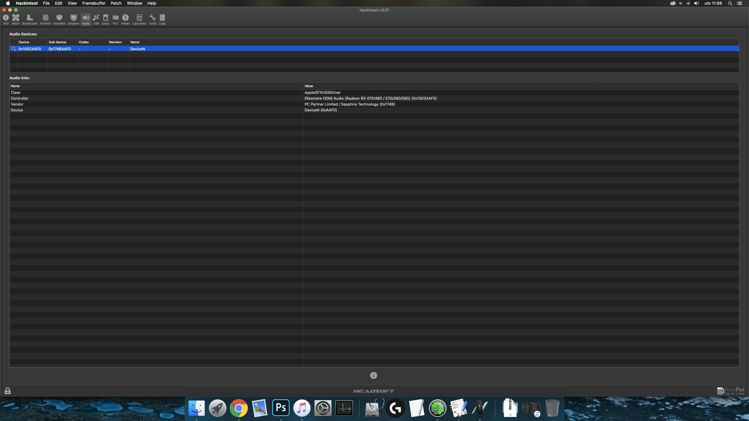

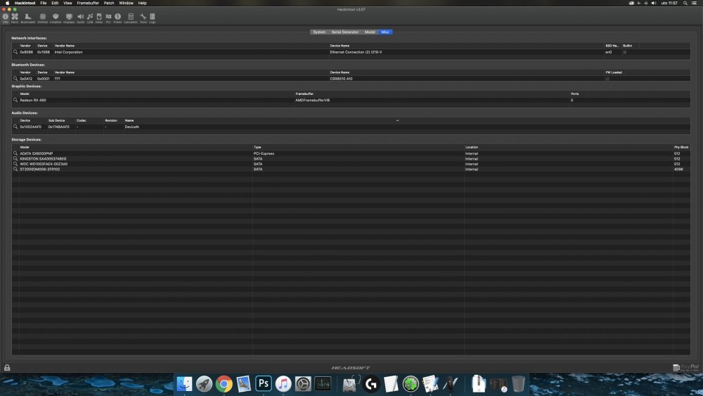

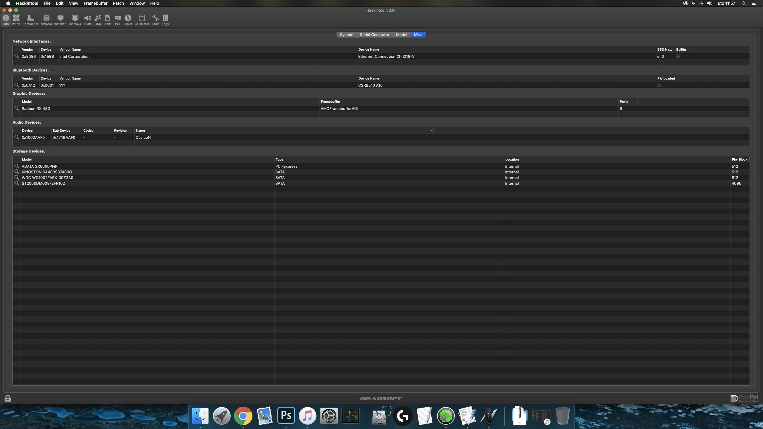

m_smrad Posted February 11, 2020 Share Posted February 11, 2020 Hi, this is my first macos install and I need some help to make it perfect. I read vanilla open core guide few times, and this is the best result so far. Specs: Asrock Z370 Pro4(ALC892) i5 8400 RX 480 16GB DDR4 Xonar DG(ignore, i guess there are no kexts) OpenCore Catalina 10.15.3 Good things: Geekbench scores seems good (almost 1000 sc and around 5000 mc in GB5, OpenCL really good too-RX 590 level) Dual monitor works fine, 1440p 75hz and 1080p 120hz Bluetooth dongle plug and play(using for sound unitil i fix alc892) Sleep works(few seconds to get into sleep, but works fine I guess) Dual boot(Windows bootcamp option) No errors in log(had nvdrv error but i deleted it from config) Problems: Audio does not work(device not even detected, see image), i tried different alcid but does not work Hackintool says VDA Decoder failed(do not know if i need to add igpu?) Other issues: Double click to resize on titlebar laggs on some apps(maybe normal for mac?) Photoshop liquify tool not as smooth as it should be(maybe a ps thing or my build?) Maybe there are more bad things, pls help. I added screens from hackintool and EFI folder. EFI.zip Link to comment https://www.insanelymac.com/forum/topic/342539-help-to-complete-my-build/ Share on other sites More sharing options...
m_smrad Posted February 11, 2020 Author Share Posted February 11, 2020 OK, so i fixed my sound. I have ASUS Xonar and in my bios onboard sound was set to automatic, i set it to enabled and it works now. So, now i just need some help to test the rest and fix above problems. Link to comment https://www.insanelymac.com/forum/topic/342539-help-to-complete-my-build/#findComment-2707856 Share on other sites More sharing options...
