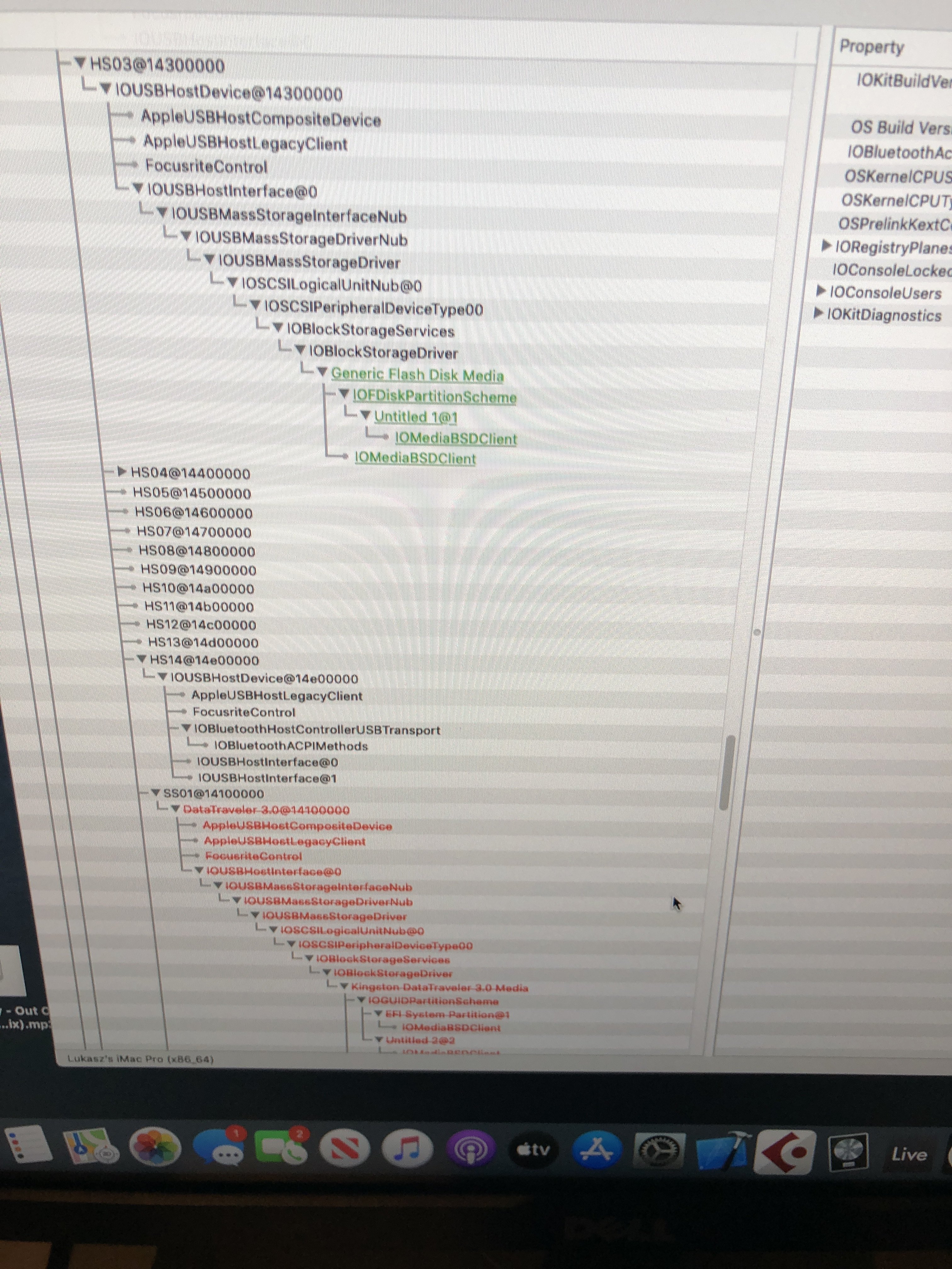

luki1979 Posted January 18, 2020 Share Posted January 18, 2020 (edited) I’m got new build based on ASRock Z370 Gaming ITX/AC. Basically When I plug USB 2.0 device in a certain port it shows as HS03 in the device tree but USB3.0 device in the same port shows as SS01 Driving me nuts Edited January 18, 2020 by luki1979 Link to comment https://www.insanelymac.com/forum/topic/342180-usb-hs-numbers-does-not-correspond-to-ss-ones/ Share on other sites More sharing options...
luki1979 Posted January 19, 2020 Author Share Posted January 19, 2020 Sorted. I had some bloody kext called XHCI-unsupported.kext and it was causing wrong enumeration of SS ports. HS01 was SS03, the same physical port. I’ve removed that kext and now HS01 is SS01 as it should be. Link to comment https://www.insanelymac.com/forum/topic/342180-usb-hs-numbers-does-not-correspond-to-ss-ones/#findComment-2704915 Share on other sites More sharing options...
