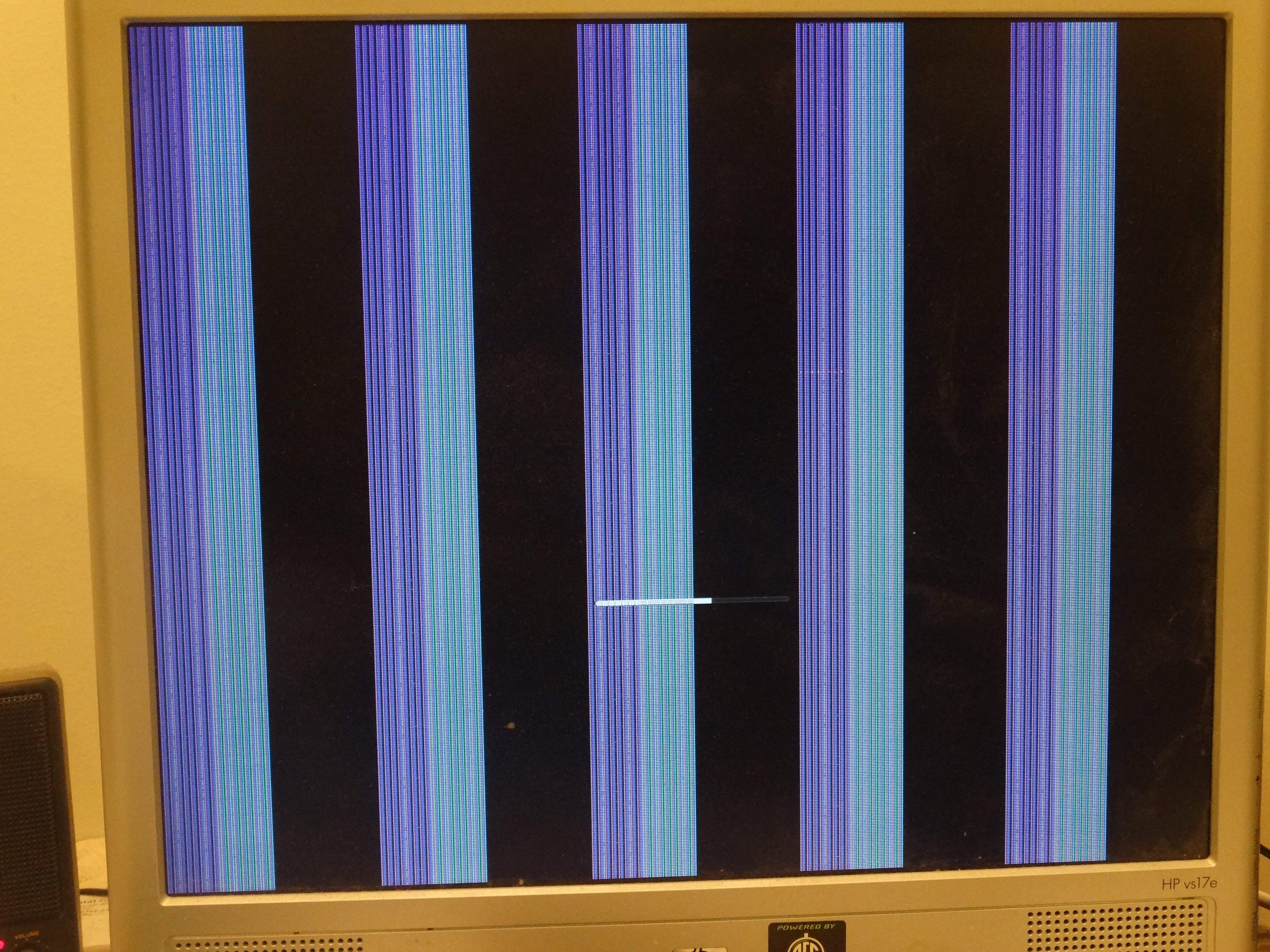

RePete222 Posted January 19, 2020 Author Share Posted January 19, 2020 22 hours ago, Slice said: Switch off verbose mode and boot with apple on screen. Tried that, and boy oh boy, what a mess that made! First couple of attempts resulted in a freeze just before the progress bar got all the way across. The DVI-connected monitor went dark, and the other monitor froze with vertical "noise" stripes down the screen. Some of that repeated after going back to the DVI-to-DP adapter, but I eventually got all the way in. On a later attempt through the DVI port, I booted a few times--even powering off/unplugging the PC for several minutes between attempts, just to find out whether it repeated. Most attempts did get the vertical-noise-stripes freeze; when I did make it all the way to the desktop, the DVI-connected monitor again went dark. After switching back to the DP adapter, I kept on getting the vertical noise stripes on both monitors, which kept coming back with each retry. Even the first couple attempts to boot from a rescue boot disk had the same problem! I FINALLY did manage to get the rescue boot to succeed, and am running on that system as I type this. I am attaching a screen shot to show an example of the vertical noise stripes mentioned above. Link to comment https://www.insanelymac.com/forum/topic/342123-dvi-d-port-of-rx570-gpu-not-working-monitor-detected/#findComment-2704898 Share on other sites More sharing options...
