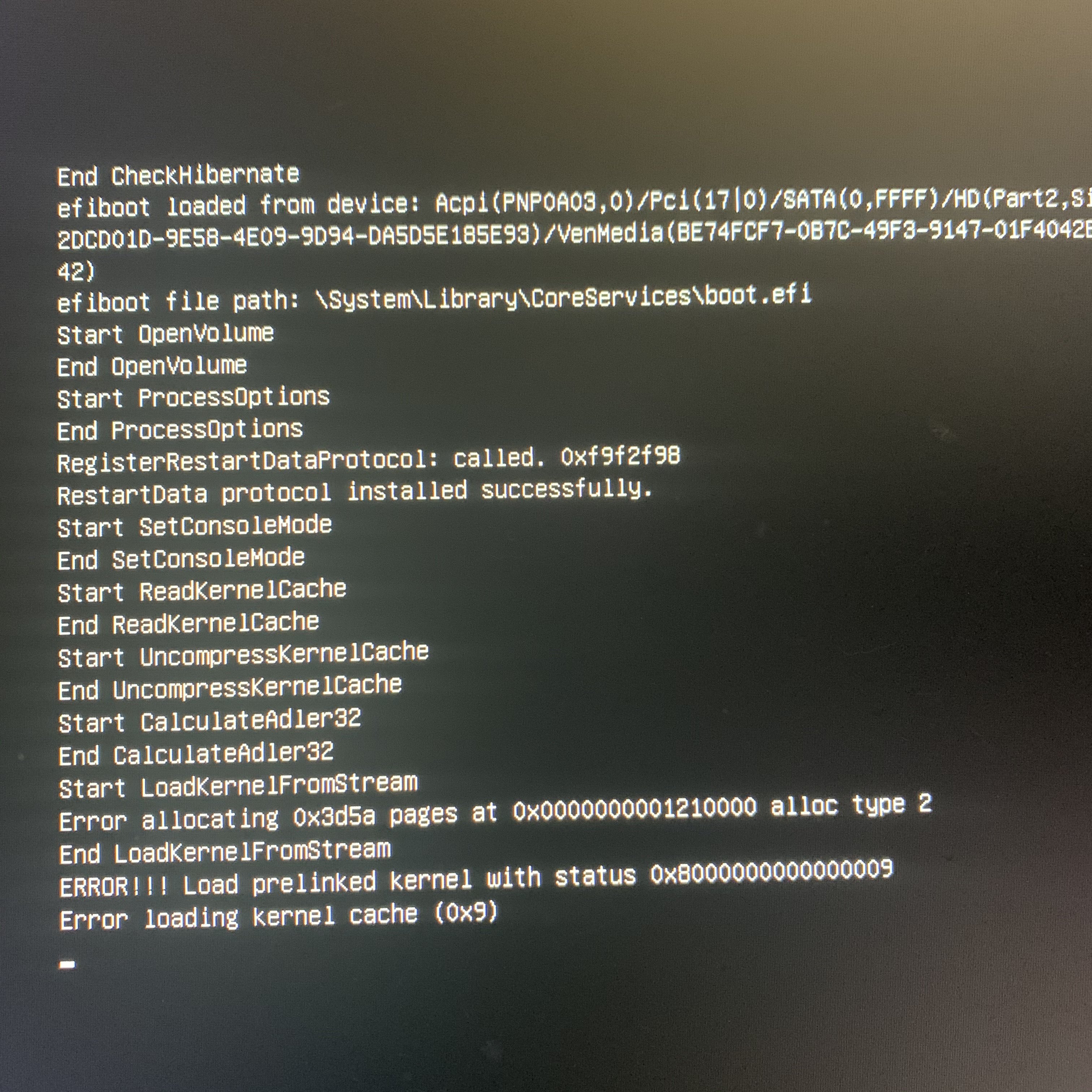

TorqueX86 Posted January 11, 2020 Share Posted January 11, 2020 Hi guys,I'm at my wit's end. I really need a hand here.I found only one clover setup for my motherboard, and works absolutely flawlessly for Mojave.Today I added an Asus Thunderbolt EX3 card, and that won't even let me boot my Mojave installation.My config.plist in attachment. Let's solve at least the Thunderbolt issue for now. There are also other issues, but let's solve this one first. Asus WS Z390 PRO + i9 9900K 32GB 3200 Nvidia 2080Ti for Windows and AMD RX480 for MacOS. Samsung NVME 950PRO config.plist Link to comment Share on other sites More sharing options...
TorqueX86 Posted January 11, 2020 Author Share Posted January 11, 2020 Before I installed the TB card the system was running Mojave 10.14.6 without a single glitch. It did have other issues, though: - Couldn't get Clover GUI to countdown and remember last booted volume - For the life of it it wouldn't let me update to Catalina Link to comment Share on other sites More sharing options...
TorqueX86 Posted January 11, 2020 Author Share Posted January 11, 2020 That's the output I get. Link to comment Share on other sites More sharing options...

NorthAmTrans Posted March 14, 2020 Share Posted March 14, 2020 this might be late but I noticed I needed to disable M.2 x4 mode to get in with a TB3 card. I believe this is specifically when using 2 m.2 drives. Also when I moved to Catalina I couldn't get in without using a SATA-Unsupported Kext. Link to comment Share on other sites More sharing options...
