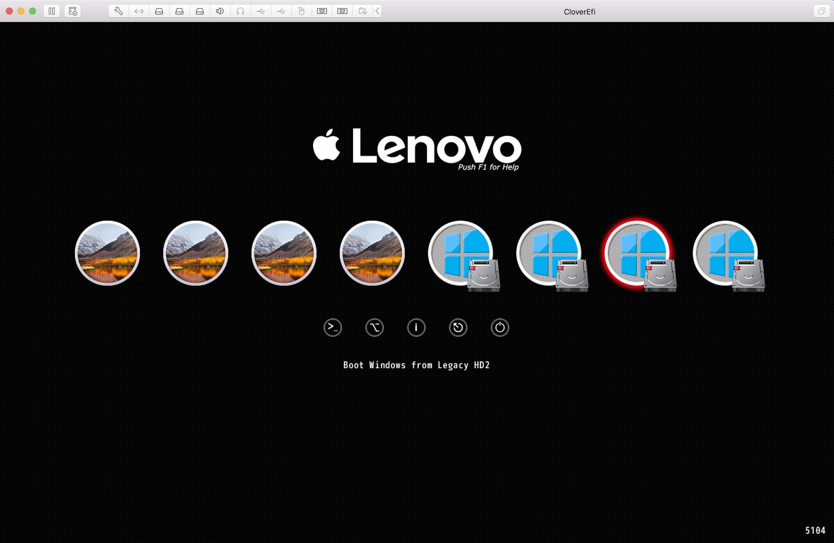

Jief_Machak Posted March 4, 2020 Author Share Posted March 4, 2020 I made some legacy entries. I add this at the end ScanVolumeBootcode : *Bootable = TRUE; Volume->HasBootCode = TRUE; Volume->LegacyOS->IconName = L"win"; Volume->LegacyOS->Name = L"Windows"; Volume->LegacyOS->Type = OSTYPE_WIN; Volume->BootType = BOOTING_BY_PBR; so I got "fake" legacy entries, and it's still working. Did you try a recompile from scratch. EDK build system is not great and it happened to me to have some old objects link with new code. Link to comment https://www.insanelymac.com/forum/topic/341986-c-proposition/page/13/#findComment-2711068 Share on other sites More sharing options...

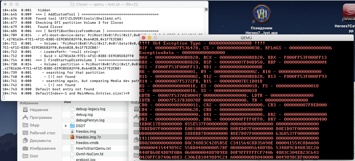

Slice Posted March 4, 2020 Share Posted March 4, 2020 49 minutes ago, Jief_Machak said: Anything in your config.plist that trigger the bug ? Could you send it to me ? Nothing interesting There is FreeDOS image that I can boot by legacy Clover. There is my config.plist. there is my command line to start QEMU qemu -L ~/Desktop/QEMU-Clover/QEMU -m 2048 -cpu core2duo -bios bios.bin -machine q35 -device ahci,id=ahi -drive format=raw,id=hda,file=/Users/sergey/Desktop/QEMU-Clover/QEMU-test2.img -drive format=raw,id=hdc,file=/Users/sergey/Desktop/QEMU-Clover/freedos.img -usb -device usb-mouse,bus=usb-bus.0,port=2 -device usb-kbd,bus=usb-bus.0,port=1 -serial stdio But main volume is too large to attach here. config.plist.zip freedos.img.7z The bug reproduced on three computers since yesterday evening up to now. Link to comment https://www.insanelymac.com/forum/topic/341986-c-proposition/page/13/#findComment-2711082 Share on other sites More sharing options...

Slice Posted March 4, 2020 Share Posted March 4, 2020 This is debug.log ended at MainMenu.run debug.log.zip Link to comment https://www.insanelymac.com/forum/topic/341986-c-proposition/page/13/#findComment-2711085 Share on other sites More sharing options...

Slice Posted March 4, 2020 Share Posted March 4, 2020 9 minutes ago, Jief_Machak said: https://wetransfer.com/ ? https://dropmefiles.com/VYQca There is old version. Replace here Clover with new version. Oh, this is my compilation CLOVERX64.efi.zip Link to comment https://www.insanelymac.com/forum/topic/341986-c-proposition/page/13/#findComment-2711087 Share on other sites More sharing options...
Slice Posted March 4, 2020 Share Posted March 4, 2020 Clean XCODE8 compilation from initial. Same crash. Commits before REFIT_MENU_ENTRY worked. Link to comment https://www.insanelymac.com/forum/topic/341986-c-proposition/page/13/#findComment-2711088 Share on other sites More sharing options...

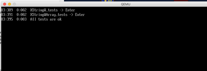

Jief_Machak Posted March 4, 2020 Author Share Posted March 4, 2020 do you see "All tests are ok"? Link to comment https://www.insanelymac.com/forum/topic/341986-c-proposition/page/13/#findComment-2711090 Share on other sites More sharing options...
Slice Posted March 4, 2020 Share Posted March 4, 2020 15 hours ago, Slice said: The crash is at if (MainEntry.getLEGACY_ENTRY()) { I am quite sure the crash is here not matter what compilation. Link to comment https://www.insanelymac.com/forum/topic/341986-c-proposition/page/13/#findComment-2711091 Share on other sites More sharing options...
Jief_Machak Posted March 4, 2020 Author Share Posted March 4, 2020 Try my compilation : CloverX64.efi Link to comment https://www.insanelymac.com/forum/topic/341986-c-proposition/page/13/#findComment-2711092 Share on other sites More sharing options...
