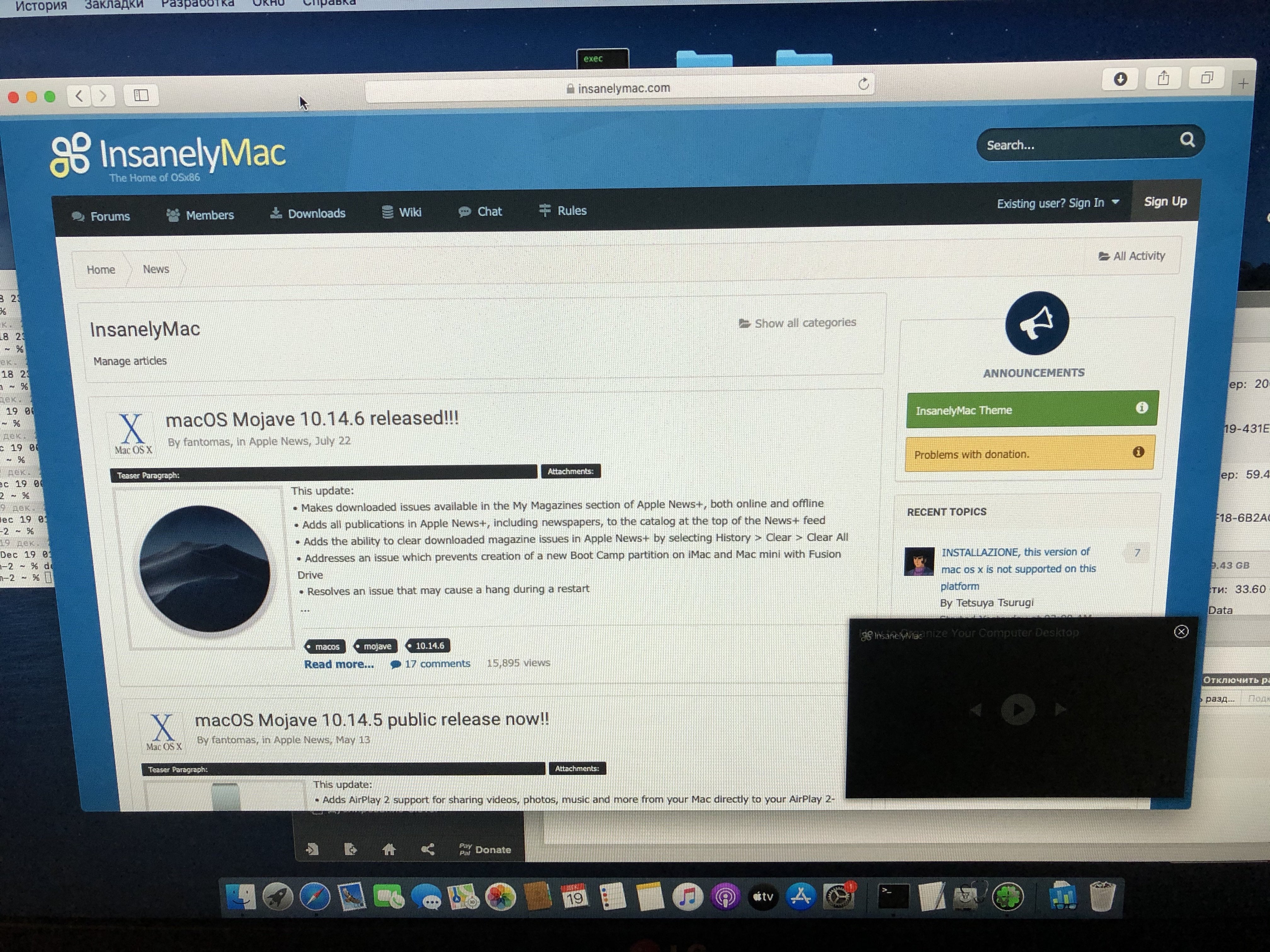

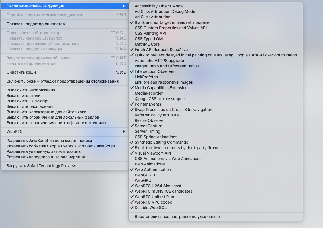

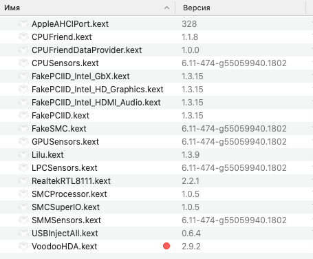

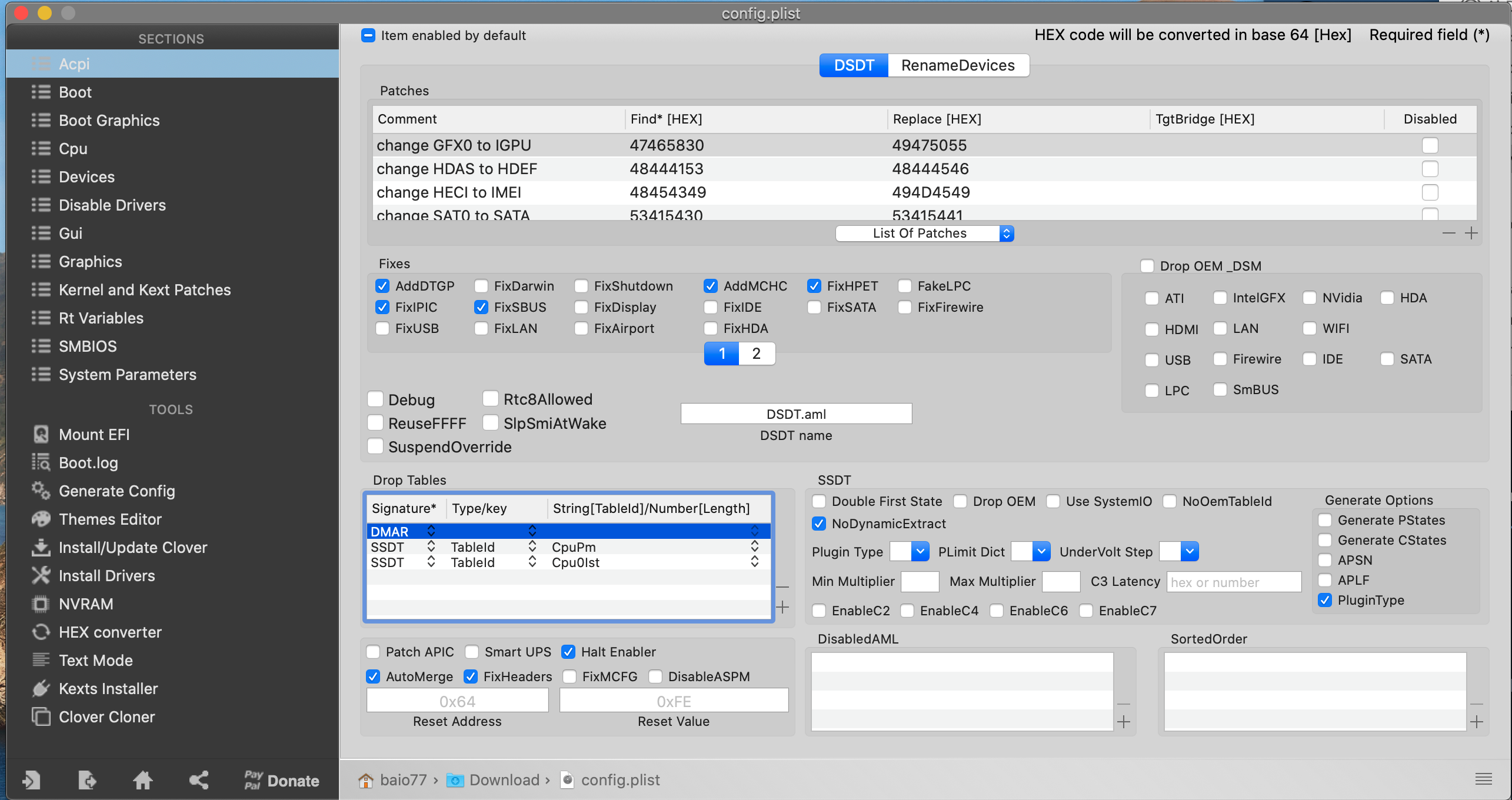

NEOSoftWare Posted December 18, 2019 Share Posted December 18, 2019 On the computer installed Catalina, iron: Asus H81T i7 4790K, video card processor HD 4600 The computer works fine, but it’s worth going to the insanelymac.com website from the safari, then the computer is hanging (there isn’t any reaction from the mouse and keyboard) I suspect that this is due to the use of the graphic accelerator of the safari browser, since the site itself loads and as soon as the video appears from the bottom right everything freezes, the same situation when starting the AppStore webgpu is disabled in safari properties Can the video card be configured incorrectly? In "About Mac" properties, the poppy shows HD 4600 1500mb list of kexts config.plist attached config.plist Link to comment https://www.insanelymac.com/forum/topic/341809-the-computer-freezes-when-you-enter-the-site-insanelymaccom/ Share on other sites More sharing options...

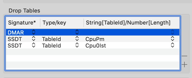

NEOSoftWare Posted December 19, 2019 Author Share Posted December 19, 2019 7 hours ago, Hervé said: Get rid of that old method relying on FakePCIID kext and associated PlugIns. Switch to Lilu + PlugIns (WEG, AppleALC). Revisit your Clover config (dropped table, CPU power management, adequate SMBIOS). Once you adjust your current setup to more appropriate settings, things should work better. I'm not very good at setting up Clover, could you comment on my questions? 1 remove kext FakePCIID_* - did I understand that correctly? 2 AppleALC - this is for sound, the sound is now started through voodooo, I still could not get AppleALC working, the wiki instruction did not help (https://github.com/acidanthera/AppleALC/wiki/Installation-and-usage) 3 PlugIn WEG - what is it? WhateverGreen.kext? 4 Clover config (dropped table) - can you tell me what needs to be added? ssdt.aml - I will generate for this processor 5 adequate SMBIOS - what's wrong with it? I disguised it as mac mini 2018 Link to comment https://www.insanelymac.com/forum/topic/341809-the-computer-freezes-when-you-enter-the-site-insanelymaccom/#findComment-2701091 Share on other sites More sharing options...
Baio77 Posted December 19, 2019 Share Posted December 19, 2019 (edited) read here https://github.com/acidanthera/WhateverGreen/blob/master/Manual/FAQ.IntelHD.en.md In your config plist Audio inject in Device Proprierties WEG = Whatevergreen Drop tables SmBios ok for your HW IMac 14.2 ,CPU 4xxx This rename\ SSDT\Drop Tables and fixes is good for you Edited December 19, 2019 by Baio77 1 Link to comment https://www.insanelymac.com/forum/topic/341809-the-computer-freezes-when-you-enter-the-site-insanelymaccom/#findComment-2701117 Share on other sites More sharing options...
NEOSoftWare Posted December 19, 2019 Author Share Posted December 19, 2019 10 hours ago, Baio77 said: read here https://github.com/acidanthera/WhateverGreen/blob/master/Manual/FAQ.IntelHD.en.md In your config plist Audio inject in Device Proprierties ......... thank you very much, it helped me Link to comment https://www.insanelymac.com/forum/topic/341809-the-computer-freezes-when-you-enter-the-site-insanelymaccom/#findComment-2701193 Share on other sites More sharing options...
