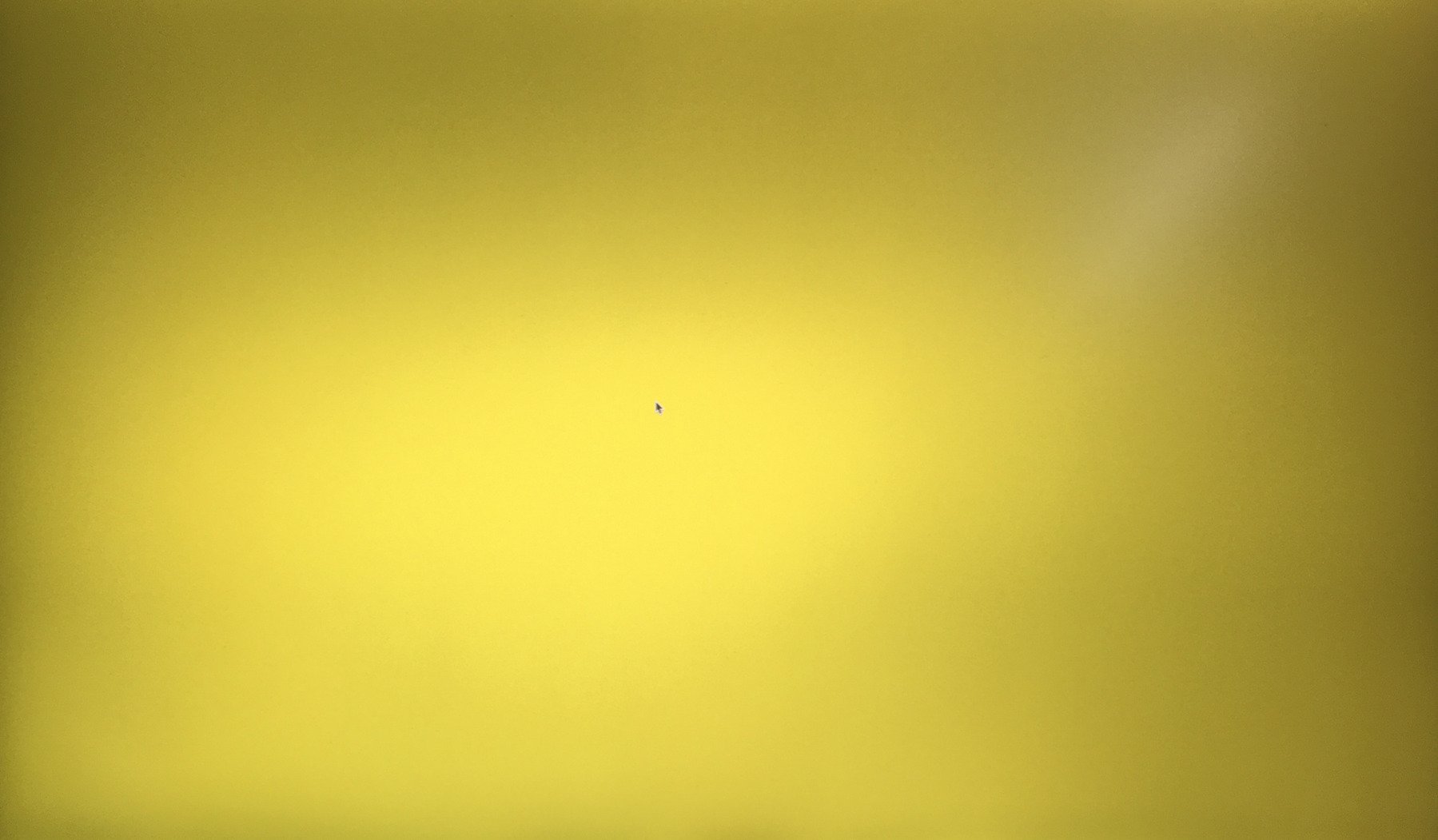

nmnmc Posted November 30, 2019 Share Posted November 30, 2019 (edited) Hey guys,my notebook model is dell precision 7510 with radeon w5170m graphic card,this card is like r9 m370x,cpu is 6820hq,I had disabled the switchable graphic card option in bios.Now I had completed mojave installation,but when boot into macos I got a yellow screen and moveable mouse point,I didn't see the start screen of macos,what the hell is this? And I can boot into recovery mode ,I can see anything that recovery mode shoud have. I installed whatevergreen ,In the clover config.plist ,I didn't set anything in graphic ,I didn't set fakeid,I didn't set special boot flag. Edited November 30, 2019 by nmnmc Link to comment https://www.insanelymac.com/forum/topic/341492-help-mobile-radeon-graphic-unormal/ Share on other sites More sharing options...
AkimoA Posted November 30, 2019 Share Posted November 30, 2019 What smbios did u go for ? And next ,i would check the device ID of the graphics card. You should be able to boot in safe mode ( -x ) ? Link to comment https://www.insanelymac.com/forum/topic/341492-help-mobile-radeon-graphic-unormal/#findComment-2699195 Share on other sites More sharing options...
nmnmc Posted November 30, 2019 Author Share Posted November 30, 2019 (edited) 48 minutes ago, AkimoA said: What smbios did u go for ? And next ,i would check the device ID of the graphics card. You should be able to boot in safe mode ( -x ) ? I seted smbios as MacBookPro13,3,and the device ID belong to this graphic card w5170m is 68201002. If I set -x boot flag ,I get black screen without mouse point after boot. And I had try set radeon deinit in clover configurator,but I got yellow screen with mouse point after boot. 48 minutes ago, AkimoA said: graphics Edited November 30, 2019 by nmnmc Link to comment https://www.insanelymac.com/forum/topic/341492-help-mobile-radeon-graphic-unormal/#findComment-2699197 Share on other sites More sharing options...
nmnmc Posted November 30, 2019 Author Share Posted November 30, 2019 (edited) On 11/30/2019 at 7:52 PM, AkimoA said: What smbios did u go for ? And next ,i would check the device ID of the graphics card. You should be able to boot in safe mode ( -x ) ? fixed this problem,see https://osxlatitude.com/forums/topic/11048-amd-radeon-hd-7750-supported-by-mac-os-mojave-catalina/. I have added radpg=15 to boot flag. But I get a now problem,no backlight control support,I didn't find helpful info about backlight control from https://github.com/acidanthera/WhateverGreen/blob/master/Manual/FAQ.Radeon.en.md . And the whole boot took 2 minutes ,too long . Edited December 2, 2019 by nmnmc Link to comment https://www.insanelymac.com/forum/topic/341492-help-mobile-radeon-graphic-unormal/#findComment-2699214 Share on other sites More sharing options...
