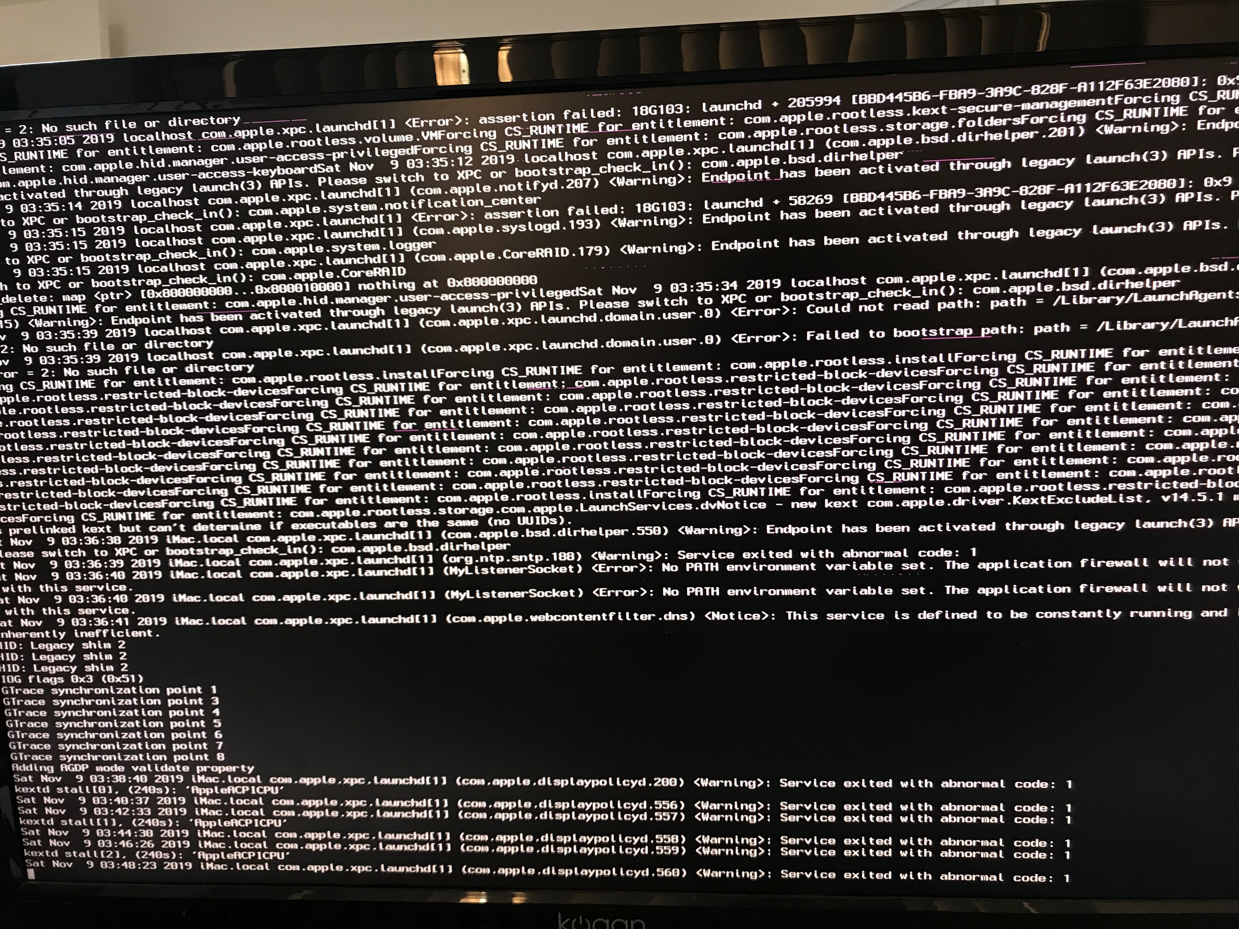

jbgillet Posted November 9, 2019 Share Posted November 9, 2019 (edited) Hi, I'm having real trouble getting Mojave installed on a clean drives. I've followed the vanilla guides here, I've even tried Tony with no luck. Most of the time I was unable to even get to the installer, it would either hand at the `End RandomSeed +++++++++++++++++` or I'd get a kernel panic before reaching the installer. Anyway I finally played around with the config until I was able to get it into loading the installer. I can now get all the way where the loading bar with the apple symbol gets to the end (takes about 20 mins), then the screen goes blank. I've uploaded my config.plist if anyone had any ideas. I've disabled iGPU in BIOS. Hardware: Core i7 8700 ASUS Prime Z370-A Radeon Sapphire RX570 8G (tried cable in Display port and HDMI) 32GB Corsair 3000Mhz Samsung 970 Evo M.2. SSD (blank) I've currently got the following Ktexts: AppleALC.kext FakeSMC_ACPISensors.kext FakeSMC_CPUSensors.kext FakeSMC_GPUSensors.kext FakeSMC_LPCSensors.kext FakeSMC.kext IntelMausiEthernet.kext Lilu.kext WhateverGreen.kext I can see this during a -v before it goes blank. config.plist Edited November 9, 2019 by jbgillet Link to comment Share on other sites More sharing options...
AkimoA Posted November 9, 2019 Share Posted November 9, 2019 Update Lilu and WEG ! Link to comment Share on other sites More sharing options...
jbgillet Posted November 10, 2019 Author Share Posted November 10, 2019 Thank you both, I updated WEG and Lilu and then changed to iMac19,2 And then removed the AICPUPM and KernelPm patches and removed using the nVidia drivers (I missed that before) And it's all up and running!!! Thank you!! Link to comment Share on other sites More sharing options...
