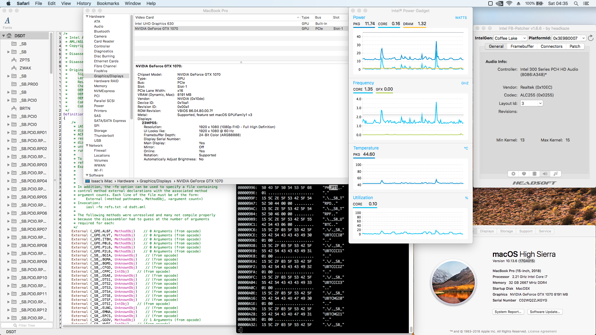

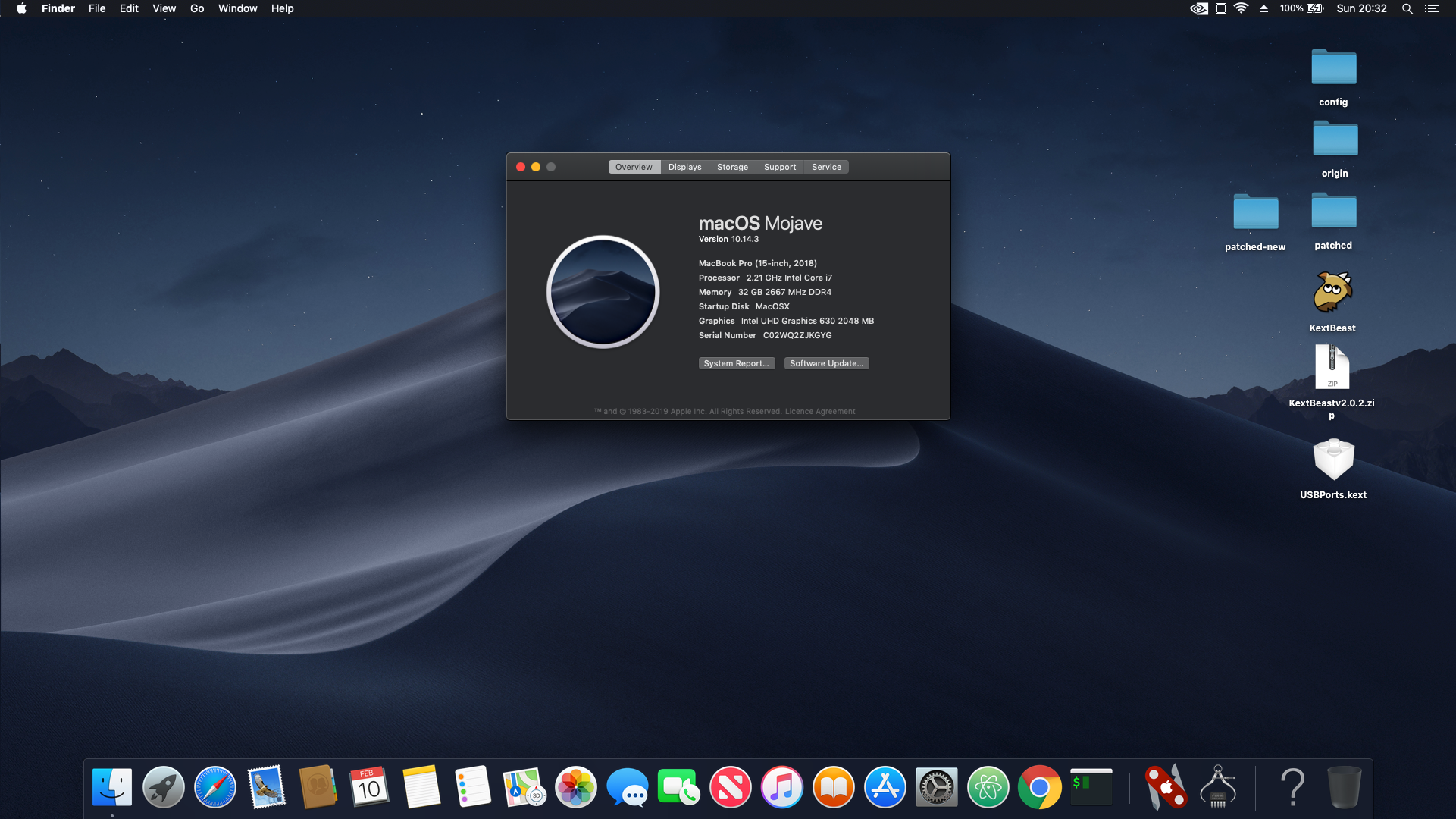

Screenshots:
Spoiler
High Sierra:
Mojave:
