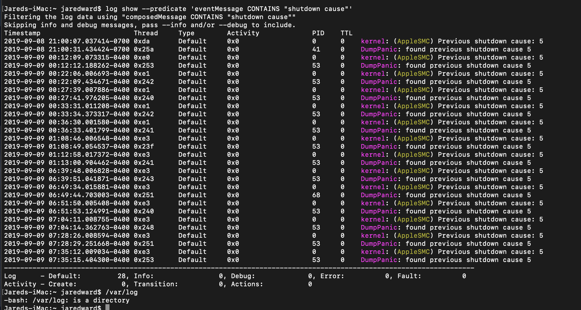

Jared Ward Posted September 9, 2019 Share Posted September 9, 2019 (edited) Hey guys, I'm really needing some help. I've successfully installed Mojave 10.14.6 and for some reason keep getting random shutdowns, even with the most minimal tasks. When I look up the shutdown log it's showing "Previous shutdown cause: 5" which means "correct shutdown" - makes zero sense to me. If anyone could help me I would greatly appreciate it. i7-8700K Gigabyte Z370 AORUS Ultra Gaming Sapphire Pulse RX 580 Samsung 960 EVO 500GB NVMeM.2 SSD Corsair Vengeance LPX 32GB DDR4 Memory Corsair CX Series 750 Watt Power Supply All of my parts are brand new, I would say under a year old. This is a clean install and the only thing plugged in is a mouse and keyboard. I've uploaded my config.plist and a screenshot (couldn't upload my EFI as it's too big). I'm literally about to throw in the towel on this build. Thanks so much config.plist Edited September 9, 2019 by Jared Ward Link has been removed. Please read the rules. Link to comment Share on other sites More sharing options...
