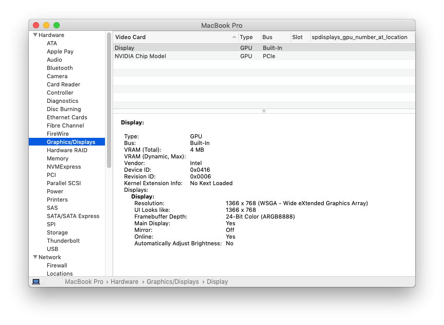

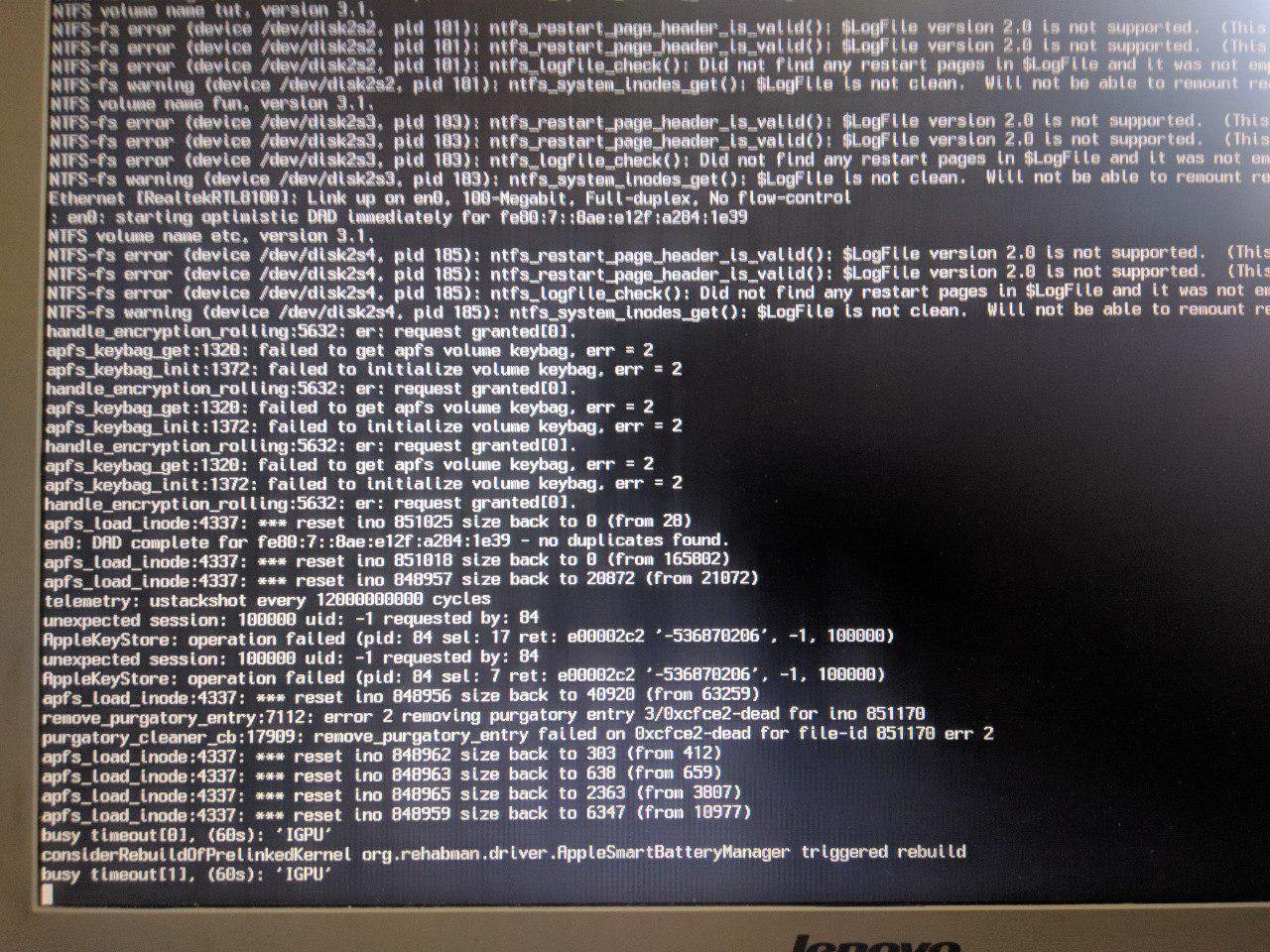

mahdir Posted August 24, 2019 Share Posted August 24, 2019 On Mojave 10.14.6, I've set 0x04128086 for Intel GFX and ig-platform-id: 0x0a260006, without enabling inject intel it shows 4mb on about mac and it doesn't have acceleration, But with enabling inject intel, it'd stick on boot showing the following errors in the picture attached. The clover and ioreg files are attached. Specs: Lenovo Z510 - b Core i7 4702 MQ Intel hd 4600 MacBook Pro_ioreg.zip CLOVER.zip Link to comment https://www.insanelymac.com/forum/topic/340008-intel-hd-4600-graphic-problem-4mb-without-acceleration/ Share on other sites More sharing options...

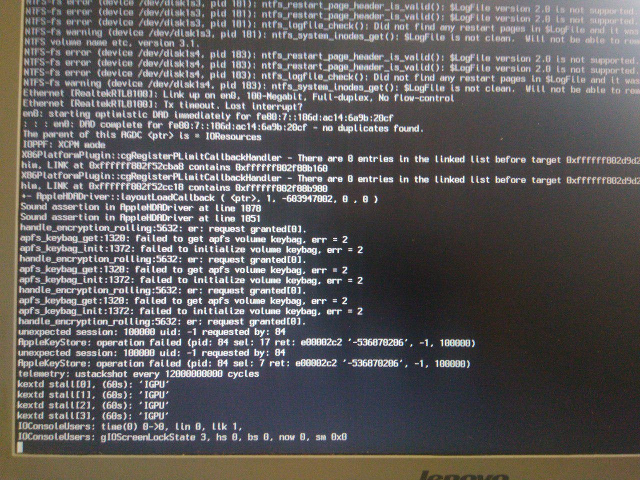

mahdir Posted August 24, 2019 Author Share Posted August 24, 2019 (edited) 20 minutes ago, iCanaro said: test please... replacement all EFI e CF: cross fingers archivio.zip Thanks so much, but unfortunately it's stuck on "kextd[n], (60s):'IGPU'" (and I enabled the second config (config-orig.plist) you put on the clover folder, it didn't detect intel hd graphics at all) Edited August 24, 2019 by mahdir Link to comment https://www.insanelymac.com/forum/topic/340008-intel-hd-4600-graphic-problem-4mb-without-acceleration/#findComment-2687148 Share on other sites More sharing options...

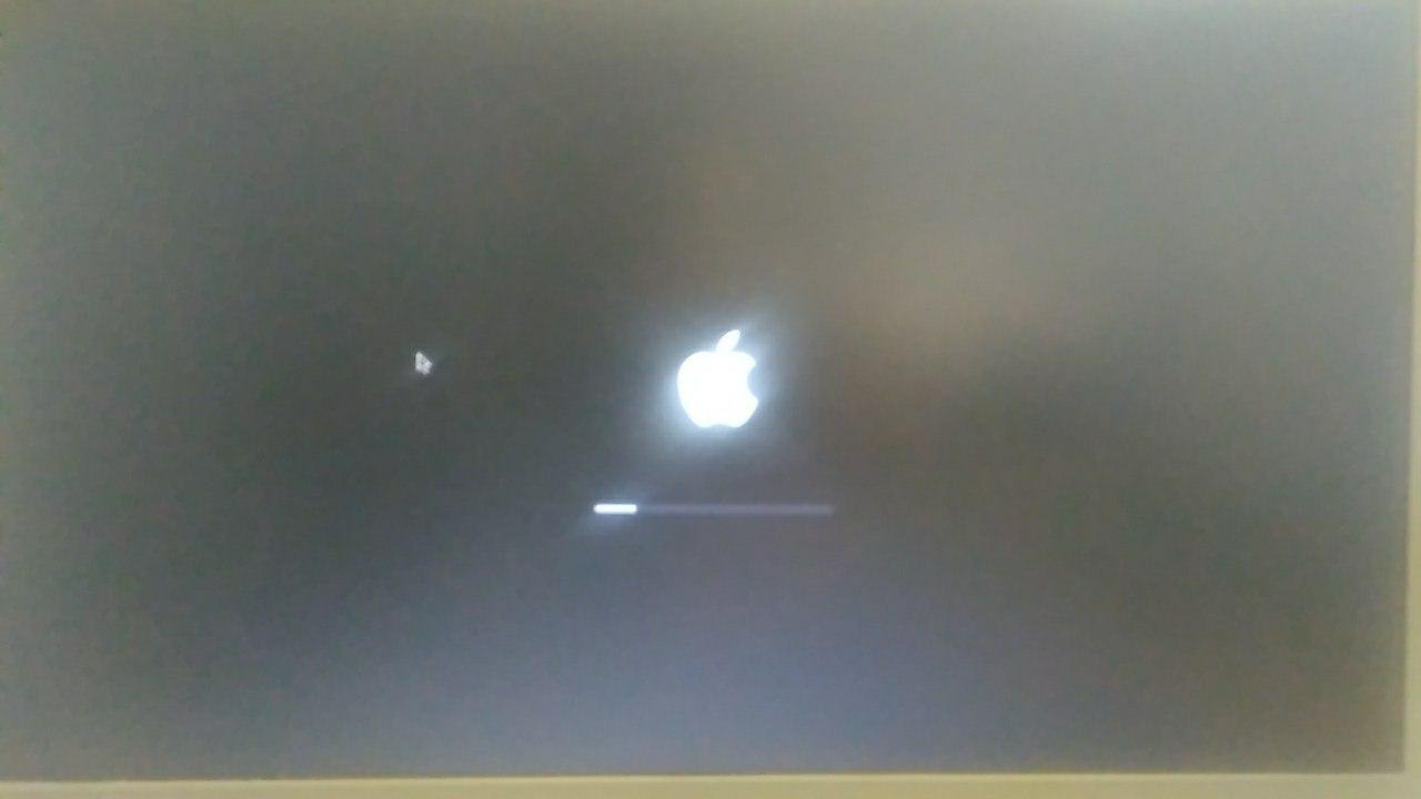

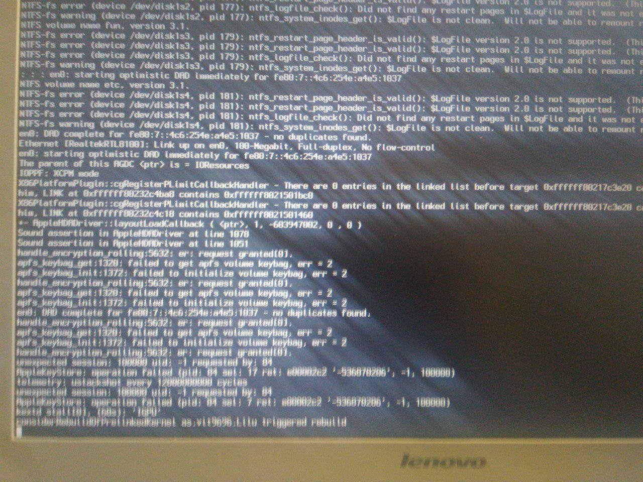

mahdir Posted August 24, 2019 Author Share Posted August 24, 2019 13 minutes ago, iCanaro said: installation must be vanilla, NO kexts L / E and S / L / E TEST Archivio.zip Thank you iCanaro for your time and help, Yeah, I didn't put and install any kexts in L/E and S/L/E For the first config (config.plist) This Error: For the second config (config-vesa.plist) it's stuck on the apple logo with mouse cursor: Link to comment https://www.insanelymac.com/forum/topic/340008-intel-hd-4600-graphic-problem-4mb-without-acceleration/#findComment-2687151 Share on other sites More sharing options...

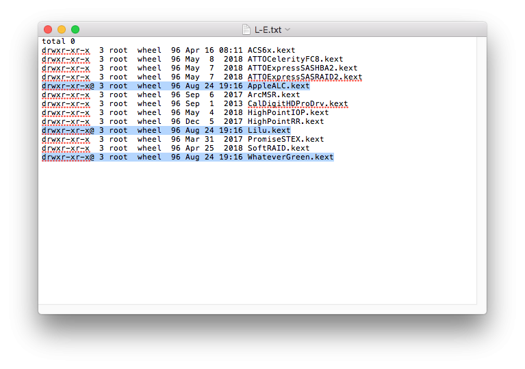

iCanaro Posted August 24, 2019 Share Posted August 24, 2019 (edited) delete the files highlighted in the screenshot, they must be allocated in EFI. Then, once the most up-to-date version of the KEXT has been deleted and put into EFI, the terminal is started sudo kextcache -i / Edited August 24, 2019 by iCanaro Link to comment https://www.insanelymac.com/forum/topic/340008-intel-hd-4600-graphic-problem-4mb-without-acceleration/#findComment-2687198 Share on other sites More sharing options...
