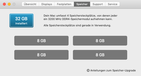

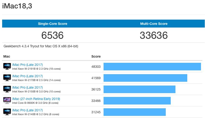

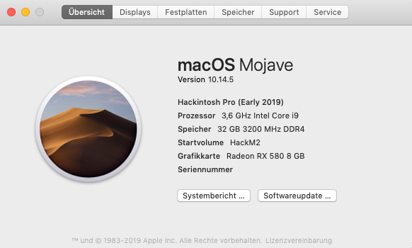

Hey everyone,
after years I come back to Hackintosh. In the early days I played with ozmosis and my good old 4700k. Now I'm back and worked around a 100% working setup with enough power to get me through all my tasks like audio, video cut etc.
In this short tutorial I will guide you through BIOS Settings and give you access to my EFI Folder. This I do because I haven't found anything on the web for my setup. Maybe it will help some of you. When you follow the steps you will have a perfect running Hackintosh ;) like I do have now :D

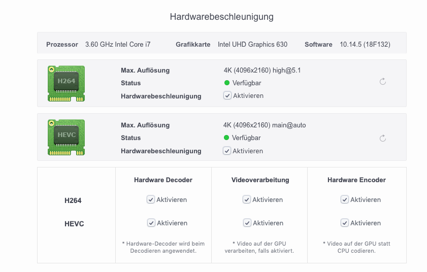

I've chosen the iMac 18,3 because of the easy integration of both Graphic Units and the support of HEVC.
Specs:
CPU: Intel i7 9700k (Overclocked in Bios to 4,7 GHz)
SMBIOS: iMac18,3 (Because of Dedicated Graphics and HEVC Intel Support)
RAM: 32GB G.Skill Trident Z RGB DDR4-3200 DIMM CL16 (XMP Profile to 3200MHz)
Motherboard: MSI MPG Z390 GAMING PRO CARBON (MS-7b17) <- It's the model without WLAN/Bluetooth
Graphic Card: Sapphire RX580 Nitro+
Bluetooth & WLAN: Broadcom Card in PCI Adapter
What is working:

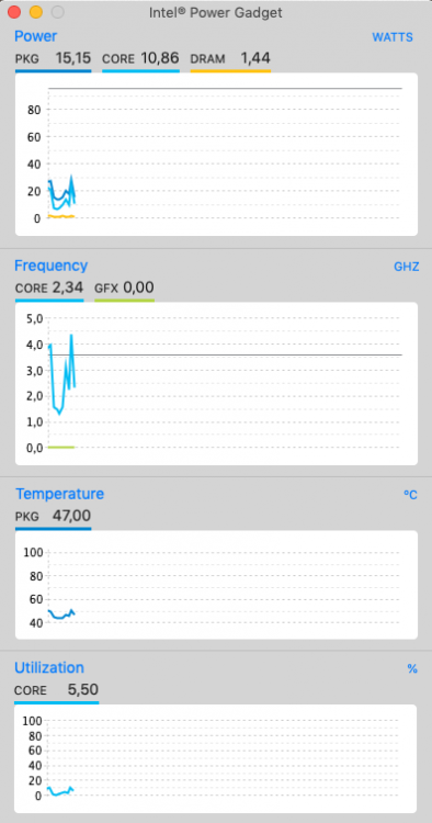

Almost everything! All USB Ports, Intel Power Management, Bluetooth, WLAN, LAN, Intel Graphics HEVC, Boot/Reboot, Sleep
What is not working:
Facetime & iMessage (Don't need it but I will come back to this)
Steps:
1. Create Mojave 10.14.5 USB Drive | https://www.youtube.com/watch?v=9CZDXxKfodE&amp;t=95s | Us this tutorial or search the forum
2. Load my EFI Folder: https://workupload.com/file/zkJ4zdQk

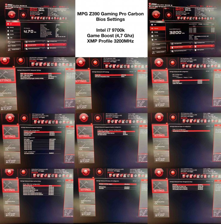

3. Go into your bios and use my settings in the Screenshot I attached
4. Boot from USB Stick | Install Mojave | Boot into Mojave (Check other Tutorials if you don't know how)
5. Generate Serials with Clover Configurator
6. Happy Hackintosh Life!

CPUFriend.kext | Perfect Power Management for my CPU
CPUFriendDataProvider.kext | Perfect Power Management for my CPU
