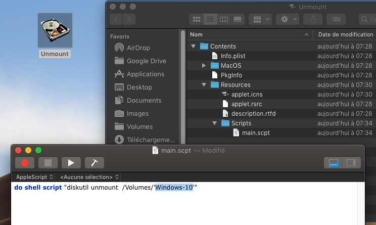

chris1111 Posted May 23, 2019 Share Posted May 23, 2019 (edited) My opinion is the best way is create a LaunchAgents with a simple app create with an Applescript On that way the Volumes will be Unmount at each Login Your only have to edit the name of the volume in the Applescript then Save Now put this app on your Applications Put the com.Unmount.plist on Root volume ➣ /Library/LaunchAgents Double click to Executable Agents (You can see the contant of the script, by opening with textedit) ⬇︎ #!/bin/bash # This is useful for loading launch daemons and agents. cd /Library/LaunchAgents sudo chown root:wheel com.Unmount.plist sudo chmod 644 com.Unmount.plist sudo launchctl load /Library/LaunchAgents/com.Unmount.plist exit 0 Attaching here the necessary files I just test right now and it work com.Unmount.plist.zip Executable Agents.zip Unmount.zip Edited May 23, 2019 by chris1111 Link to comment https://www.insanelymac.com/forum/topic/338897-hdd-keeps-spinning-up/#findComment-2674877 Share on other sites More sharing options...

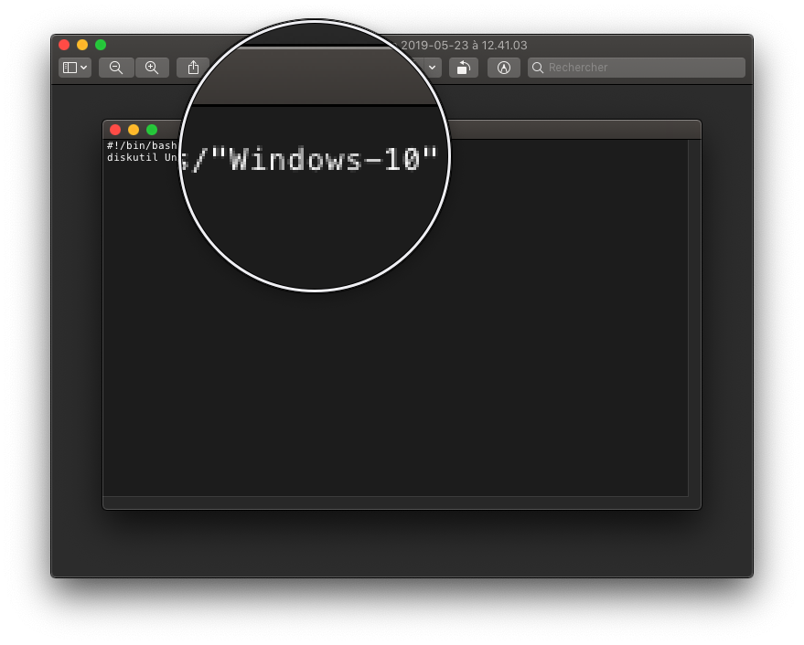

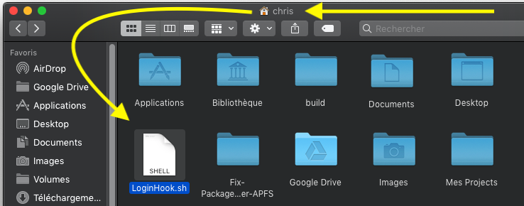

chris1111 Posted May 23, 2019 Share Posted May 23, 2019 (edited) Another easy way is to create a LoginHook Put the attaching script in Home Edit the script with the name of Windows volumes #!/bin/bash diskutil Unmount /Volumes/"Windows-10" Open the Terminal.app and Type this chmod +x ~/LoginHook.sh sudo mv ~/LoginHook.sh /usr/local/bin/LoginHook.sh sudo defaults write com.apple.loginwindow LoginHook /usr/local/bin/LoginHook.sh Reboot LoginHook.sh.zip Edited May 23, 2019 by chris1111 Link to comment https://www.insanelymac.com/forum/topic/338897-hdd-keeps-spinning-up/#findComment-2674900 Share on other sites More sharing options...

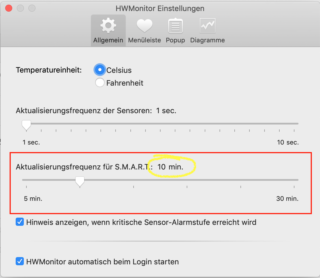

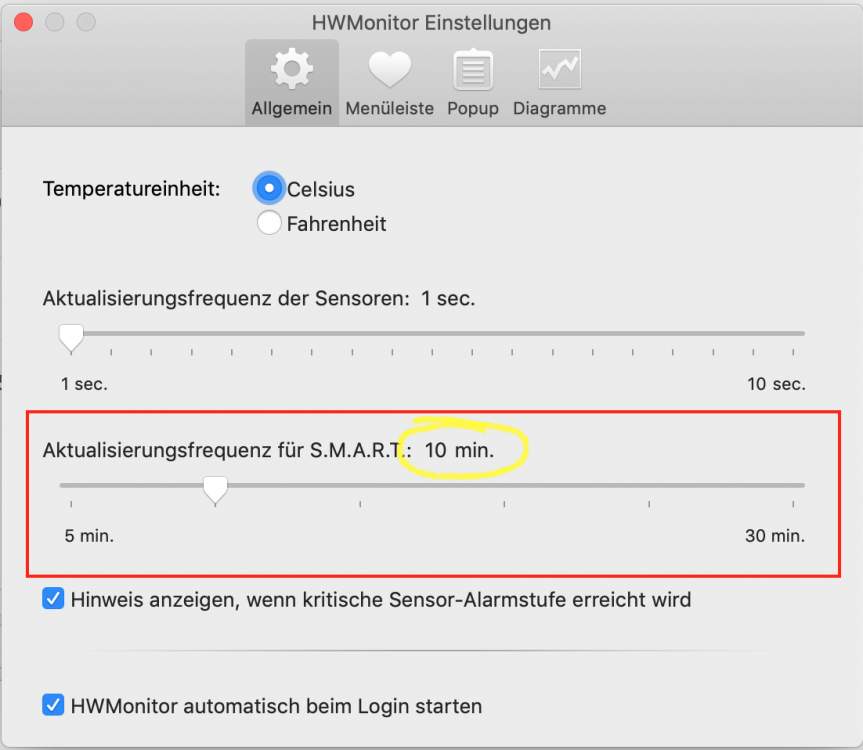

blxkspell Posted May 26, 2019 Author Share Posted May 26, 2019 I have found out what spins up my HDD all the time! It seems to be the HWMonitor app which is running all the time! The SMART check thing causes my problem as it was set to 10min. The max time is 30min which is quite better but still annoying. Is there a way to completely disable it? Link to comment https://www.insanelymac.com/forum/topic/338897-hdd-keeps-spinning-up/#findComment-2675138 Share on other sites More sharing options...
