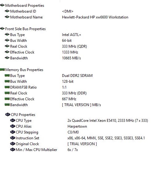

lopu Posted May 8, 2019 Share Posted May 8, 2019 hello mojave work on my vmware and parallels but don't on my pc after installed HP XW6600 Workstation Case - HP Motherboard Two (2) Intel Dual Core Xeon Processors at 2.33GHz each for Total of 4 Execution Cores ram ddr2 16gb nVidia g610 2GB bios legacy Link to comment Share on other sites More sharing options...
Rocky12 Posted May 8, 2019 Share Posted May 8, 2019 use this tool macOS Mojave Patcher Tool for Unsupported Macs Creat your USB Pin Drive with the of Mojave Patcher Install enjoy Link to comment Share on other sites More sharing options...
lopu Posted May 11, 2019 Author Share Posted May 11, 2019 (edited) On 5/8/2019 at 7:55 PM, Rockey12 said: use this tool macOS Mojave Patcher Tool for Unsupported Macs Creat your USB Pin Drive with the of Mojave Patcher Install enjoy don't fixed it On 5/8/2019 at 10:49 PM, Hervé said: There is no need to use the Mojave patcher for Unsupported Macs which replaces many files and this is poorly documented. You'd better stay away from that tool and build your USB installer using the usual direct method with the createinstallmedia command. If you have Xeon CPUs of the Core2Duo/Core2Quad generation (with SSE4.1 instructions set but no SSE4.2), you'll just need to replace the telemetry plugin by High Sierra's version to boot Mojave. This is documented in many many places and you can find details here for instance. Failing that, you'll only experience resets/reboots as you try to boot Mojave (booting the USB installer should be Ok though). Please specify your exact Xeon models and we'll be able to tell you what applies to your HP workstation. The full workstation specs would greatly help too, you know... Add those in your signature, like most of us; it's the recommended process. By "nVidia G610", I guess you meant GeForce GT610. This Fermi card was last supported in El Capitan 10.11. It's no longer supported from Sierra 10.12 and Mojave only supports nVidia Kepler cards. So, with Mojave, you'll have to replace your GT610 either by a Kepler card or a Metal-compatible AMD card. You can search this forum or Google for this. You may want to stick to High Sierra on this old beast. I have GeForce GT610 but it is 10.13 work good only sleep don't work and mouse when click any like that don't return normal I was put com.apple.telemetry.plugin to /System/Library/UserEventPlugins but mojave don't open my file EFI in attach file EFI CLOVER.zip Edited May 11, 2019 by lopu Link to comment Share on other sites More sharing options...
