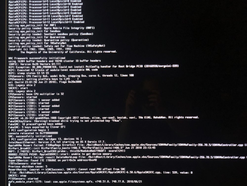

Lord Kamina Posted February 6, 2019 Share Posted February 6, 2019 (edited) I've been tasked with updating a hackintosh to Mojave (I originally built it but hadn't touched it since late 2017). It was acting up on a number of fronts so I updated the BIOS and went to work remaking the DSDT and SSDT patches from scratch but it seems I still broke something... I'm currently getting three errors that are preventing me from booting, not sure which of the three is actually the most relevant. First, during ACPI loading I get the following: ACPI Exception: AE_BAD_PARAMETER, Could not install PciConfig handler for Root Bridge PCI0 But loading seemingly continues without much issue. Then, I begin getting several AppleNVME asserts (I'm using a Samsung 960 EVO and it was working before) and then sometimes I also get an AppleUSBXHCI panic. Whether I get this last panic or not, the computer hangs. Any idea what might I be doing wrong? P.S. I know it's unorthodox but I've decided to drop all my OEM SSDTs and inject them back (I've gone through them all correcting compilation errors and warnings, as far as I could, as well as making sure to rename what needed renaming. I guess I might have added some stuff I didn't need?) acpi.zip config.plist.zip Edited February 6, 2019 by Lord Kamina Change topic to the likely actual issue Link to comment https://www.insanelymac.com/forum/topic/337525-applenvme-assert-failed-appleusbxhcistart-unable-to-get-device-memory/ Share on other sites More sharing options...

Lord Kamina Posted February 6, 2019 Author Share Posted February 6, 2019 (edited) Update: 1) The AE_EXCEPTION issue related to PciConfig also appears when I boot ubuntu without Clover so it's most likely not a product of my patches and a benign message. 2) I'm not getting the USB panic anymore, I think it might have been due to me trying to get cute and renaming the USB 3.1 ports (Not Intel) XHC2. 3) I'm now seeing a new error that looks like it takes the money, and I've updated the topic title to reflect this... the entire error message is: AppleNVME Assert failed: fIOMapRegs 000002.705297 PXSX@: AppleUSBXHCI::start: unable to get device memory EDIT: It seems the above was not quite correct. I booted using cpus=1 (does that even actually work anymore? seems like it does at least...) and the screen changed a bit; it seems that was a mashup of more than one error message. Edited February 6, 2019 by Lord Kamina wrong image Link to comment https://www.insanelymac.com/forum/topic/337525-applenvme-assert-failed-appleusbxhcistart-unable-to-get-device-memory/#findComment-2662961 Share on other sites More sharing options...
