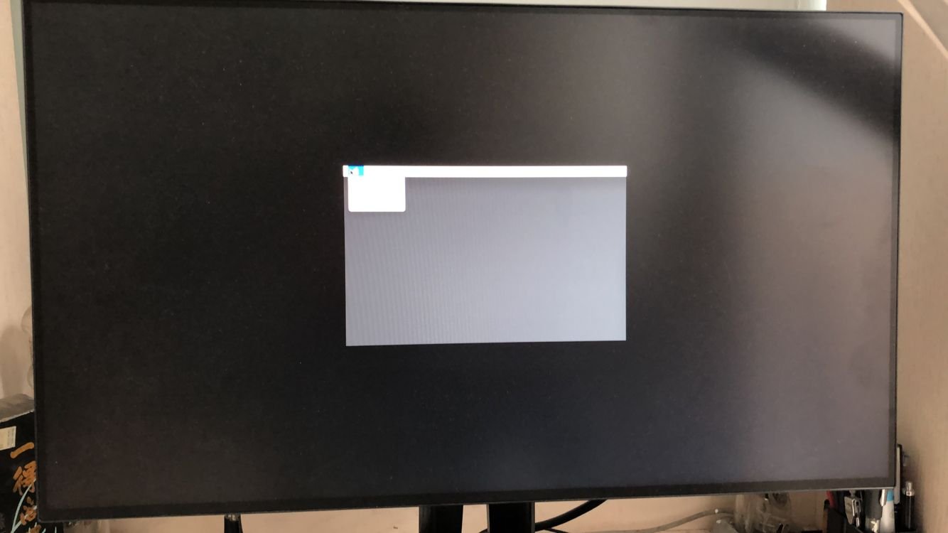

Archeb Posted February 3, 2019 Share Posted February 3, 2019 (edited) Spec: ASRock B85 Pro4 + E3 1230 V3 + 8GB RAM + Vega64 Clover v4859 with Lilu(v1.3.2), AppleALC(v1.3.5), WhateverGreen(v1.2.7) Monitor: ViewSonic VP2468 (1920*1080) The elements show in the normal size of 1920*1080 but only displayed in a small area. Edited February 3, 2019 by Archeb Link to comment https://www.insanelymac.com/forum/topic/337485-help-vega64-display-not-complete/ Share on other sites More sharing options...
jbrewer9811 Posted February 3, 2019 Share Posted February 3, 2019 I get the exact same thing... any ideas? Link to comment https://www.insanelymac.com/forum/topic/337485-help-vega64-display-not-complete/#findComment-2662607 Share on other sites More sharing options...
Gigamaxx Posted February 3, 2019 Share Posted February 3, 2019 How are you connected? DisplayPort, HDMI, DVI? have you tried calibrating using System Preferences/Displays/Color/Calibrate? Link to comment https://www.insanelymac.com/forum/topic/337485-help-vega64-display-not-complete/#findComment-2662615 Share on other sites More sharing options...
jbrewer9811 Posted February 3, 2019 Share Posted February 3, 2019 HDMI and you can't see anything on the screen except the tiny upper left corner to no way to change any settings. Computer is HP Z800 and GPU is Vega 64 Link to comment https://www.insanelymac.com/forum/topic/337485-help-vega64-display-not-complete/#findComment-2662642 Share on other sites More sharing options...
Gigamaxx Posted February 3, 2019 Share Posted February 3, 2019 Have you tried connecting to a different monitor or TV? Link to comment https://www.insanelymac.com/forum/topic/337485-help-vega64-display-not-complete/#findComment-2662656 Share on other sites More sharing options...
jbrewer9811 Posted February 4, 2019 Share Posted February 4, 2019 Yes. One 4K and one 1080p Link to comment https://www.insanelymac.com/forum/topic/337485-help-vega64-display-not-complete/#findComment-2662666 Share on other sites More sharing options...
Archeb Posted February 4, 2019 Author Share Posted February 4, 2019 Tried DisplayPort and HDMI but behave same. Link to comment https://www.insanelymac.com/forum/topic/337485-help-vega64-display-not-complete/#findComment-2662673 Share on other sites More sharing options...
Gigamaxx Posted February 4, 2019 Share Posted February 4, 2019 If you open your config.plist with Clover Configurator app and look at GUI section do you have a screen resolution setting. Link to comment https://www.insanelymac.com/forum/topic/337485-help-vega64-display-not-complete/#findComment-2662675 Share on other sites More sharing options...
Archeb Posted February 11, 2019 Author Share Posted February 11, 2019 (edited) On 2/4/2019 at 9:26 AM, jbrewer9811 said: Yes. One 4K and one 1080p Disable the CSM of the motherboard, problem solved! Edited February 11, 2019 by Archeb Link to comment https://www.insanelymac.com/forum/topic/337485-help-vega64-display-not-complete/#findComment-2663582 Share on other sites More sharing options...
